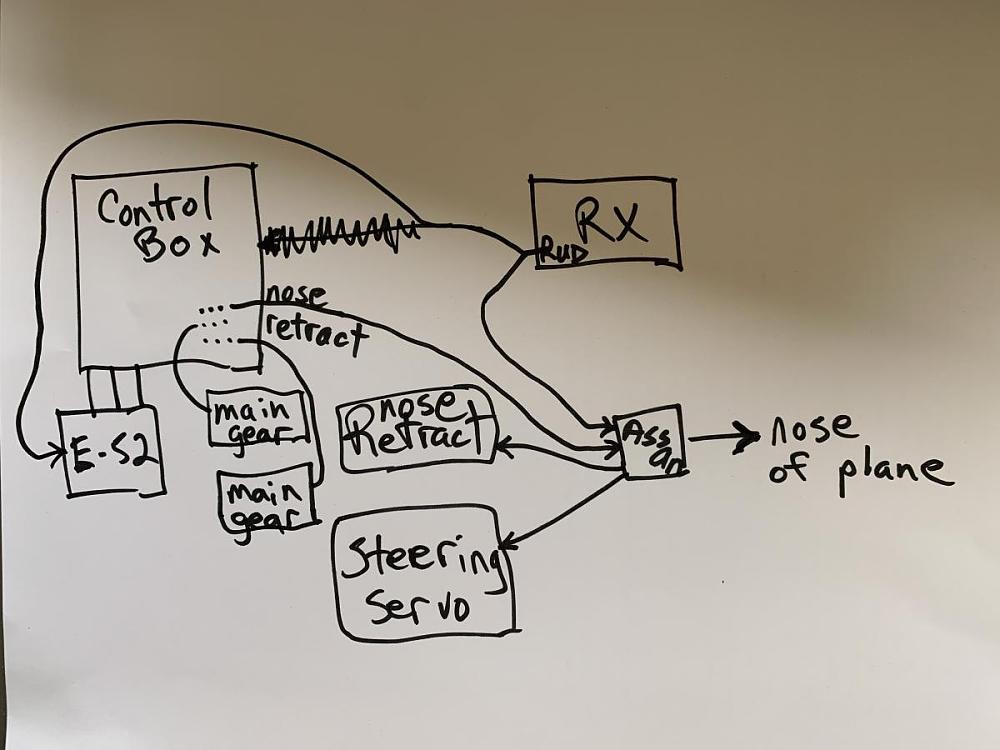

    Same for the steering servo cable. I plugged it into the Turning Servo plug on the gyro, and the Turning In male plug went into the spot where the steering servo plug had been. That's pretty simple, I thought it should have worked. But when I have things plugged in the way I THINK it should have been per the instructions. The nosewheel doesn't turn at all. Works fine when I have the gyro removed, though.

    The steering servo can't be signalled through the control box as it was stock. That servo needs to be commanded directly from the RX. What I believe is going on is that when the steering signal goes through the control box, it's being gyro compensated at 100% gain from the E52. Even though it's not helping with steering compensation, it's feeding a gyro controlled signal into another gyro (Assan). Hence, the need for a Y for the steering servo. Here's what needs to happen .............................
    RX rudder port to Assan. Assan steering out to steering servo. Retract.............................. Lead between front retract pins on control board to Assan. From Assan to front retract.

      Hi XViper: Could you draw a little sketch on how to plug in the Assan properly? I'm not quite following everything you are telling me to do. I ordered some Y harnesses, I can give this a try once they come in the mail. I do have a Spektrum AR637T receiver in my F-18, and I think it gives inputs to rudders as well, so I might try my A-4 or F-4 that do not have that equipment onboard.

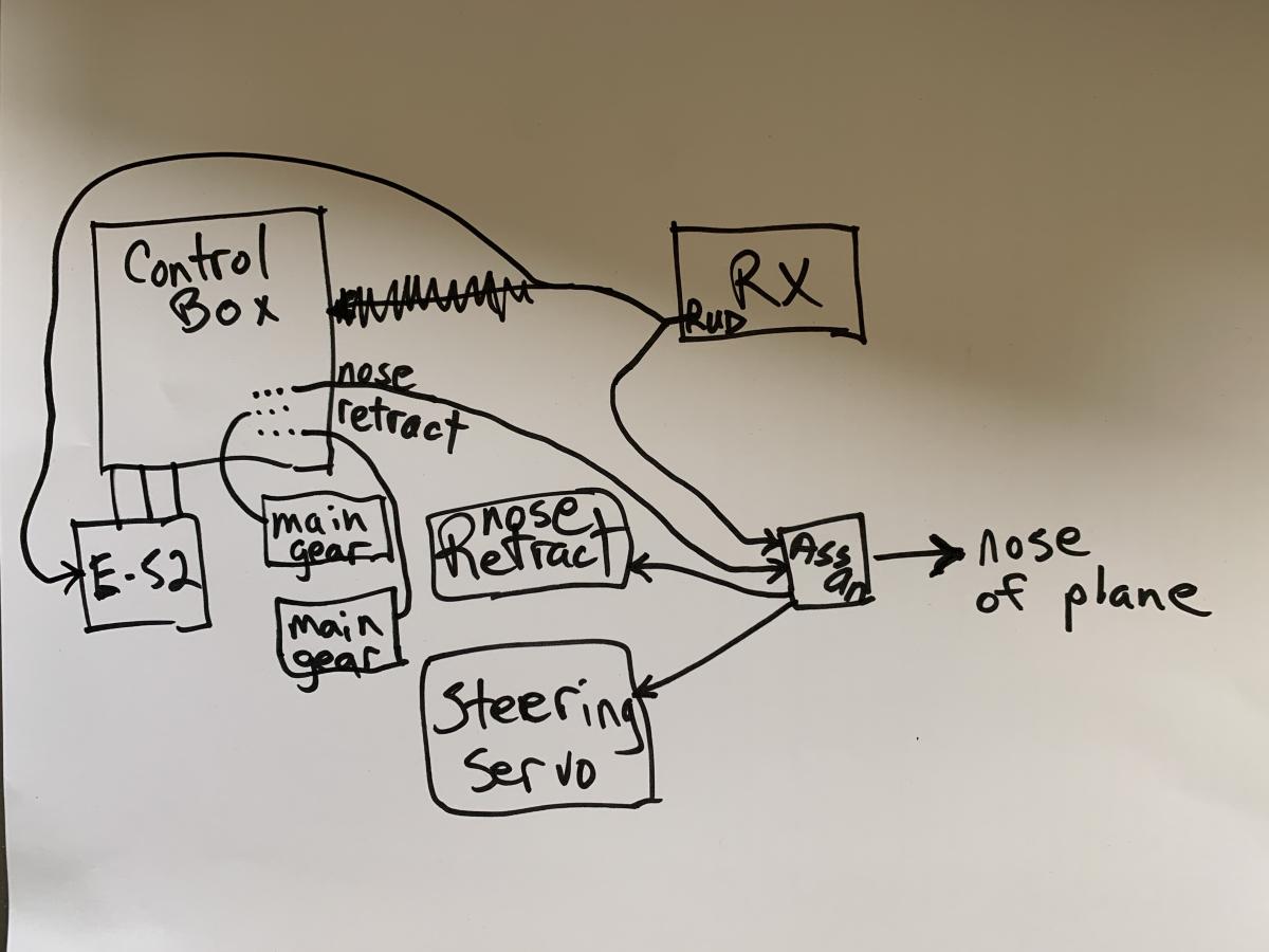

      • NOTE: I failed Art 101.
        As you can see, the steering servo no longer connects to the control box but goes directly to the Assan. The Assan gets the steering input directly from the RUD channel of the RX via a Y. The nose retract lead gets pulled out of the control box and hooks directly to the Assan. You then need a patch lead (or short extension) from the nose retract pins to the Assan.

        Drawing has been revised.
          Thanks, XVIPER! Once I get my Y cable hopefully next week sometime in the mail, I'll use this diagram to try and put the cables all in the right places! I'll keep you posted how it goes.

          • The receiver goes to the gyro and then to the control board…
            • Do the Y out of the receiver. One side to the Assan and the other to the male to male and into the gyro. The steering servo plugs into the Assan.
                Right. The line I drew from the RX to the control board (upper part of Y) should go to the E-52. That part shouldn't change. It's only a mistake in my drawing.

                  Just for the moment (until you get the Y), just don't plug in the lead that goes to the E-52 (upper part of Y). Only connect the lower part of the Y just to check everything out on the Assan and steering direction. Your air rudders (drag rudders just won't respond to rudder input. Once you get the Assan working correctly, you can go back and wait for the Y.
                  • The drawing in post #1123 has been revised.
                    • It should be self evident but having one gyro (E52) feeding another (Assan) (or vice versa) is not going to be successful in any context.
