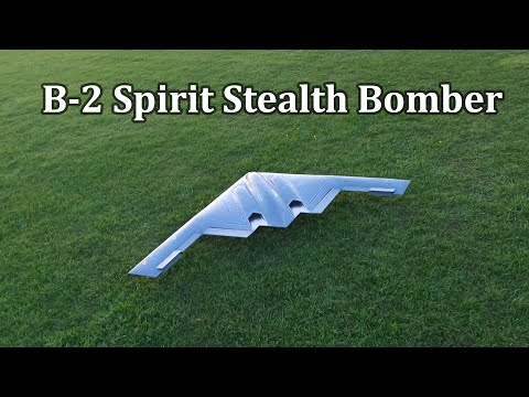

              SAFE AS3X Assan nose gyro and changed wheels for grass runway

                You did a excellent job on resolving the issue and now it is grass ops ready.

                  I have the Assan in mine and it virtually cures the ground handling. However, I'm curious about your Safe select receiver. Which one did you use, what kind of gains on each axis do you employ and did you do anything in regards to linking the drag rudders to the ailerons for banking?

                    I'm sorry, I still see issues. The bounce on take off, the hot landings, too pitchy.
                    Hats off to those of you still flying the B-2!

                        Yeah the Assan nose gyro was a must for the grass field, very impressed with the performance ended up ordering the 5 pack from RCC. The SAFE/AS3X works as it should, angle limits and self leveling well, I have it on a three position switch SAFE/AS3X, AS3X only and everything off. Using the AR637T, I left the radio in the hangar but I will share the gains soon, I should be able to find time to fly this weekend. All the mixing is done by the board that is already in the B2 so no need to do anything different about the rudder and ailerons.

                          Yeah she is certainly super loose on take offs, hits a bump and wants go flying on her own. Will trim out a bit of the 8mm-4mm recommended reflex to see if she can handle the bumps better on take off. The original goal was to make her take off from grass and be able to fully close the gear doors, the extra aggressive AOA really made a difference, maybe it was too much. The first hot approach was all my fault, you need to let her glide in and settle herself down, probably the most substantial ground effect out of all the planes I have flown. She has a few issues but I am not sure what the expectations were, it was not the first B2 model ever made and I never expected her to be the best behaved.
