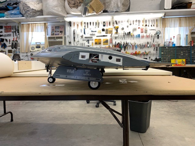

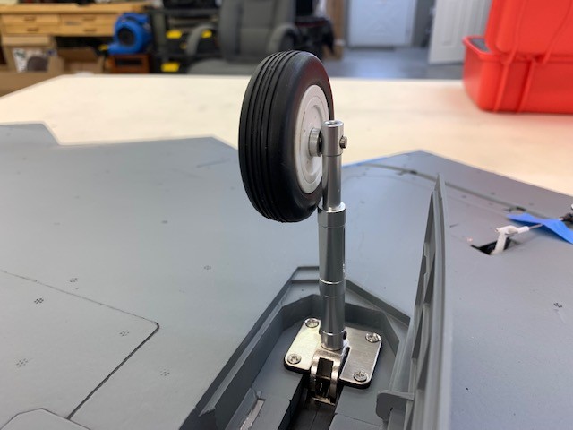

            Here are some photos of the grass mods I made to my B-2 last week.
            Stinger 90 struts with 60mm wheels on the mains worked well. Stock 45mm wheels are still on the nose. This seemed to work well on my last take off attempt before the jet flipped. The jet now has a 4.5 degree positive pitch angle on the ground which should be good for take off.

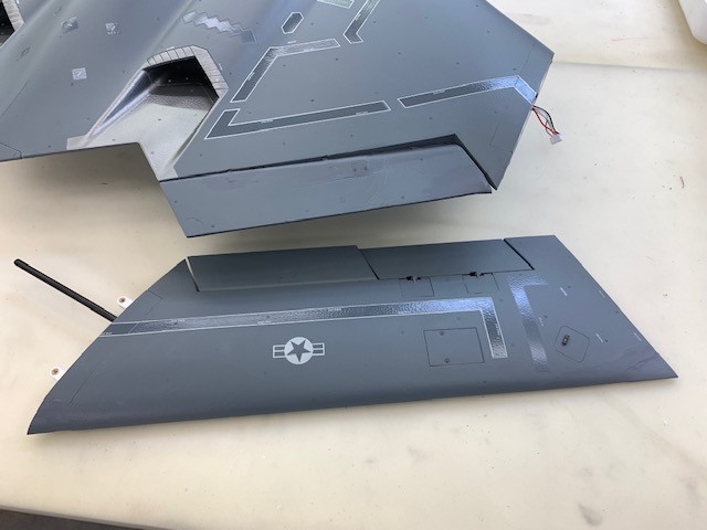

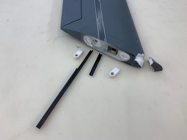

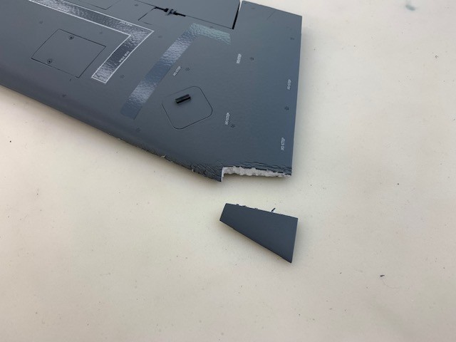

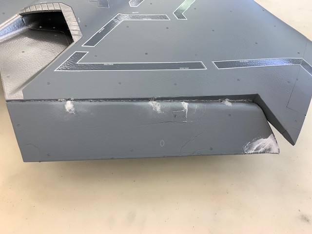

              Minor repairs made to the left wing and right elevator. The screw tabs and carbon rod were broken off. I used the polyurethane glue with CA technique mentioned by Mshagg. The 8mm carbon tube was replaced from the shop scrap box. The leading edge corners were glued back on with foam glue. The right elevator was torn off but the plastic hinge pins were not broken so I just glued then back in with foam glue. The foam hinge seal was replace with Blend Derm tape on the bottom. After touch up paint I added an ASSAN AG63 heading gyro to the steering. I had it in the shop planned for a new project so I put it to use in the B-2 for now. It checked out dead straight on taxi tests in the yard. Waiting for winds to calm a little to give it another go.

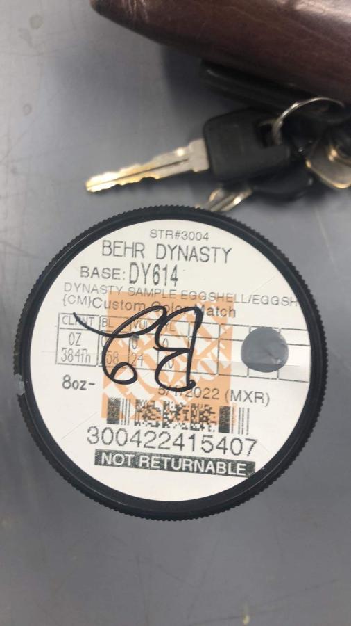

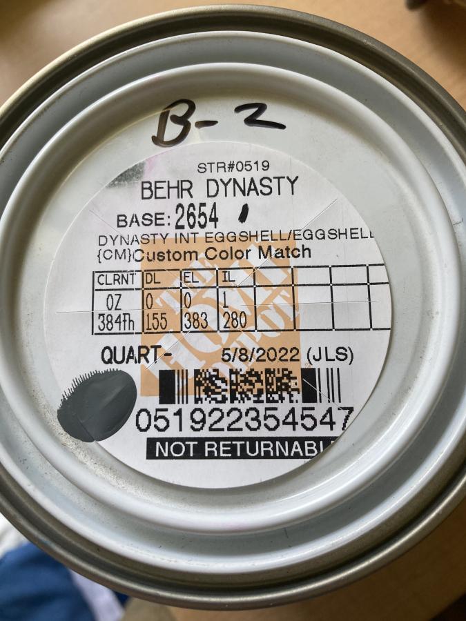

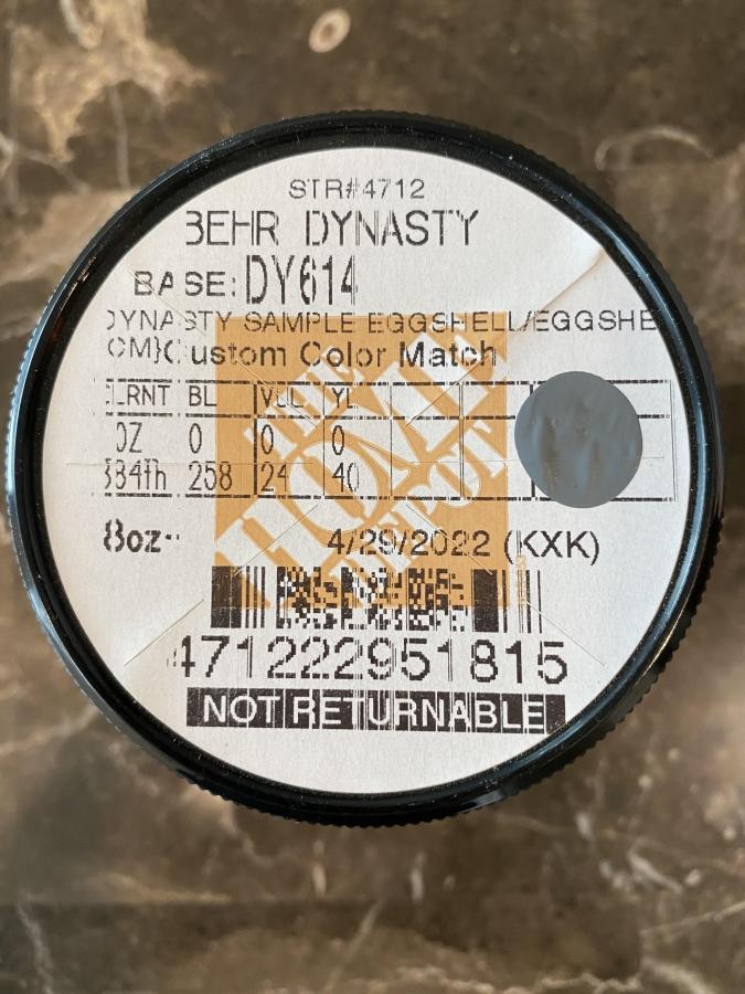

                In case anybody in interested here are three photos of HD touch up paint from three different stores in three different states. All the numbers match from each one. The one on the left is the one they scanned and made for me.

                  I concur with the accuracy of HD's touchup paints for our models. I used to live in the Denver area and used them all the time. Now, I live in NW WY and the closest HD is in Billings, about 1 1/2 hours away. Not a problem for that, but I just used a Sherwin Williams store for the first time here in Cody. I was amazed to see that they did a color match with the sophisticated little computer paint reader onto my B-2 wing extension, and then he played the actual wing color to what he had come up with a couple of times until the computer said they were an EXACT match! Never had such attention to detail before for a color match for me. The local Ace Hardware in town tries, but their match was way off from the real B-2 color, basically unusable for a model.
                  I'll still use HD from time to time if I happen to be in Billings. but I'm really sold on Sherwin Williams. For anyone out there who lives in a small town with no HD nearby, if you are close to a Sherwin Williams, I'd give that a go. Of course, part of the success is the diligence of the person doing the color matches, and his desire to get an absolute "dead nuts on" match.

                      I confirm that these numbers are dead accurate and the same as mine. I had my paint match done at Home Depot last week and I was floored with the accuracy. I just finished my touch ups yesterday and I can't even see where they were anymore. Incredible match in any lighting condition.

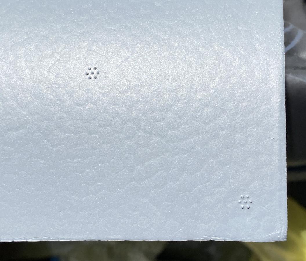

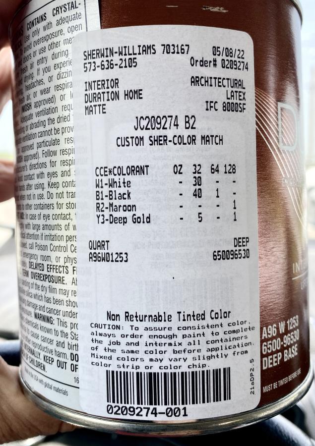

                          Following your recommendation I went to the Sherwin-Williams store and the very sweet, cute, young lady behind the counter took extra care to make sure the paint matched exactly. She even recommended the matte finish over the flat since there is some slight sheen to the model. She even wanted to see photos of it after seeing the battery hatch part I took to the store. 😳
                          I’m attaching a photo of the code she came up with and a photo of the battery hatch cover where she painted the lower-right corner with the paint she mixed.

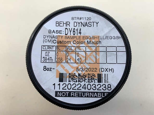

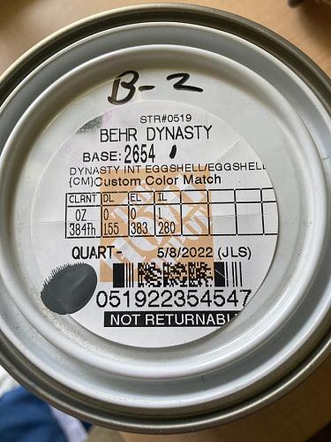

                            Another paint data point. Went to HD to get mine. The guy entered the info shown in the prior posts.
                            Came up with a different sticker. He assured me it was an exact match.
                            Got home….tried it out on a wing tip…perfect match and sheen. See below in case you run across this.

                              Good Deal, Mud Duck! I'm sure there are other folks around the country who aren't close to a HD, but might possibly have a Sherwin Williams store in town. We had our house exterior painted last summer with SW paints, and I could tell just looking at them in the can they were first-rate. We're very happy with the results, and I'll use our little SW paint store in town for my next model repaint. For those times we travel to Billings, I'll bring a sample of the plane to HD to have them do the match.
                              Thanks for your story. Glad everything turned out great!
