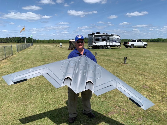

          Disappointing B-2 performance in grass today.
          I removed the steering from rudder board pins to a separate channel as I always have done for rate and trim control. This was a mistake as the first several attempts were uncontrollable after the first steering correction input. This resulted in uncontrollable 90 degree direction changes and aborts.
          Steering was reconnected to the rudder board pin where I discovered steering is gyro stabilized with very high gain, I suspect 100% on Yaw. The next several attempts were controllable and made straight runs. However, there was too much drag from wheels on the grass runway and or not enough thrust. The B-2 would accelerate to its max speed and stop accelerating. This speed was not enough to get rotation and airborne.
          My next step will be to find a way to reduce wheel drag, hopefully by finding an easy strut and wheel replacement for the mains, ideally with one large wheel. Maybe a larger nose wheel would help also and provide some positive pitch attitude on the ground.
          The other option is to make more thrust.
          Suggestion welcome.

              Seems I have seen conflicting info on here as to if the gyro controls the nose steering on the b2……so has anyone confirmed if does or not….
              I have mine on separate channel but with the wind i have not been able to test….

                                        I can confirm that the steering is controlled by the yaw gyro axis and highly advise keeping it connected to the steering pin on the mixing board. I removed mine to a separate channel at first and was completely unable control the take off track after the first steering correction in either direction. This usually happened at higher speed and resulted in 90 degree direction change and aborted TO. After I reconnected the steering back to the mixing board it was very easy to keep the take off run straight even is a slight crosswind.
                                        It is easy to check. Just power up the jet and verify a solid red light on the gyro. Then pick up the jet and move it back and forth in yaw directions and watch the corrections on the nose wheel and drag rudders.
                                        Gary
