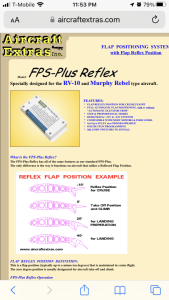

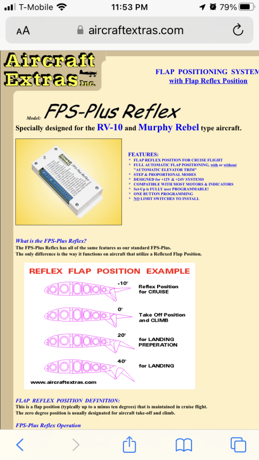

      Here’s a company that builds a position control box for the RV-10 type aircraft. They use the term REFLEX for negative (up) control surface position.
      Good ‘nuff for me as are the other posts which define reflex as up control position. I won’t hesitate to use the term going forward to indicate “up”.
      Therefore, for the B-2…
      Setting the inner surfaces to 8 mm reflex and the outer (non-clamshell) surfaces to 4 mm reflex as a starting point for a maiden is a perfectly acceptable use of the term REFLEX…IMHO.

        #803
        -GG
        Click image for larger version Name:	79B66DC6-5D1D-48DC-8A79-38AA6DB1D846.png Views:	0 Size:	253.8 KB ID:	344179
        This is interesting. It’s the first time I’ve heard of this. I guess you just showed an old dog a new “trick”.

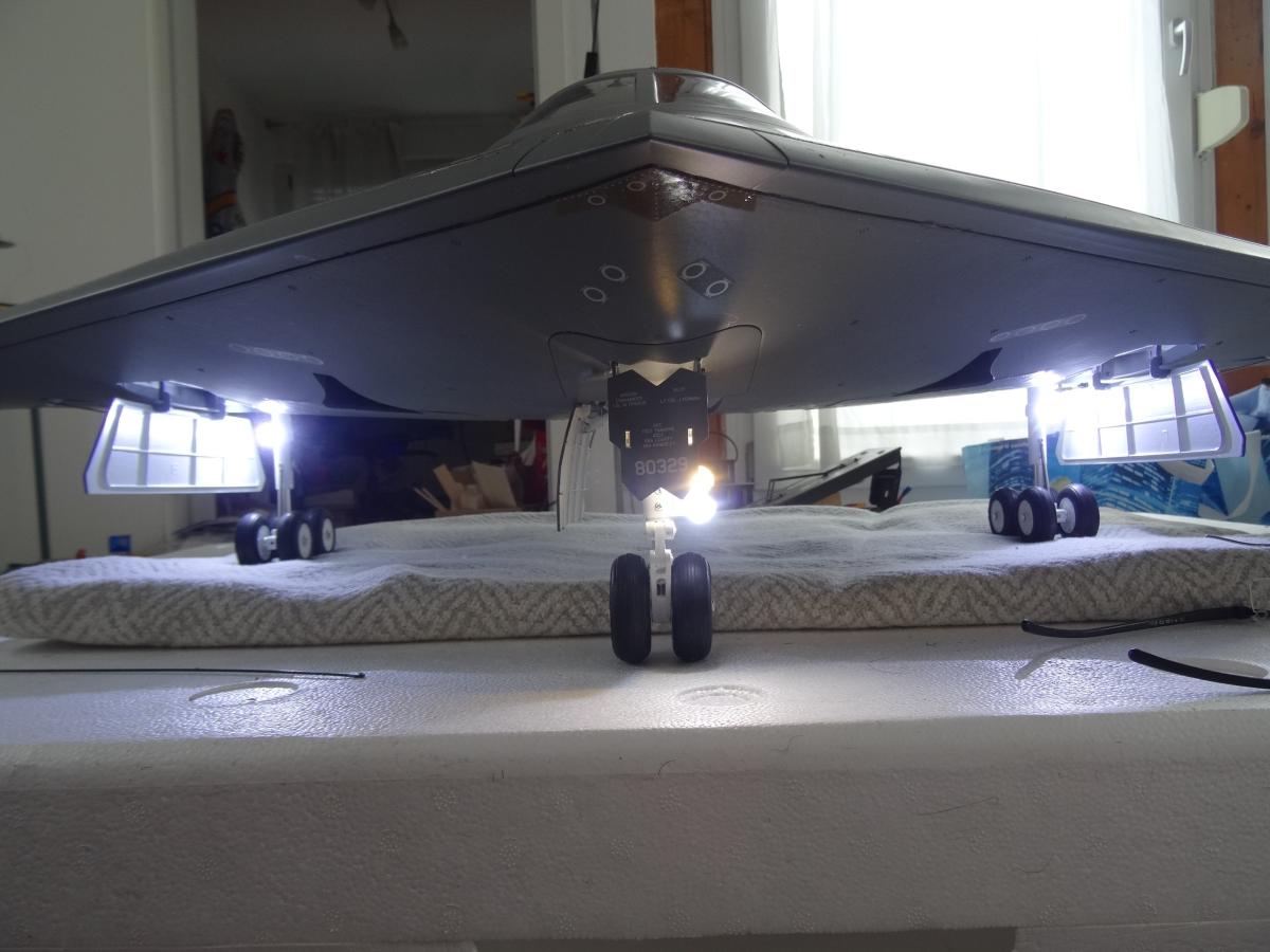

                      Originally posted by avanti127
                      Got the LED landing lights all hooked up and wired in...
                      Very good! More light = more sight!!! :-)
                      Here is mine with 3W coldwhite LED lights. Click image for larger version

                        • 5426
                            Can you please tell me where you got them, they look great, very realistic.

                                    #817
                                    Hi, these are normal 3W power LEDs "coldwhite", 3,4V -3,6V, 700mA, 200-220 LM from a local electronic shop. They have the same size as the stock LEDs from Freewing.

                                        #819
                                        Mine are the nose wheel LED landing light from the PJ. Screws right into the strut on the backside. comes with the little screw as well.
                                          I can't answer for him, but I've used a lot of these and they are very inexpensive:
                                          https://www.amazon.com/gp/product/B0...rch_asin_title
                                          https://www.amazon.com/6000K-6500K-6...188720-7042619
                                          and if you are willing to go with 1W LEDS (which are still plenty bright) you can get a lifetime supply at $0.13 each:
                                          https://www.amazon.com/dp/B07DPRWVRF...pa_dk_detail_0
                                          Here's what they look like on my Mirage
