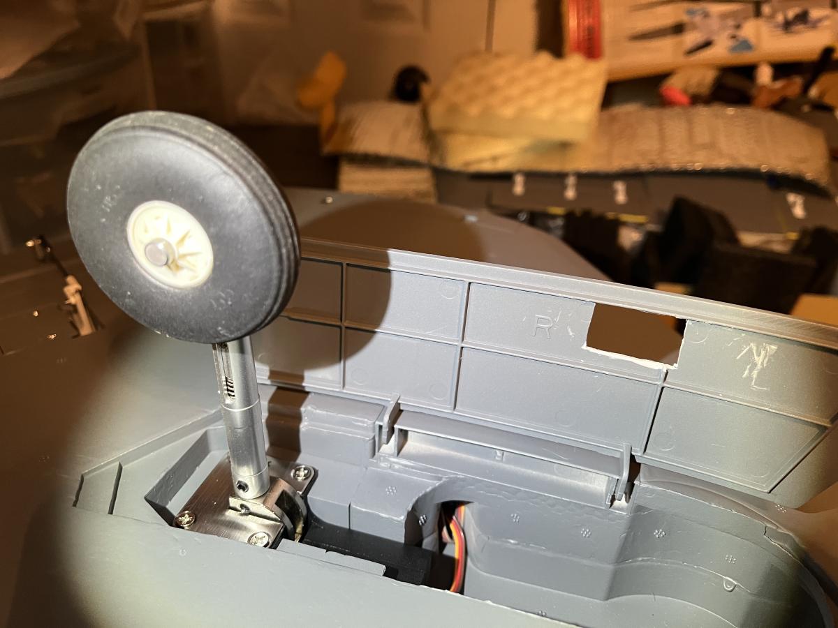

                        55mm wheels deployed on the Stinger 90mm main gear struts.....stuffed in some dense foam to provide a firmer spring and travel stop in the Oleo's. Went to a slightly larger nose wheel configuration also 55mm wheels. Did a taxi test on our grass runway (No take off in the 20-25mph winds).....ran up and down just fine no issue. Cut out relief slots in the gear doors to allow 100% closed position. All Clear!! Good for maiden on Friday
