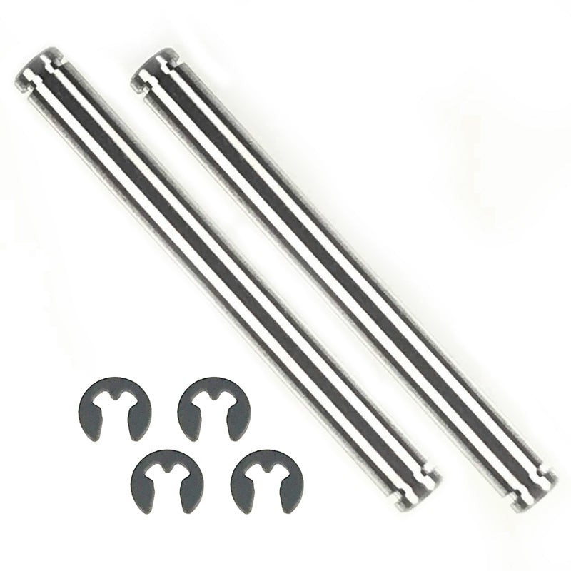

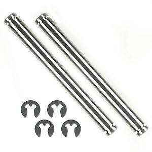

Name:	Hinge-Pin-With-E-Clips-800_a9a9e0c5-edc8-4f68-88b8-0bc6eca2dc42.jpg?v=1629911813.jpg
ID:	343945 While on the subject of tools, does anyone recommend a tool for removing those tiny E-clips found in trailing link landing gear legs, steerable retract pins, etc?

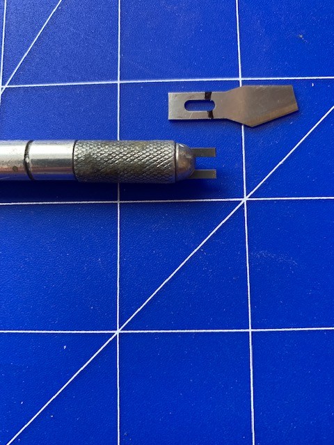

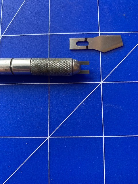

                      I recommend this simple tool, the clipped rear end of an X-Acto blade. A strong magnet nearby might help in catching the clip.
                      Click image for larger version  Name:	IMG_5309.JPG Views:	0 Size:	97.2 KB ID:	343947

                        #751
                        Great idea - thanks. Price is right too!
