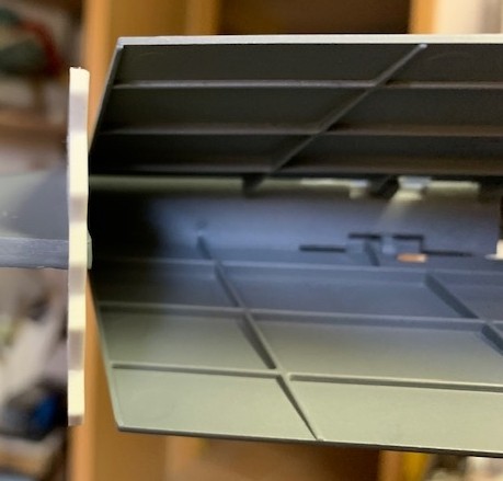

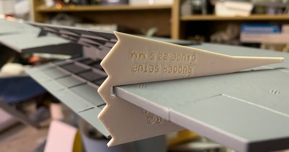

    Originally posted by Radar-Guy
    I didn't like the fiddling with rulers while setting up the control surfaces, so two gauges were created and printed. +/- 25mm for the rudders, 8mm Up trim for the inboard control surfaces measured at wing bottom. In case someone is interested in the STL files, I'll put them on cults3d. Just let me know.
Name:	Screenshot 2022-04-14 123205.jpg
ID:	342949Click image for larger version
ID:	342948Click image for larger version
    I would love if you posted those
                        Files are available here:
                        https://cults3d.com/de/modell-3d/ver...ce-setup-tools
                        Note: the rudder setup tool is currently symmetrical in regard to up/down deflection. 22,5 mm per direction. During my setup, the "closed' position - the "TE" of both rudder surfaces - was 2-3 mm below the wing tip's TE. I've corrected this by adjusting both rudder surfaces by equal amounts to get both TEs level.
