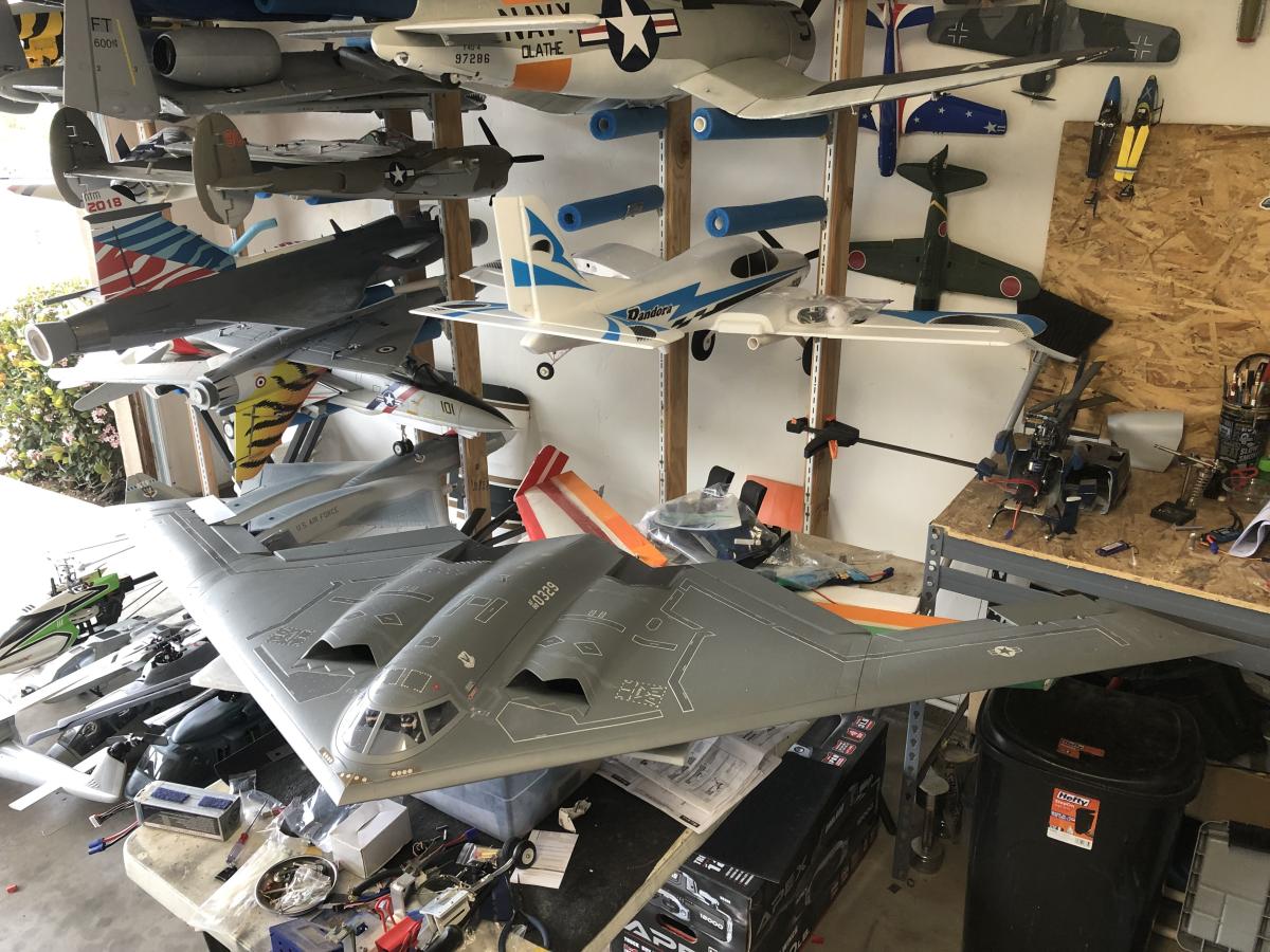

                                      Great job an this plane, took me 30-45 minutes to get it all set up. What I did that made it easier for me was insert the wings but let them sit vertically with the rudders in the up side. So the wing rod was in but the the screw terminals were 90 devs off.
                                      I almost thought I was done as son as I started. I only plugged the left wing in and besides lowering the rates it was perfect. 45 at rest no flush with wing tips when fully closed. My first thoughts was easiest plane ever to set up. But then I plugged the other wing in. Lol.
                                      so started it just the bottom surfaces got it to 20 off center of wing tip at rest. The using pot instead of stick drive closed. At this point I used endpoints to dial in the closed position flush with wing tip. Next adjust and connect top surface got it lined up flush with bottom surface while servo still driven closed.
                                      stroke with rot pot all good left.
                                      same thing right, only difference was I adjusted my othe side servo end points. Worked great. Only issues I had was when I put the wings in correctly both left and right sagged a bit giving wash in. This didn’t show up while I was setting up. Easy fix. Half twist in correct direction for each rod. Done.
                                      set up the 8mm and 4mm, I’m using 6000 HRB. So I can trim down if needed. Will correct if needed after maiden.
                                      Only real issue I have is trying to hold it to CG. 🥜
                                      can’t wait to fly her.
                                      Gravy
