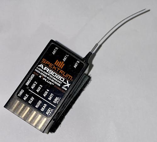

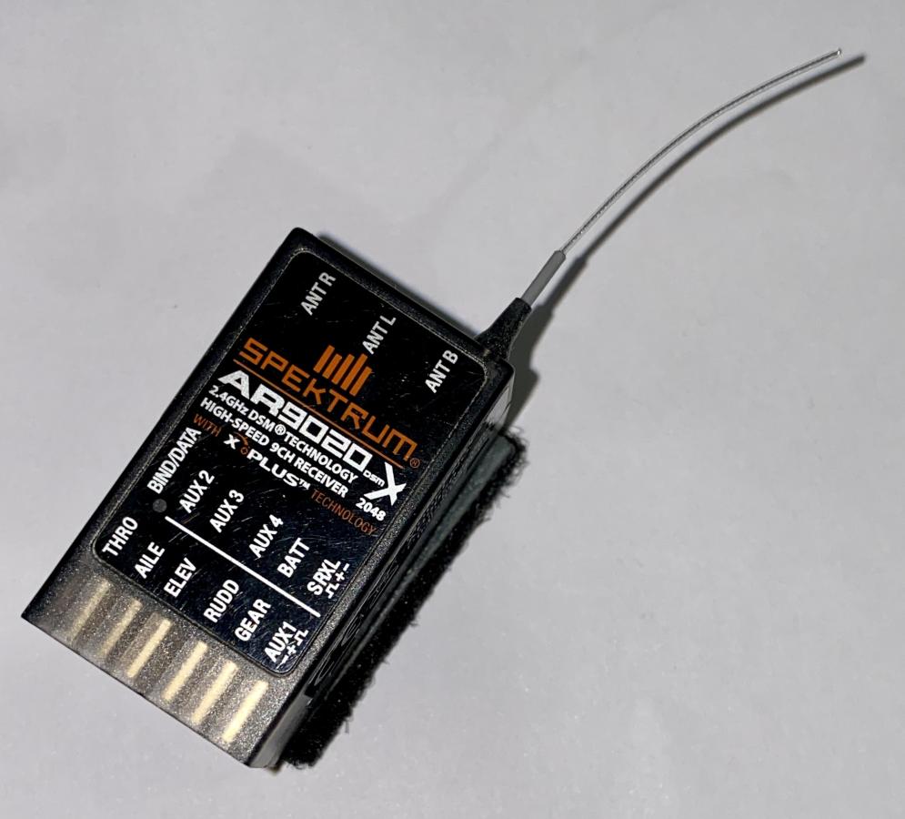

            I plan on using this Spektrum AR9020 with satellite receivers. Trying to stay away from AS3X since the B-2 already has the gyro Click image for larger version

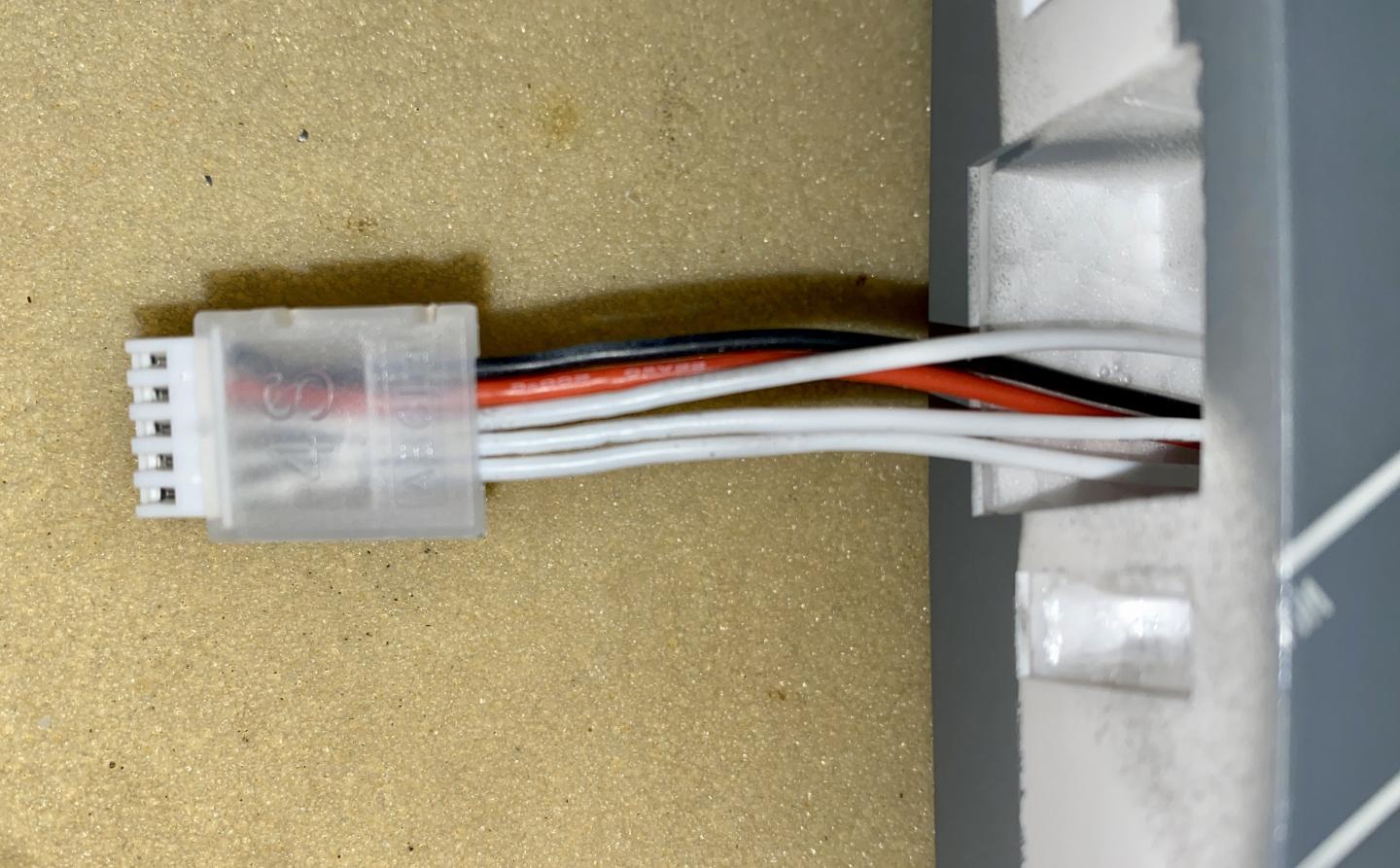

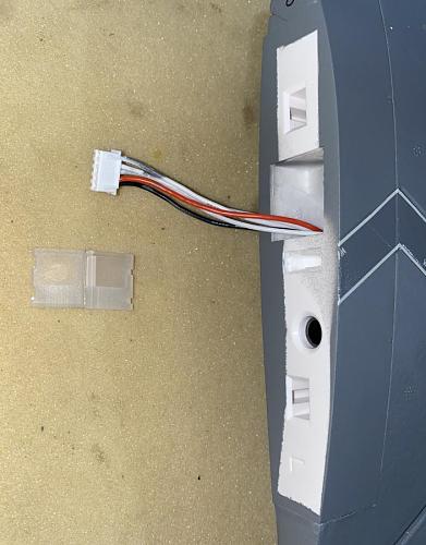

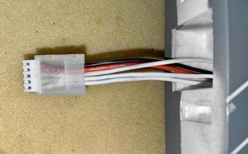

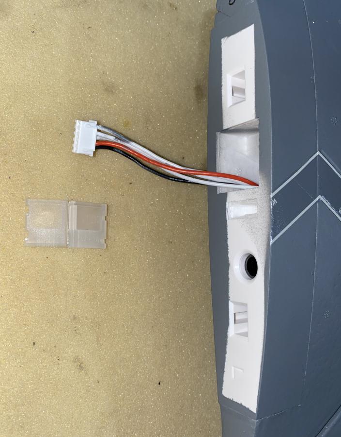

              Perhaps it is overkill and the instructions don’t call for it, but since I will likely be removing the outer wing panels often for transportation, I have installed wire harness connector protectors on the wing wiring harnesses using the protectors designed for a 4S Li-Po battery pack; I don’t like pulling directly on the wires. (see photos). Click image for larger version  Name:	7E151D80-02A9-4DE8-A094-FD8CC79AF7BF.jpeg Views:	0 Size:	155.8 KB ID:	342194Click image for larger version  Name:	2ED36A9E-21FB-4DB0-BC44-E7CE8E0BB6EF.jpeg Views:	0 Size:	75.6 KB ID:	342195

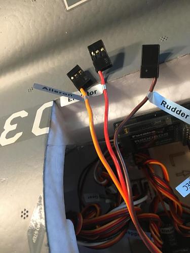

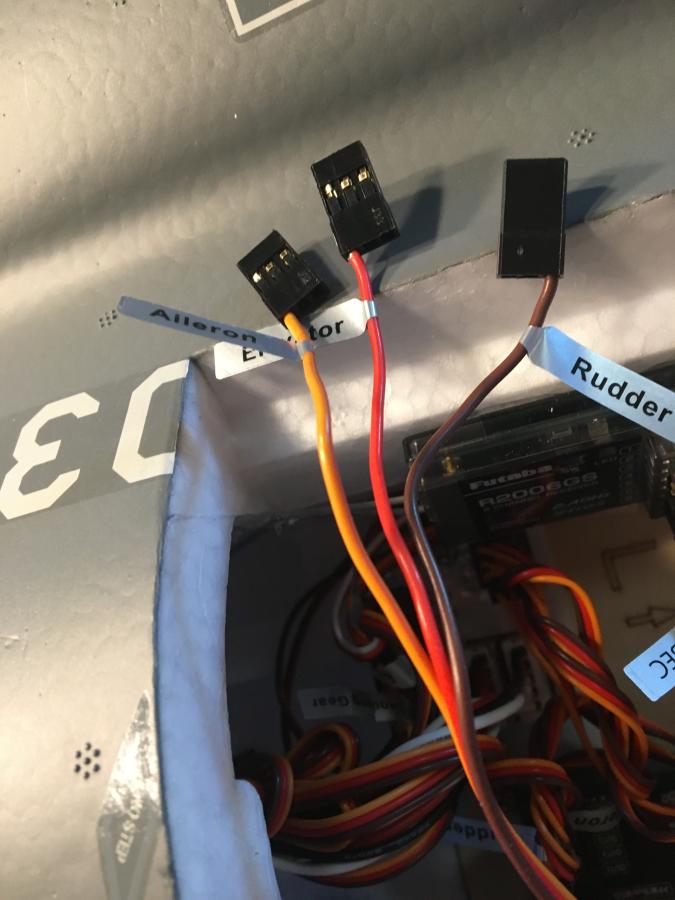

                    I may have a factory wiring issue….please look at yours.
                    The photo shows the A, E, R connections for the RX.
                    Shouldn’t ELEVATOR red go to the center pin?
                    When I plug it up and bind the RX, it starts out with normally open clam shells. But, when the gyro locks up… the left clams go fully open and right clams go fully closed.
                    If I disconnect A, E, R from RX, the clams stay normally partially open after the gyro locks up.
                    Gyro light is blinking blue with A, E, R not connected to RX which makes sense
                    Thanks!
                    Edit: I had a spare connector. Wired the plane’s elevator to the new connected red wire. Now the clams stay normal when the gyro locks up, but I have no E, R, or A function. Gyro stays blue flashing.
                    I only have 6 RX function slots and a 7th for connecting the BEC to RX. So, I have the plane’s MODE connector open.
                    -GG
                    Click image for larger version Name:	558FC379-B8E2-40F3-9A2B-16A6142CC8A6.jpeg Views:	0 Size:	58.9 KB ID:	342139
                    @GG,
                    Additional to your earlier solution of the problems above:
                    please connect your ‘MODE’ connector to a free slot in the receiver, and have this channel on a 2- or 3-way switch.
                    The gyro should show a continuous RED led (basic gain mode ‘on’).
                    It seems that your gyro is not in the correct mode, with it’s blinking blue led!
                          I also hate pulling these. Where did you get the protectors?
                            Good point. A switch must be assigned to that channel (port) via "channel assign" menu or the gyro won't get any "commands".

                                    Not sure where you like to shop but there are many places. I don't use them so I have a bunch I took off batteries.
                                    Amazon.com: RuiLing 5pcs 6S JST-XH AB Clip Buckle Balance Lead Wire Head Connector Protector Plug Savers for RC Battery Cable : Toys & Games
