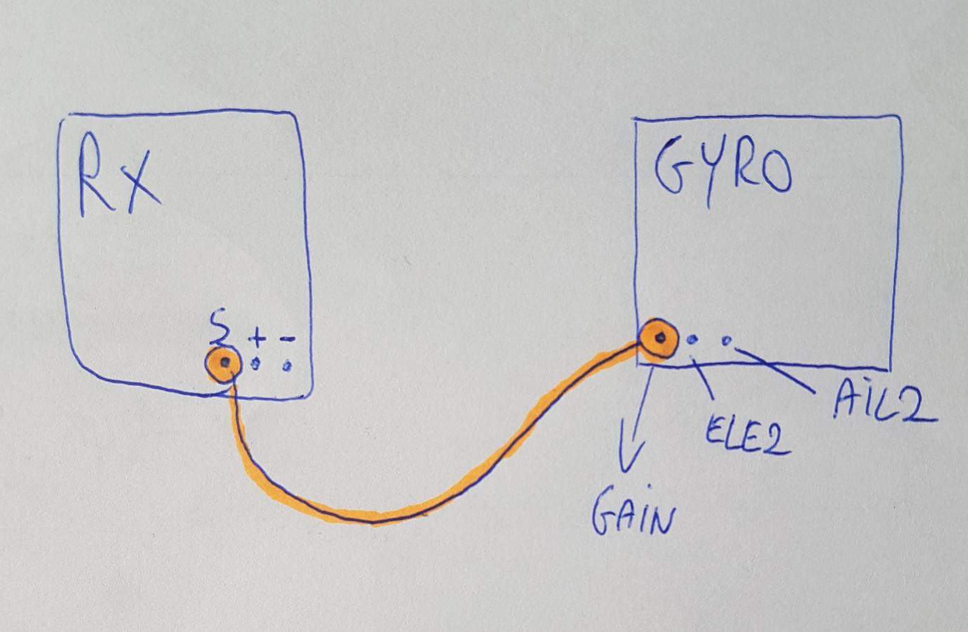

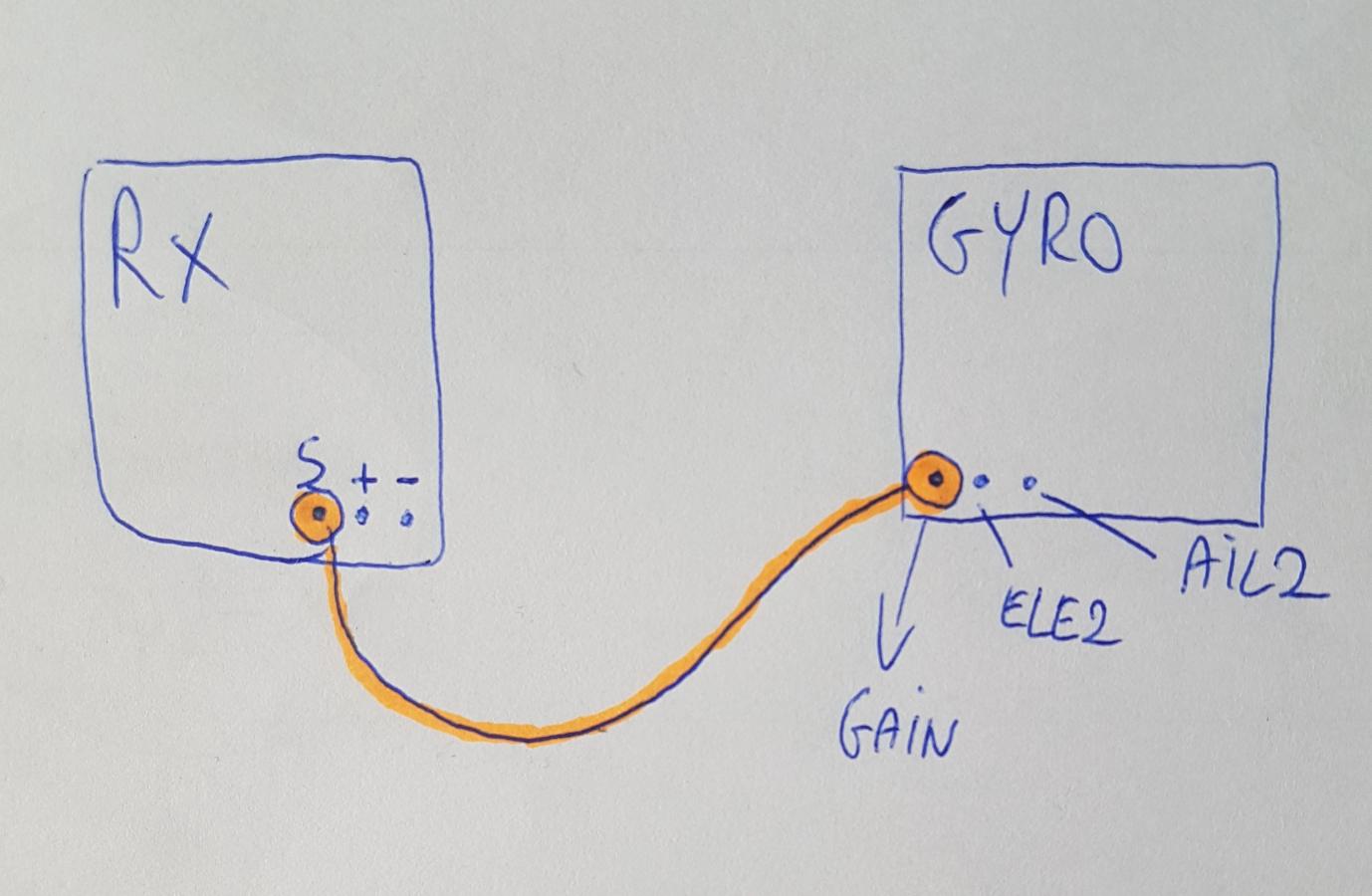

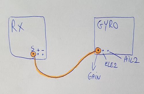

    No gyro program card needed to change the gyro gain
    Guys, please stop telling that a program card is needed to adjust the master gyro gain on your B-2.
    All you need is 1 female to female servo cable, 1 free channel on your TX and a slider or rotating knob .

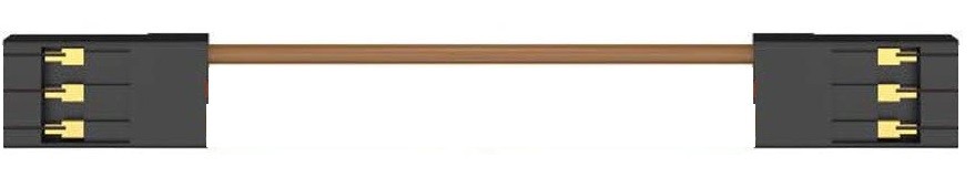

    Keep just one wire of you female to female servo wire (doesn't matter if you keep the black/red or white/yellow one) and connect it to the signal pin on a free channel of your rx. The other end goes into the lowest pin of the gyro gain port. See picture attached.
    On your TX, assign a rotating knob or slider to the free channel where you connected the single signal pin. Change the weight of the channel to 150. (150 might be different on other brand of radios)
    Now you will be able to raise the gyro gain or lower it and even shut it down while you are still operating in the normal gyro mode (with the solid red led).
    I found it easiest to put it on a rotating knob, so you can adjust the gain during your flight easily.
    Pls excuse my basic drawing skills

    Last edited by Icarus the 2nd; Apr 13, 2022, 06:43 AM. Reason: added picture of single wire female to female servo cable
      I have been saying that for a while. It's just like the HobbyEagle scheme.
      • So if currently the Ail are set 40%, Elv at 5% and rudder at full, if I connect and adj the gain 0-100% does the gyro settings lose the separation or does it stay.
        Which way does it work?
        A. Adj Ail/Elv/Rud all the same now 0-100% ie all at say 50% mid gain setting?
        B. Keeping the differential between the Three. Ie at 50 gain setting the Ail is 50% the Elv is 15% and rudder still 100, or at say 25% gain setting the Ail is 25% the Elv 0% and Rud is 85%?

          The master gain is just a multiplier for the individual gains. So if the master gain is set at 50% the effective gains become 50% of 40, 5, and 100 (which is 20, 2.5 and 50).

            • Awesome, that’s what I was looking for I have the manual which does not explain that clear enough to me. Thanks that cleared it up for me.
              I have also liking it in the manual if 0-100% equals 1000us - 2000us. The two or three different gyros I have used work from 1500 - 2000.
              Thanks again

                      • Be very careful about choosing the switch to adjust gains. On Spectrum, the rotary switch should NEVER be used for gains. It is an analog switch and will not retain settings for the model.
                        If the switch is moved for either a different plane or just bumped, the new position will determine the gain settings at model setup.
                        Basically if you use the rotary knob, don't expect your settings to be the same as your last flight.
                        Use a digital trim switch instead, that's what the extra ones are there for.

                                Icarus has been the SMART one over at RC Guppy. This is something that Kallend and I have been saying for days, yet few believed it or even tried to understand it.
                                Remember the confusion with those colored single wire leads when connecting stuff to the gyro? Regardless of color, those single wires are ALL "signal" wires. They go into the signal pin of those 3-pin ports. This is the same for the master gain lead. You hook up ONLY the "gain" pin on the gyro to the signal pin on the empty RX port. In this instance, stop thinking in terms of "polarity". Forget about the color of the wire. Also, the other pins on the "gain" port of the gyro are for something else. They are NOT power and ground pins. If all you're doing is using the master gain, eliminate the other two wires. It has become obvious that some folks haven't gotten this concept and "It doesn't work".
                                As an aside, the rotary will adjust the set gains proportionally from ZERO to 100%. If the set gains are 40, 5, 100 and you put the rotary to 50%, you will get 20, 2.5, 50% on the gyro. Turning the rotary to ZERO is basically turning the gyro OFF. You can reduce the set gains but you cannot go above the set gains with the rotary, unless you increase the travel of the rotary above 100%, BUT, this has not been tried (by me) and cannot be confirmed until it has been tried.

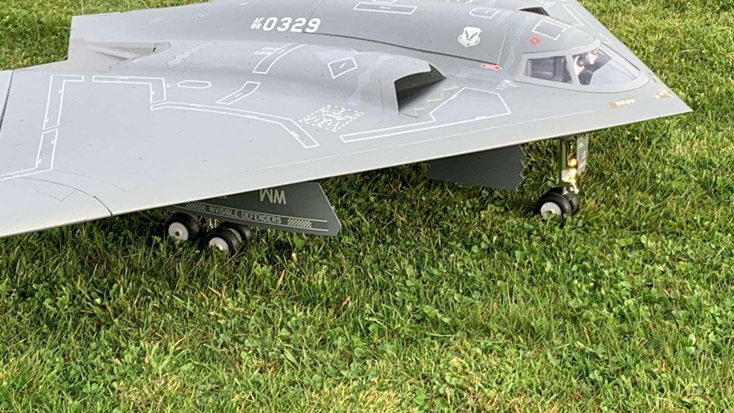

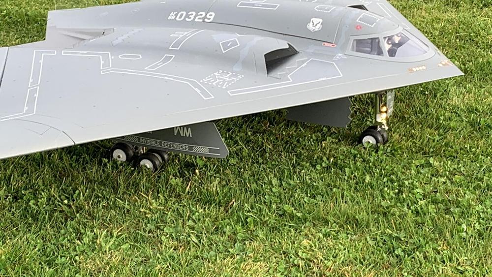

                                    • First runs on grass today, the field had been mowed two hours before. Everything setup as per instructions, ESC were individually calibrated, 750g HRB 6s 5000mAh Lipo. Telemetry showed a max Amp draw of 106,2. That landing gear is definitely not made for such fields, before and after that I made several flights with my Avanti S. Disappointing...
                                      Edit: A couple of successful flights with my Avanti S were also made this afternoon
                                      Click image for larger version  Name:	B-2 Taxi Run 13 Apr 2022.JPG Views:	0 Size:	229.7 KB ID:	342857

                                        • Originally posted by Radar-Guy View Post
                                          That's exactly what mine looked like on Sunday. Next time I go out I may add 5mm more up up in the elevators, use a smaller lipo and hold in some up during the takeoff run.
