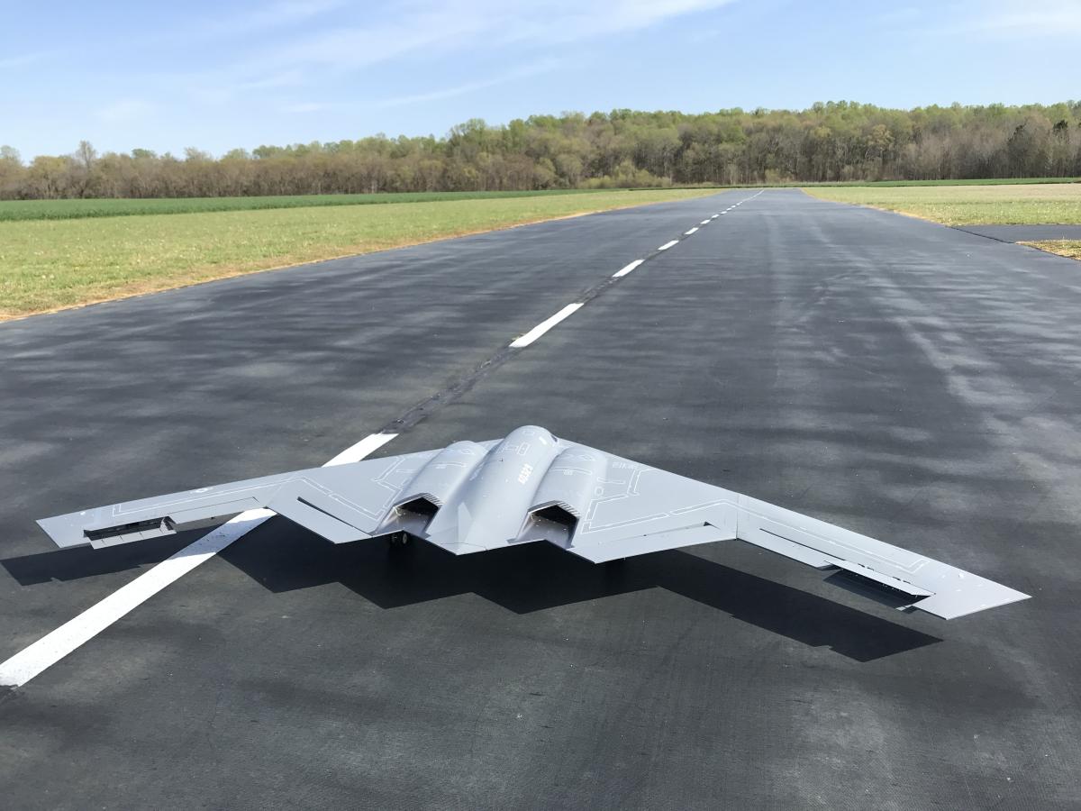

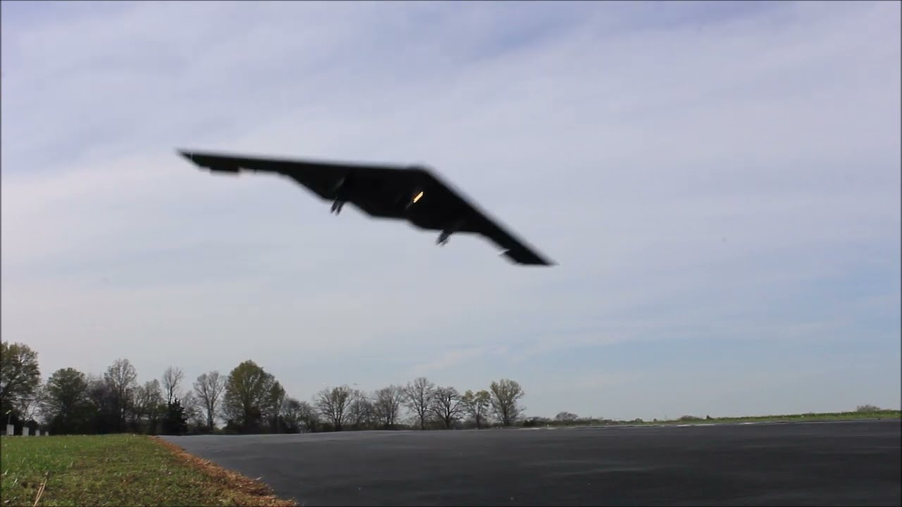

ID:	342650Here's my maiden flight session. No cameraman but I tried to just edit to where you can watch the jet going through the paces. I lost my canopy on my second flight! It was my bad-I didn't puncture the tap with the latch....
              My first flight impression is this thing is awesome. It flies really nicely. It's locked in on all axis and tracks very well. The drag rudders are very affective and forgiving.
              The only issue I was having was getting it to settle on landing. My runway is geomat and it's bumpy. I found I did best when I really held the flair for as long as possible to land with minimum energy. Anything less and it would bounce on me but remained controllable. I really loved flying it! It's going to be a new favorite for sure. You guys are in for treat! I found 50-70% throttle is all you need. Back off your throttle and you will find the jet is really comfortable at slightly slower speeds. 4:30 flights times and I still had 50% charge on my 5000 mah 6s pack.
              I'm using the recommended settings here: 45mm open drag brakes on neutral, 8mm up trim on elevator, 4mm uptrim on aileron (for reflex).

                Great flights and use of the camera,

                    The more I think about my first session the more I realize how well built this jet is. It doesn't just fly, but flys WELL. It's efficient and predictable. I think I'll be getting 5 minutes on 5amp 6s packs.
                    I'm still having trouble with my flare on landing. I'm pretty rusty though. I haven't flown an EDF since last season and even then I wasn't flying much. I will work on my flare at landing and really let it slow down. Landing fast leads to Pilot induced oscillation (PIO) so be careful with that. The landing gear held up well to the abuse!

                      Thanks for the video and flight report, Pete. I plan on maidening my plane using the recommended settings from Jeremy Solt, and apparently what you used for your successful flights. It looks like a fun plane to fly.
                      I'll have to wait a little longer, being that we live in the upper northwest corner of Wyoming. I think we had Spring for awhile, but I guess that was "FALSE SPRING." Getting a bunch of snow and winds the next couple days. But eventually it will be REAL SPRING, that occurs just before ROAD REPAIR and TOURIST seasons! It's All good!

                        In many of the (non-Jeremy) launch vids I've watched, the moment of transition from on the ground to in the air is somewhat abrupt. This and the reports of the B-2 being difficult or unable to get off the ground from grass fields leads me to wonder if this plane might benefit from a slightly higher AOA when sitting on its landing gear. i.e. I think lengthening the nose wheel gear somehow to raise the nose a smidge may turn out to be a worthwhile mod. Maybe shim the whole nose gear mechanism's attachment to the foam by a mm or three? Or maybe slightly larger diameter nose wheels? (If there's room that is.)

                                    This is a keen observation. I will say that if you don't touch the elevator it will just lift off. On most of my take off's I was giving back elevator input (trying to get it to lift off before passing the camera) which really makes it "pop" off the runway. I want that slow and steady rise...probably pilot technique.
                                    I did try moving the battery slightly forward to bump up against the pilots and I also moved it aft until it was centered on the wood mount; I didn't notice too much difference in flight characteristics so don't worry too much about exact positioning. However, I had the battery up tight against the pilot's backrest for maiden.
                                    I didn't even try any other gyro presets (attitude lock,trainer). The stock setting is really awesome. I would recommend you fly it there, then consider tinkering...
