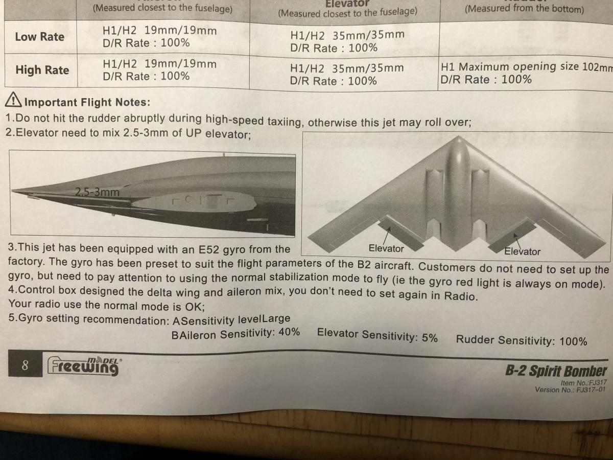

              It appears the internal settings are 40% aileron, 5% elevator, 100% rudder
                  Great info. How was this discovered? Seems like 40% is too much for this plane on a full throttle high speed pass. Turning that down to say, 35% by master gain, isn't going to affect the ELE and RUD gain in a bad way.
                  Nevermind. Rudy picked it up in a video of the manual.
                    Yup, I took a screenshot of the manual of the FNRC unboxing and setup video and used the iPhone text recognition to translate. Theres an extra photo in there too which shows where to measure the 2.5-3mm of up elevator trim from.

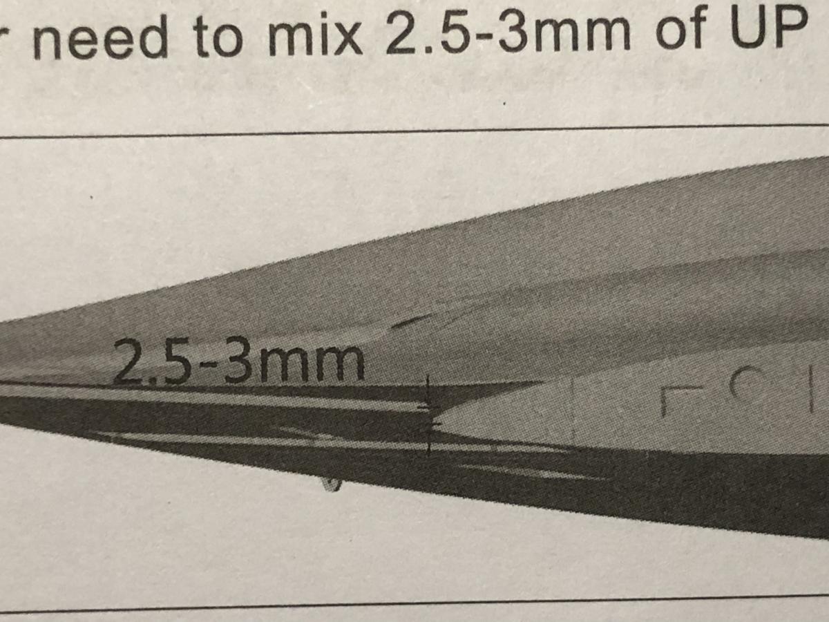

                            Any chance you can post those screen shots, or maybe you have and I missed it. Really like to see where they measure from.
                            thanks
                            Gravy

                                Well I’m going to put this into stuff my eyes see but my brain says “that’s garbage, off to the round file cabinet”
                                not only is what I was looking for but also on the page with throat recent repainting.
                                I will say the black lines are really hard to see, but camera zoom took care of that. And for the gyro setting n the last thing talked about on his page. Yes Page 8.
                                As I said earlier I’ll fly her stock and screw with the gain if need to if I notice issues.
