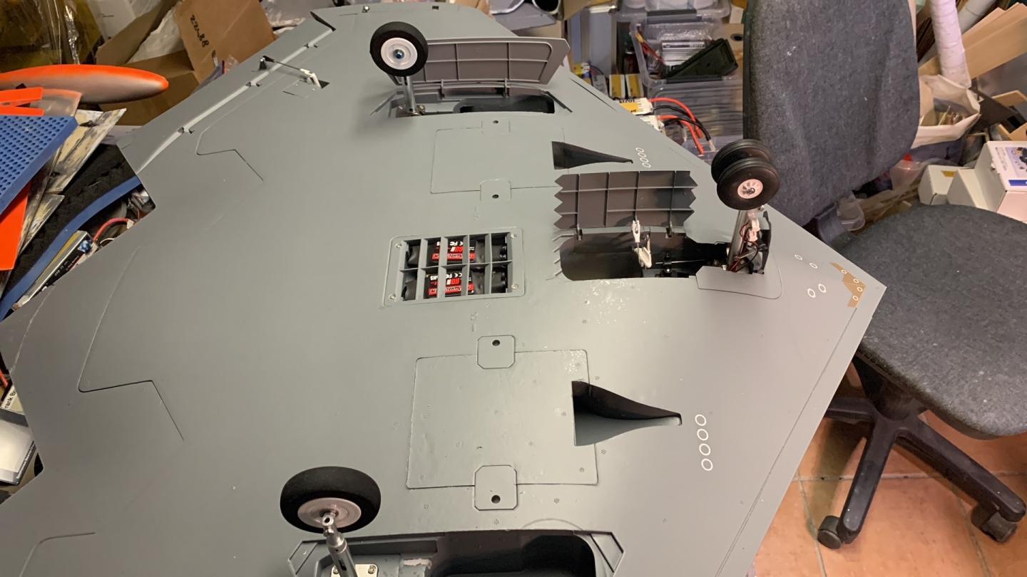

            • As I still haven’t had the time or weather to maiden my B-2, I’ve continued working on some mods to the landing gear. I finished up moving the nose gear forward and have installed a servo to control the nose gear door. Since that change effectively shortened the nose gear by around a 1/2 inch, I decided that I’d need to shorten the mains to get enough AOA for takeoff. The shorter mains would also look more scale. There was just one problem.. If I shortened the mains by 1/2”, the folded gear trucks would hit the retract motor. I decided to do something I have done successful a few times before the remedy this; flip the retract to fold the other way around. I did this on my FMS P-39 mains which had a very similar issue.
              After a few hours with a belt sander and some leftover styrene, I was able to reconfigure the retracts to fold away from the motor. I then shortened the struts by a 1/2”, re-tapped the set screws, and reinstalled them on the model. Then I realized that with shorter gear legs, I could move the retract units mounting point a bit farther forward. I did this by using the forward screws in the stock mounting plate to mount the aft retract screws, and adding some plywood to mount the forward screws. While it was a lot of fiddling (most of the day), I’m pretty happy with how it turned out. I’ll get to detailing the cockpit next with some more scale sized 3D printed pilots. Here’s how it looks so far:
              • A few more detail shots of the gear modifications

                  • Originally posted by F106DeltaDart View Post
                    Your work is incredible, and your dedication admirable, but this is certainly not something I'll be attempting!
                    The look of the front gear further forward definitely looks better then stock, but I understand why Freewing and Alpha did not pursue this setup.

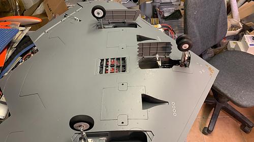

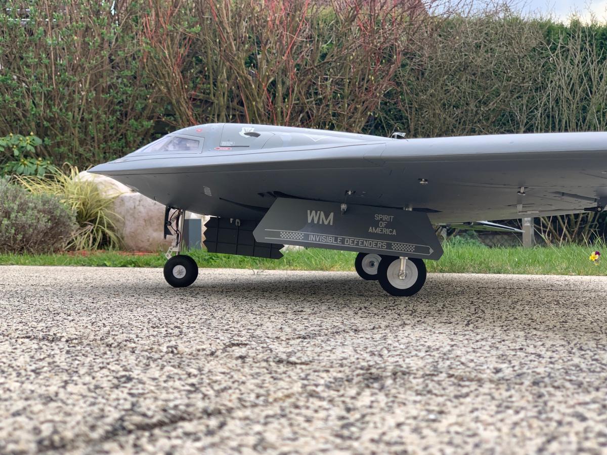

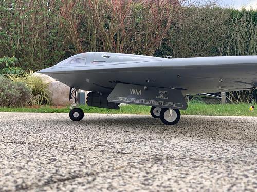

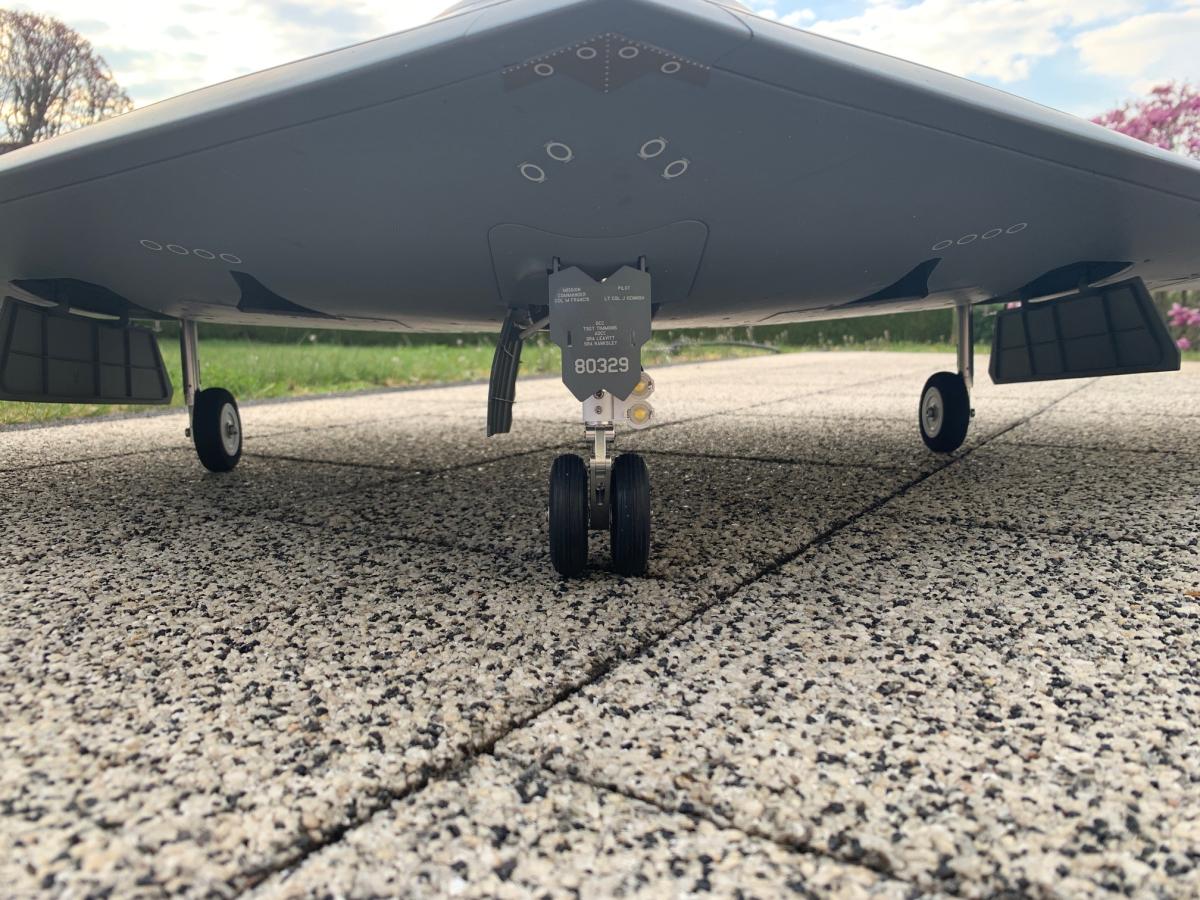

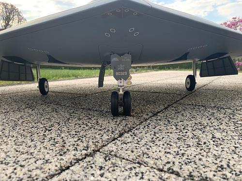

                              • Originally posted by Radar-Guy View Post
                                Single wheel main gear conversion finished, the nose gear wheels were also exchanged (50mm). Reverting to stock main struts can be done in less than 10 minutes, no foam had to be cut at this point. Positive AoA is retained.

                                Awesome work as I also fly from mossy based grass fields a lot I suspect any esc/battery woes you had will magically disappear now. I wonder if the MIG 29 twist and turn was the intended drop in for the moulded bigger wheel wells.
                                Do you have a picture of the doors shut, are they flush. I wonder if there is room to fit the dual axle two stock wheels to the outside for scale appearance only.

                                    • Originally posted by Raydar View Post
                                      Thanks! With these wheels the doors stay ajar by about 3mm. I‘d like to see first if I can get her to leave the ground. If that works, I‘ll try the behaviour with slighter smaller main wheels. The next option would be to cut away a small area of the door to clear the wheel and to cover it with a small printed blister. Shimming the rear portion of the retract mounting plate might be another option, but one of the previous ones is my favourite choice.
                                      Note also, that the 60mm whell doesn't touch the wheel well at any position and that an outboard facing position didn't work, because the touched the front door hinge during retraction.
                                      The original wheel truck is tilted during retraction (upon contact against the "wheel well ceiling"), hence you would need to retain that feature for the outer wheels. And, they would still be there and there is a good chance that these will touch the grass. But maybe I got your idea wrong.
