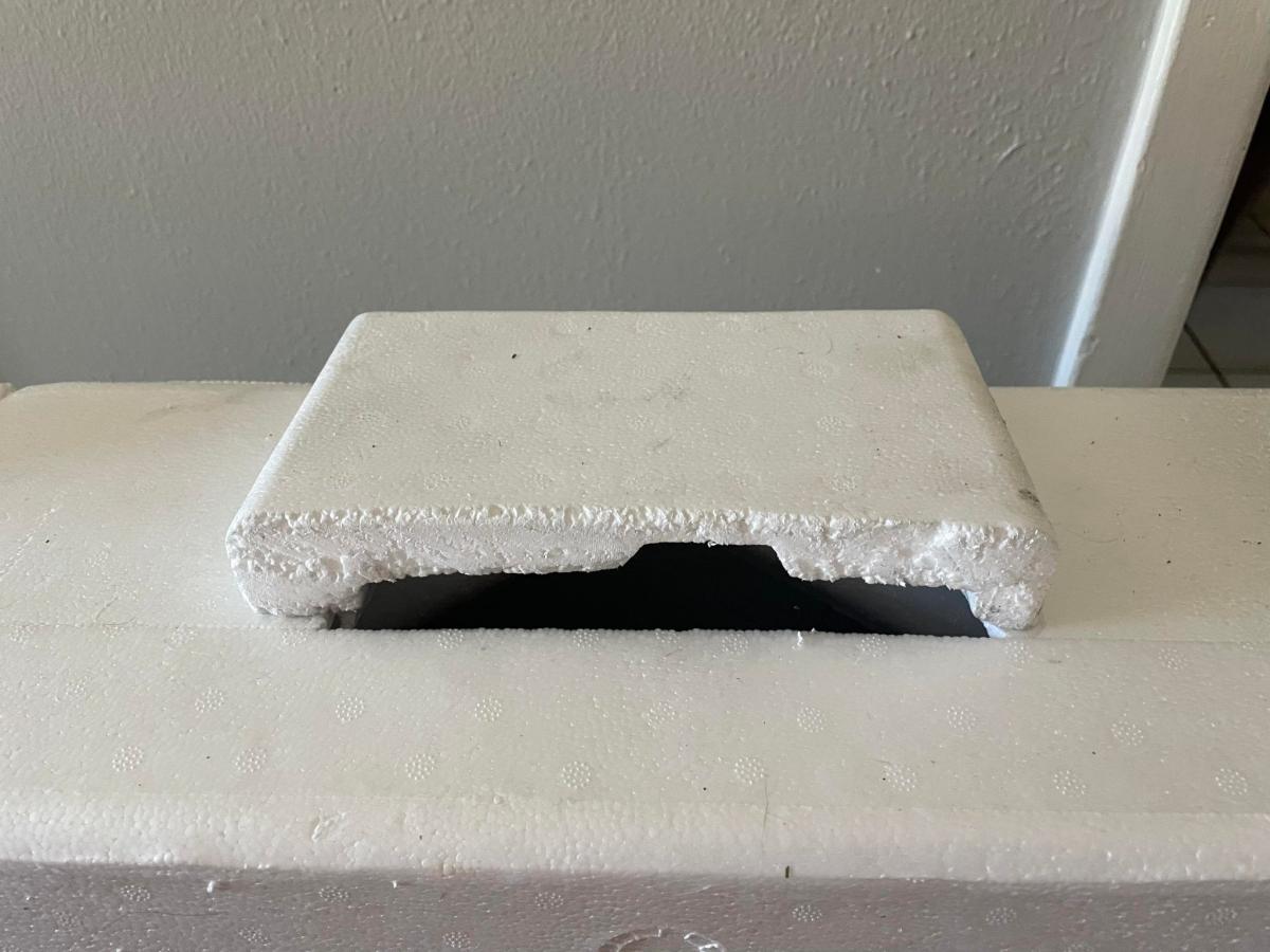

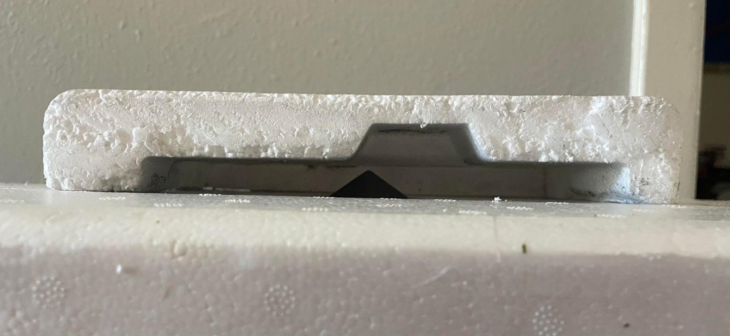

            I just noticed the glue on whale tail sticks out of the shipping package when attached.
            Instead of glueing mine on, I'm going to add a couple of sleeves and rods and magnets hold it in place during flight.
            Gorgeous model.
            i used some of the foam packaging material I kept from other items, and attached over the exposed area with foamtac
            Some of my buddies are going to use magnets to attach theirs

              #346
              After all that went into the design of the box, I can just see the talk in the box design room when they put the plane into it ..................................
              Designer no.1 ----- Oh crap, it's a couple inches too short to completely enclose the tip of the tail. Now what do we do? It'll set us back weeks, maybe months to make a new box.
              Designer no.2 ----- Let's see if the plane design team will just chop off a bit of the tail end and call it a "duck tail". It sounds cute and nobody will be the wiser.
              Team leader ------- Done! Let's do it.
              Oh, let's hire a new set of box designers. The old ones can go to janitorial.

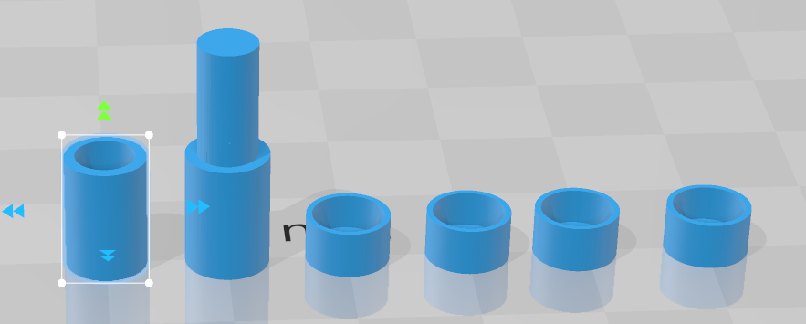

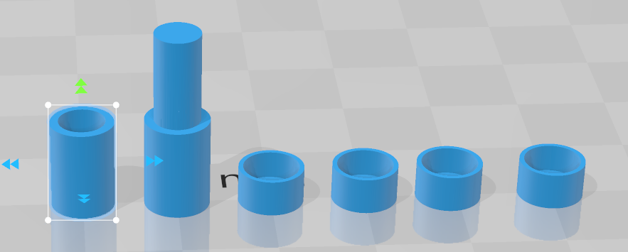

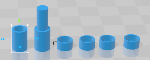

                  For those that want to have a removable whale tail.
                  Pin and socket plus holders for 6x3mm magnets. Inserts are all 7mm outer diameter. Print at 100% infill. Enable thin wall detection if necessary.
                  Click image for larger version  Name:	Screenshot 2022-04-09 171127.png Views:	0 Size:	56.5 KB ID:	342324
                  Whale Tail Pins.stl

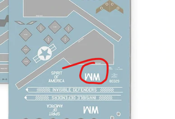

                    ​Ugh, just noticed. Gear door stickers are upside down for tail code.
                    That is so annoying.
                    #edit
                    Looks like the decal sheet is also printed wrong. The scale monkey on my back is scowling.

                    I just noticed that one of my wheel door decals is off, as you mentioned with the "WM" being upside down. The other side is ok. Do you or anyone know how to take off that decal (looks like a waterslide to me) without damaging the paint on the gear door? I might have Callie reprint it with "Spirit of Missouri" on each side.

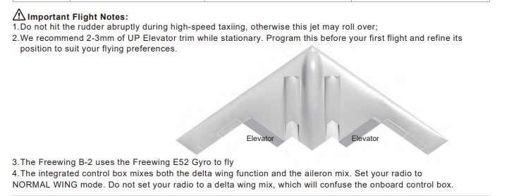

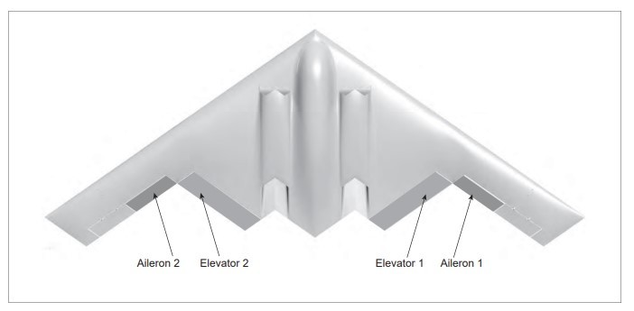

                      Reflex Setting -
                      Since both surfaces (ail and ele) respond to Elevator input, are we to reflex just the Elevator? or both Elevator and Aileron surfaces?
                        • 5389
                        #351
                        Clear to me just the elevators

                          #352
                          thats how i reflexed mine. just elevator surfaces. Seen images that appear to show both were done, and had someone say its both. I'll let James or Justin confirm

                              #354
                              Davegee
                              I haven't tried anything. The good news it is on the plastic door, not foam so that gives some options.
                              worst case is removing door and sanding and repainting. Any slight mismatch wont be noticed under the plane and in shadow.
                              The tail code is part of the larger decal. Before going the extreme route of sanding and repaint, I would try a decal solvent such as MicroSol. It still might be easiest to remove the door first so you can easily soak the decal.
                              Since you are pretty much replacing the markings on both doors, I would start with the remove the parts and soak them.
                              I don't know exactly how I'm going to fix it yet.
                              I expect some sort of replacement decals to fix this, same way the T33 was fixed years ago. Maybe Motion will address this in a different way? In the meantime I have a support ticket in on the issue.

                                #355
                                Hi Gilatrout: I concur with your findings. I always buy a can of touchup paint matched to a sample of the plane. I'll probably take a wingtip to Ace Hardware next week and get that done.
                                I read someone, not sure if that was you or not, was going to have Callie make new gear door decals with a "Spirit of MIssouri" instead of "Spirit of America" as well as the corrected "WM" decal on it. I was born near Whiteman AFB and my dad flew B-47s with SAC back in the 1950s out of Whiteman, so I though that would be appropriate to do.
                                Worst case, the decals can be gently sanded off if Microsol or some other soft remover doesn't work. Easy to spray a new matching color with an airbrush; nobody would ever know.
                                Let me know if Microsol works for you. I might have a little left, but if not, if you have luck removing the decal with it, I'll order some.

                                  #356
                                  Originally posted by Jdcrow
                                  Reflex Setting -
                                  I found a post by Jeremy about setting the reflex.
                                  Per Jeremy's post "You may need to pause the video but you can see where the neutral spots should be close to for successful flight. Measuring from the triangle piece between the elevators and ailerons You want innermost elevators up about 8mm, ailerons up about 4mm and drag rudders 45mm"
                                    Log into Facebook to start sharing and connecting with your friends, family, and people you know.
                                    Hmmm ................... That's 8mm on the inners and 4mm on the outers. That's quite a bit more than the book's 2-3mm on just the inners. Did he say anything about if he went by the book CG? 8 & 4mm would seem to suggest that his model was more forward CG, but ................................

                                      You can see it in the videos. All 4 surfaces have some reflex to them, except rudders.
                                        #edit
                                        Click image for larger version  Name:	Screenshot 2022-04-09 154606.png Views:	0 Size:	79.8 KB ID:	342301
                                        It's not so hard to create your own replacements (quick one blw) and print these on decal paper.
                                        After looking at many photos of the real thing these marking on the main gear doors are in italics. Has that been changed recently?
