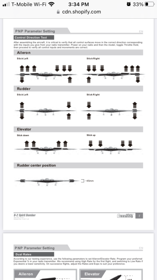

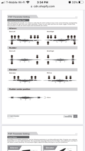

          Click image for larger version  Name:	66662934-9F12-46F7-8720-EC5EC606A9D6.png Views:	0 Size:	160.7 KB ID:	341978 Heads up…
          Edit….my confusion. See subsequent post #209
          Pretty sure the old and new versions have the elevator vs stick position reversed.
              -GG
              no. you pull the stick down, and your elevons will go up (pitching your nose up), and when you push your stick up the elevons will go down (pitching your nose down)
                I think he's talking about right and left turns
                #edit#
                Nevermind, I see the picture is looking from behind the aircraft, not from the front

                    #209
                    Got it….semantics got me.
                    STICK BACK = STICK DOWN=PULL UP NOSE
                    STICK FORWARD = STICK UP = LOWER NOSE
                    The confusion is that in my flight training, when the instructor said, “Up stick” he meant move the stick so the nose will rise up.
