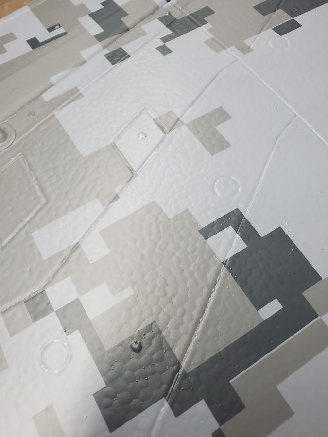

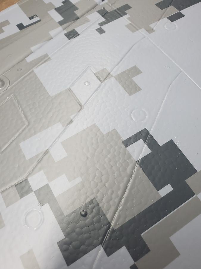

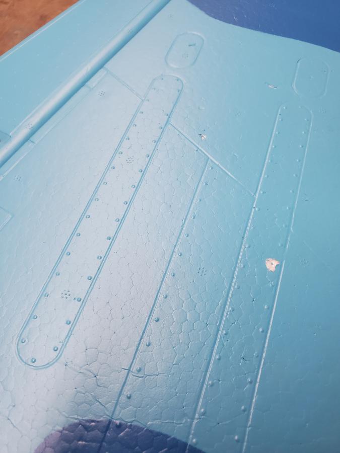

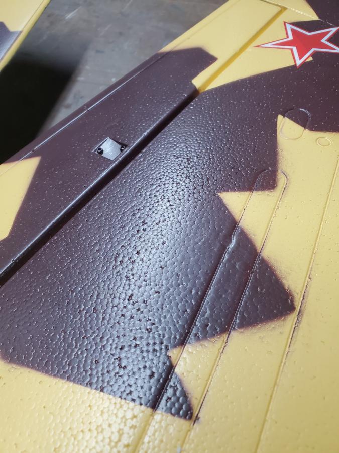

                                        Some pics the top wing surfaces of three of my planes. The E-flite Su-30 and Freewing Mig-29 are EPO and the Freewing Su-35 is EPS. All were coated with clear water based polyurethane varnish in either gloss or matte finish. The "quality" of EPO is better IMO....much smoother and more durable. The EPS plane shows a much rougher finish out of the box with many "divots" between the individual foam cells. And of course the EPS plane has much more hangar rash just from handling the model a bit too rough. The Su-30 and Su-35 have been flown many times and the Mig is still new with only a few flights.
