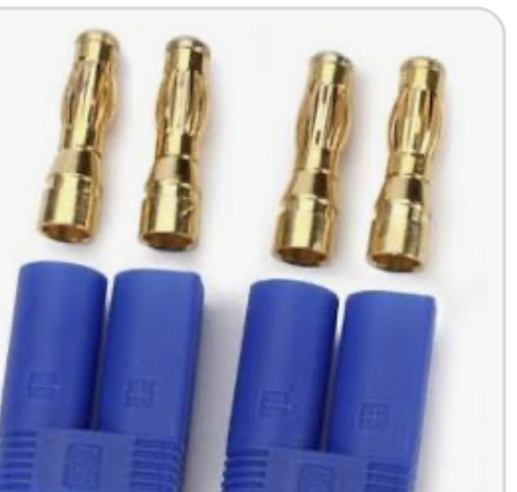

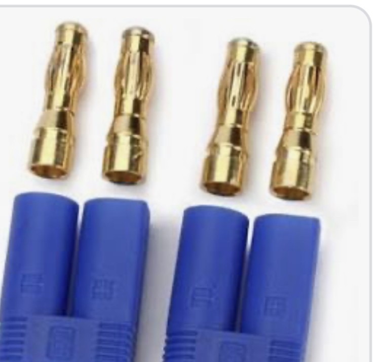

                  • A tip applicable to any EC5-equipped aircraft…
                    Components do get stressed when used a lot. My second experience with an EC5 connector that failed happened recently. Luckily it failed as I connected the battery and not while in flight.
                    HEADS UP! Details follow.
                    A commonly used (aircraft side) EC5 design is implemented with a thin metal screen/spring surrounding a central barrel (photo below).

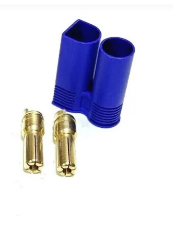

                    Another common EC5 design is implemented with a split barrel (flower petal like) and NO thin metal screen/spring (photo below).
                    My experience (heavy user) has shown that the thin metal screen will degrade with use and may even become detached from the central barrel, as was the case recently.
                    My suggestion: Replace the OEM EC5 thin metal screen/spring connectors with the split barrel type and avoid a potential headache down the road. A crash may be avoided.

                    • I have to say, I have never had any issues using those EC5 spring connectors, I do not like the barrel kind you have listed, those tend to collapse over time and not make a good connection, I only use the Eflite EC-5 connectors, there are knock off versions as well and they are junk in my opinion, I tried them one time, Eflites are better quality and yes there is a difference. I can see where the spring connectors can fail like you say though, I will keep an eye on mine, maybe look inside with a flashlight or just change them out after so many uses, I run even 12S with no problems yet.
                      • The other issue with the thin metal spring is that EVERY connection spark blows a little of the thin metal away. Even if the spring remains soldered to the barrel, eventually the spring metal disappears.
                        One can disassemble a “well used” spring type EC5 and see the progressive damage that results from the connection sparks.
                        Point noted on the collapse of the split barrel type, but a thin screw driver carefully inserted can restore the “set”.
                        There’s no way to restore metal that’s been blown away by the spark that happens upon connection. The spring type EC5 connectors WILL FAIL! But…my usage is an extreme case.
                        Example: In the last 3 days, my birds have flown over 60 flights.
                        -GG
                        • I think either one is prone to fail after a certain amount of cycles. That said, I agree with DC. The EFL spring type just plain connect and disconnect better and give a more reliable connection for the amount of time they last. Probably best to constantly watch for damage no matter what you use. It would be nice to have a resistance test of the different manufacturers especially after, say, 50 flights.
                          Fly low, fly fast, turn left
                          • As always, there’s something to be learned from posting. I did not consider the split barrel type EC5 connector’s potential loss of contact over time. So far, I have not experienced that…but will monitor for it. The spring-type’s loss of metal over time due to the connection spark remains a concern of mine, for sure. I’ve seen the results. Thanks.
