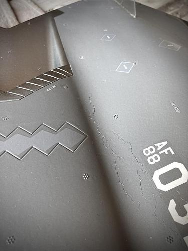

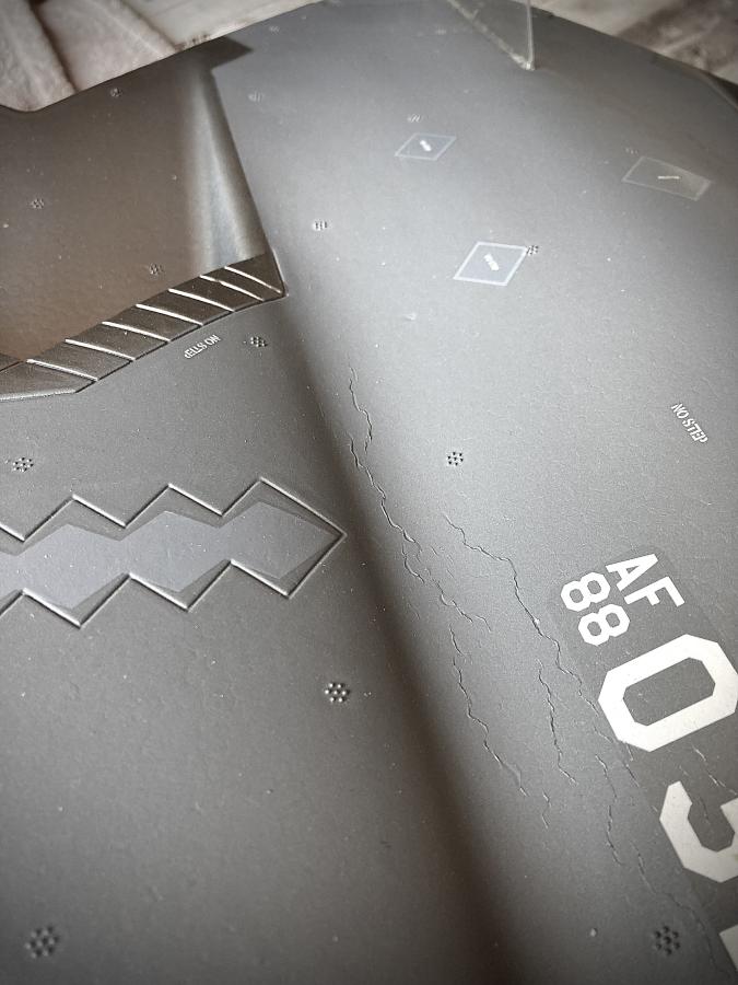

              Some might be interested in an update / “How’s the B-2 design holding up?”
              With the number of flights on her totaling well north of 1,000, here are my observations and flight conditions. The actual number of flights is LARGE. I’ve made 70 flights since 06/03/23 just to give you a feel for the activity my B-2 is seeing.
              - Each flight at least one loop is performed.
              - Not much full throttle flying is done.
              - Some aileron rolls are done, but this is not an airframe stressing maneuver.
              - Several nose gear servos have been replaced due to a bent worm gear.
              - CG by the manual.
              - Flying mostly at sunrise or near sunset in calm air.
              - One inner “elevator” servo failed. This caused an almost uncontrolled landing…hit short and hit a big rock with the nose. Smushed up the nose pretty well. Both inner elevator servos were replaced after the “crash”. The nose foam and nose gear hardware was repaired easily enough. No damage was done to the mains. From the rapid deceleration, the left outer panel spar broke along with the left outer wing plastic mount…both replaced.**
              The photo below shows how well the airframe is designed. There is an area of small stress cracks in the foam in the same location on both sides. These stress cracks were present before the landing accident. They are not growing in size as the total number of flights increases.
              For the workout she’s received, the B-2 is holding up VERY well. I am impressed!!!

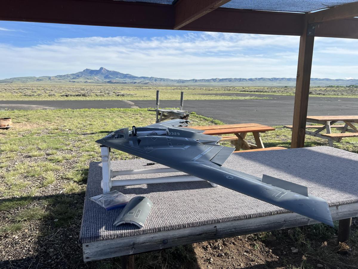

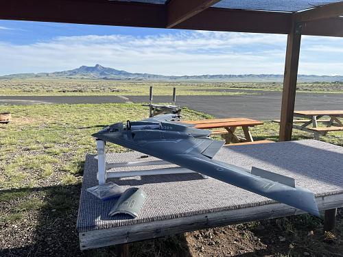

                        I thought I was doing well just completing my 26th successful flight today! Good going and congrats on your 100th flight, GliderGuy!
                        I agree with your above comments about the handling of this airplane. Here in WY, we get a "bit" of wind from time to time. This morning was near calm, and those are my parameters to stack the deck in my favor for a fun and successful flight (hopefully with no damage!) I fly this plane pretty much as a "cruiser" sometimes make a "banana" pass where I go past the extended centerline on a pass, and then swing over the runway in a nice "show pass" good for pictures in this beautiful blue sky we have here. Today's takeoff was a bit of a challenge, as it did a "British Jump jet takeoff" really too early to fly when It bounced off a rough part of our runway, but I kept it down in ground effect for a little bit to build up safe flying speed. Happens a lot, up here, but at least we have a paved runway, which is good.
                        I'll attach a pic on the set up table as I was taking it apart to come home after my flight today. Also flew my F-4N which flew beautifully on its 27th flight, or so. I've now flown all my jet warbirds in the past week, a T-33, A-4E, F-4N, B-2, and F/A-18C. All fun but challenging to fly (for me).
