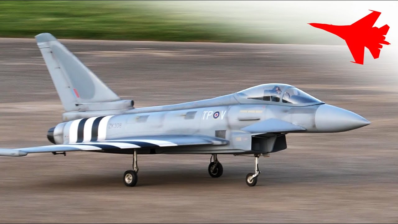

      Done feed well the little one... !
        • 2691
        #903
        SWEEEET! Congrats on the jump. Just what we need, Jandro, Svengali of Post Stall, going to Turbines!! Like Musk on Steroids! God Help Us, as we are "Not Worthy"!
