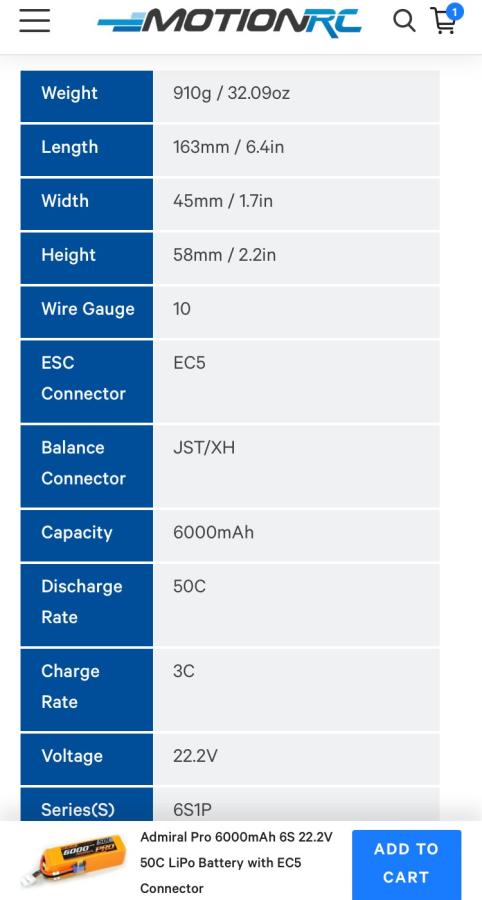

                        Better plan getting better batteries, there a lot of choices and though I don't use SMC or HV ones, what Hugh is recommending are very good. The CG marks under the wing, the manuals spot is very nose heavy. 20-25mm back rearward from there is a much better spot. There are some people even further aft but they also use gyros to help with it that far aft. I recommend starting about 10-15mm behind the marks for your maiden and move from there.

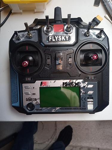

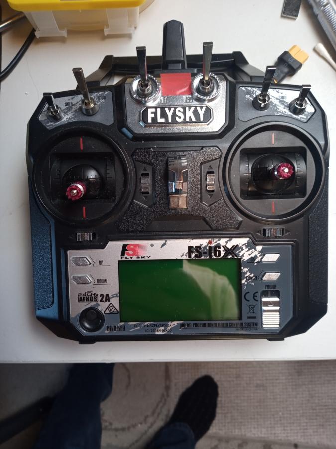

                          I have the same radio, FSi6X with 10 channels. iA10B rx. There are only 3 mixes available. I have replaced the VRA switch with a 3 position switch which I use to control gyro. You can use VRB switch for master gain adjustment if you wish or replace it with a 2 way switch for throttle reverse. Starting from left to right looking at the tx I have assigned switches as follows. switch 1 gear, switch 2 flaps, switch 3 gyro, switch 4 gyro gains., switch 5 dual rates, switch 6 throttle cut. I use the Hobby Eagle A3 super 4 https://www.youtube.com/watch?v=PWuGK8tU4AE&t=9s. It has 2 elevator and 2 aileron slots and allows you to change servo direction ( buy and use the programme card) and adjust the gains on each channel. Select flying wing/delta wing in the programme for Eurofighter. I do not have the Eurofighter but I use this radio and gyro on my SU35 and will be using it on my Mig 29. You may have to reposition some of the switch to board wire connections to suit your own desired switch positions. Using the A3 super4 will enable you to do some mixing and still leave the 3 FSi6x mixes available which may be required on some models. to give you an idea of what is possible see below.
                          Current setup of SU35 with Flysky FSi6X tx, IA10B pwm rx and Hobby Eagle A3 super 4 gyro using programme card designated as flying wing.
                          Channel 1 Left taileron servo (aileron in radio tx)Y`d to left (up/down )vt servo to gyro out 1
                          Channel 2 Right taileron servo (elevator in radio tx) Y`d to right (up/down)vt servo to gyro out 2​
                          Channel 3 Throttle/motor( throttle in radio tx )
                          Channel 4 rudder servos( rudder in radio tx) Y`d to central left to right vt servo to gyro out 3
                          Channel 5 Landing gear ( assigned to switch 1 on my tx)
                          Channel 6 Flaps( assigned to switch 2 on my tx). Currently no flaps with SU35 but will be required for my Mig29
                          Channel 7 Gyro main gain to roll dial on tx ( assigned to switch 4 on my tx) Vrb on pcb
                          Channel 8 gyro on/off/autobalance lead( flight mode lead )connected to serial/RX/M port on gyro
                          (assigned to switch 3 on my tx)
                          Channel 9 left main wing aileron servo to gyro out 4 (set as ail in programme card) No switch assigned
                          Channel 10 right main wing aileron servo to gyro out 5 (set as ail in programme card) No switch assigned
                          B/YCC Bindport on rx takes power in from external BEC​.
                          Gyro A E R port with supplied 3 way lead (yellow, red, brown leads) to Ch1,2, 4 slots respectively on the receiver.
                          Gyro A2- E2- G port with supplied 3 way lead (yellow, red, brown leads) to Ch 9,10, 7 slots respectively on the receiver.
                          To get ailerons to work with tailerons
                          mix 1 is master ch1 slave ch 9, pos mix 70% neg mix 70% offset 0%
                          Mix 2 is Master ch5 slave ch 2 . pos mix -2% neg mix -2% offset +1% to give down elev trim when gear is down .
                          Mix 3 is off.
                          Without vt just ignore the Y lead setup
                          Have fun

                              Yes. I was thinking that with 10 channels available and the super 4 gyro and swapping the 2 roll dial switches on the Flysky FSi6x tx for 2 and 3 position switches then the radio will have enough switches to operate a gyro, airbrake , throttle reverse, link the canards etc. If I can get taileron and ailerons working together on this setup it should be possible to do the eurofighter assuming the Canards are on separate servo leads. I am curious because the Eurofighter is on my to buy list for next season. Going back to my SU35 setup if I have mix 3 on my tx as master ch2, slave ch 10 it should give me elevator to canard mix but the only way to be sure is get a rx, gyro and a few spare servos and set it up on the bench . 🤔

                                    You have the 6S version? You'll want at least a 5000mAh, honestly rated 60C or more battery. When you look at them post what you are thinking of getting as there is a lot of junk out there.
                                    A 3300mAh is for a 70mm size jet, I even use 5000's in my 70's.
