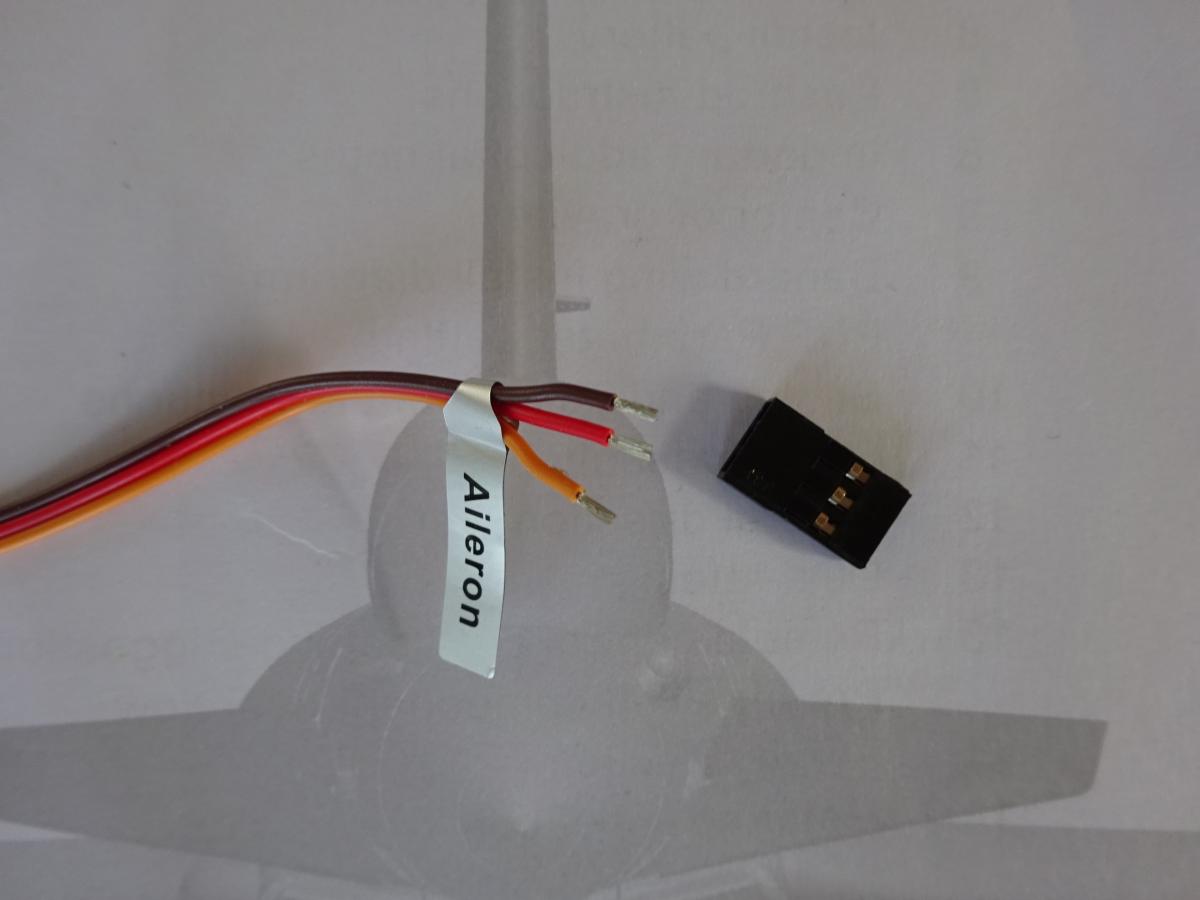

                                Please check your connection cables from the control board to the receiver. For me, the AILERON connection cables were not crimped, so they were loose!​ Possibly an isolated case, but a security check is always worthwhile!!!​

                                Bitte überprüft eure Verbindungskabel vom Kontrollbord zum Empfänger. Bei mir waren beim AILERON Verbindungskabel alle Kontake nicht gekrimpt, also lose! Möglicherweise ein Einzelfall, aber ein Sicherheitscheck lohnt sich immer!!!​
                                • A quick tug test to be sure is probably the best course of action
                                  • O wow. Have you told Motion or where you bought your? They should put a not on their web page to alert buyers. The same cable is on a ton of airplanes. This may be a one off but the possibility is huge.
                                    How much force did you use? None of the other ones you had were also bad? Just the one?
                                    • Hello Evan D,
                                      I think the best thing is the quick tug test to be sure. This is the first time this has happened in the many years since I have owned Freewing models. And I have about twenty Freewing models. So I'm assuming it's an isolated case. Nevertheless, you should be careful and check your models thoroughly before the first flight.​
                                      But to answer your question: no effort was necessary. You could simply pull the cable from the plugs on both sides. I also took the plugs apart. All crimp contacts were not crimped.
                                      All other cables between board and receiver were tight. As it should be.​
