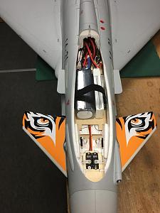

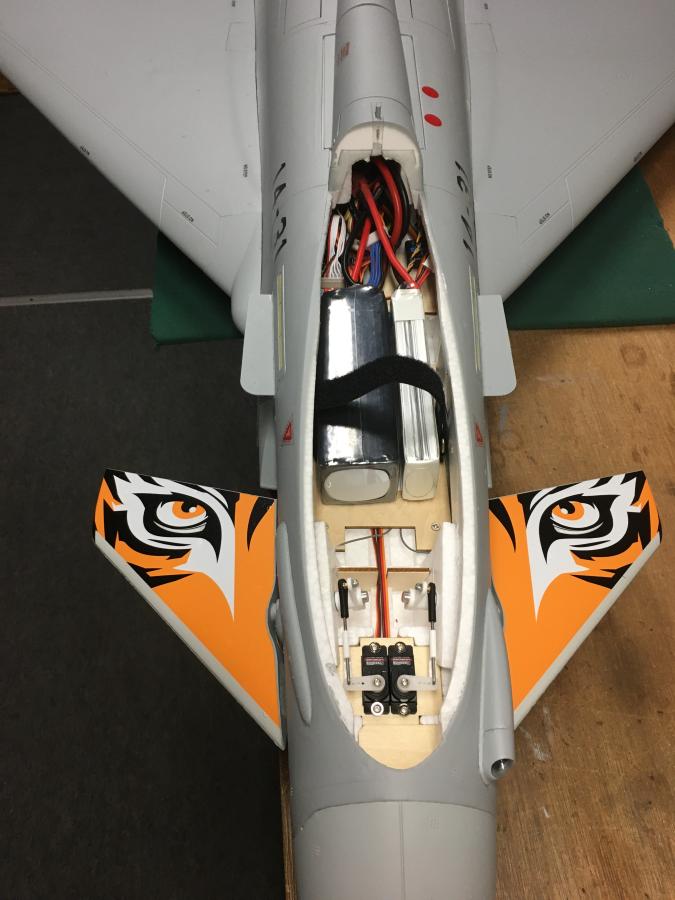

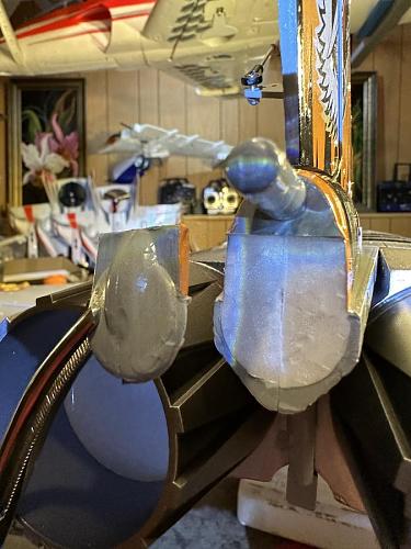

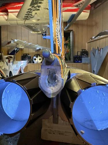

              Mine is assembled to the point weight and balance and set up is done.
              Mods. Well, not many. I did pull the canards off the mixing board and went to dedicated channels on the receiver. I did this to allow more freedom in mixing as I like a very full throw for air brakes. I also moved the pushrods to the outer holes on the canard servos. I also have separated steering and have a Assan steering gyro.
              Balance... Expecting a very nose heavy plane I bored a hole in the tail cone to allow TWO of the 21g slugs. One that cam e with this plane in the parts bag and a second I had removed from another plane. I then assembled the plane and I tried a 5200 that weighs 650g and a 5000 that weighs 575g. With the two slugs I am at 25mm aft of the marks with the 5200 and 30mm aft with the 5000. Good enough for me. I'm not one of the people that go cutting edge tail heavier and I don't use gyros as they do to help with their rearward CGs.
              I still have more decals to add and a spritz of lacquer to put over them and some final wire management, but otherwise she is done.

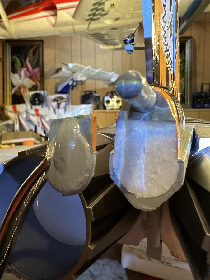

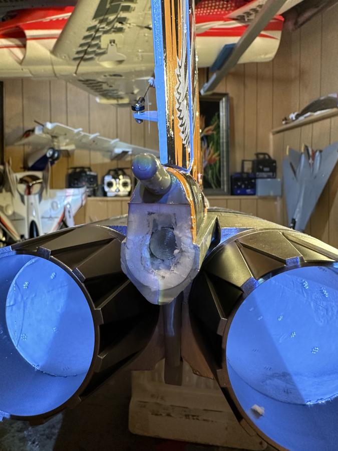

                        I bored a hole in the tail cone to allow TWO of the 21g slugs. One that came with this plane in the parts bag and a second I had removed from another plane. I then assembled the plane and I tried a 5200 that weighs 650g and a 5000 that weighs 575g. With the two slugs I am at 25mm aft of the marks with the 5200 and 30mm aft with the 5000. With a 6+2 8s side by side on the battery tray with the stock 6s fan it still balances just behind the marks.
                        Thinking ahead to 8S it is very easy to stuff a 2S up under the airbrake if need be, lots of room there.​ Click image for larger version

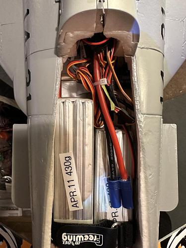

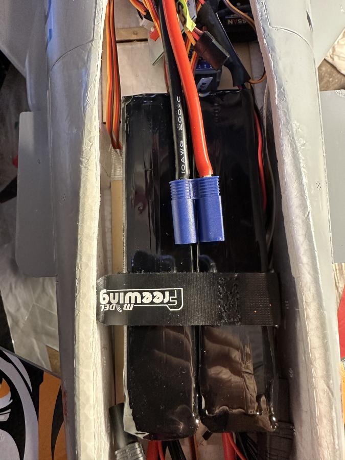

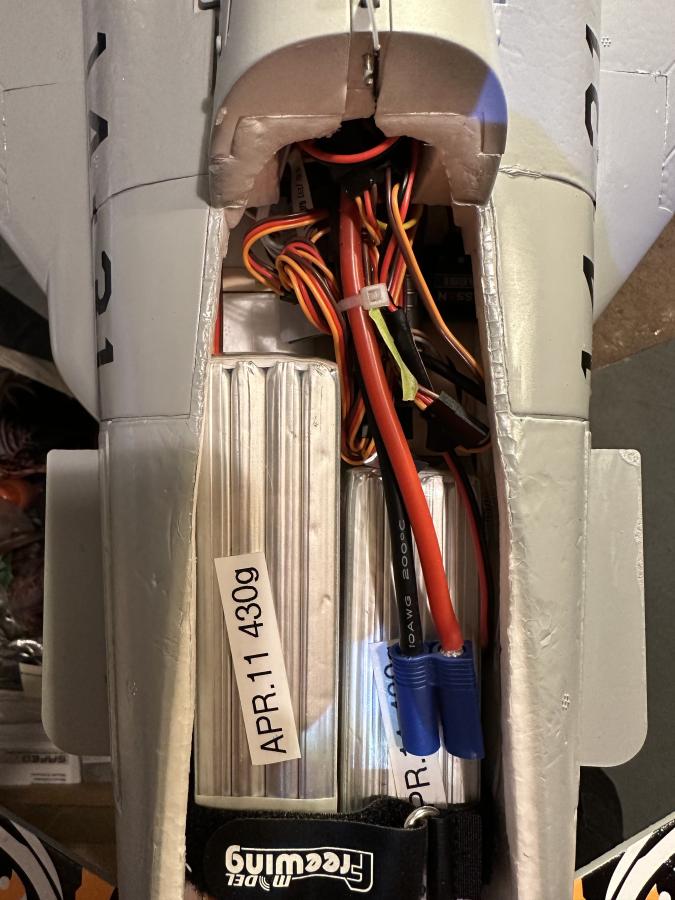

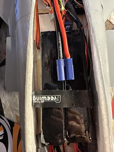

                                  When I posted that I didn't use the weight, I hadn't tried the SMC 5300s. I went to do a few last things to the Eurofighter and threw the SMCs in there just to see. I discovered I couldn't close the canopy if I slid one of the batteries up onto the lip like I could with the Coddars. They could only go side by side, both pushed up to the back lip. With all the ordinance on, it balanced on the CG marks. I'm sure it would have flown fine like that, but I really wanted it to back a bit to make landings more smooth and to be able do a little high alpha stuff. So, I decided to install the round slug that came with the plane PLUS another square slug that came out of an old dead plane. Both came to 43g and since this plane is already fairly heavy, I decided 43g wasn't a big add on and with them right at the butt end of the plane, they would have the most effect. The Coddars now balance this plane at 20mm aft of the marks and the SMCs at 10mm aft. Here are some pics showing where the batteries sit and a couple of the fairly simple surgery.
                                  Click image for larger version  Name:	IMG_4487.jpg Views:	6 Size:	81.5 KB ID:	373284 Click image for larger version
                                  Click image for larger version  Name:	IMG_4486.jpg Views:	0 Size:	85.6 KB ID:	373282Click image for larger version  Name:	IMG_4489.jpg Views:	0 Size:	86.9 KB ID:	373283

                                          I ended up installing 43g of weight in the tail cone (see my pictures a couple posts up). With the 860g Coddars (one slid up on the lip where the control box was), it balanced about 20mm aft of the marks on the wings. With the 1000g SMCs, it balanced 10mm aft.
                                          Please keep in mind that I'm using primitive methods of balance and meaurement - ie, my fingers, a ruler and a right angle (and "eye balling") to measure and place the new marks.
