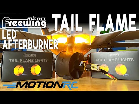

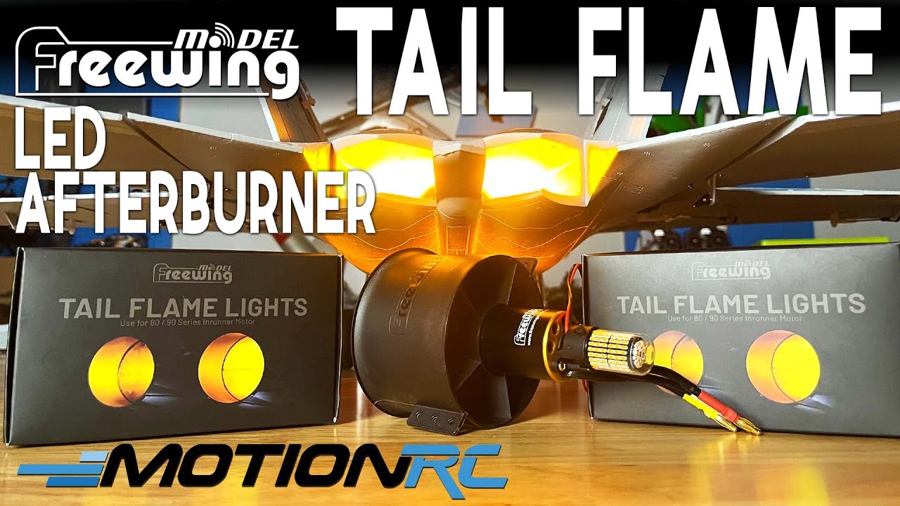

                  Did you see the afterburners that MRC announced today. They look neat. I watched Wes YouTube video and am confused as to which one to get for the 8s typhoon. Wes seemed to imply that the HP version would need the non freewing version with all the adapters. Any thoughts.
                    Yes, I saw them.
                    They're inexpensive.

                      Are you referring to this one:
                      My Typhoon came from RC Castle with one as a gift for them missing the original shipping date. It's already on my 8S fan. It came with a set of adapters. For 8S, you need this one:
                      https://www.motionrc.com/products/fr...-edf-jets-e632
                      I don't know why he said it's for non-Freewing EDFs. One of the adapter rings included was the exact one I needed for the plane. The main criteria for this particular plane is that the 8S fan doesn't have any holes on the rear of the motor, so you need to adapter ring to attach the light to. The 6s fan does have the holes, so you don't need the ring.
                        • 5401
                        #471
                        There are two versions. One that bolts to the back of Free Wing 80 and 90mm inrunner motors that have two screws. The other like you show is marketed for other brands or sizes of FW inrunners.
                        • kallend
                          • 1877
                          #472
                          The controller is fairly primitive - rather like what Gooniac was using 4 years ago - but at the price it will give Geek's $95 system a serious challenge. It uses a single lamp to drive both exhausts, which is sub-optimal.
                          Still, if I weren't making my own, it's probably what I'd use.

                            Well what do you know the one for the 8S is out of stock...
                              • 5401
                              #474
                              There are other sources...

                                    Yea Good to hear Tom . FYI Evan D I researched other sources for the 8s afterburner, RC castle has then but shipping IMHO is expensive At $11.20 minimum for Qty 1 No real discount for multiple orders.
                                    Ali express has them, shipping reasonable $4.85 for two but slower. End of month but that suits me

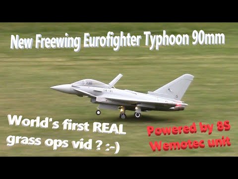

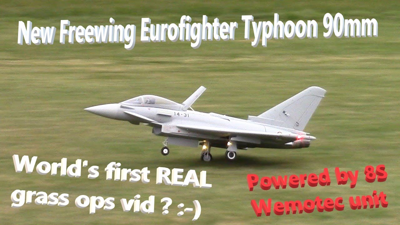

                                          #480
                                          Just maidened mine. Take-off from grass was very easy. Mine has a 8S Wemotec unit installed.
                                          This plane is really easy to land :)
                                          Full uneditted flightvid, enjoy!
