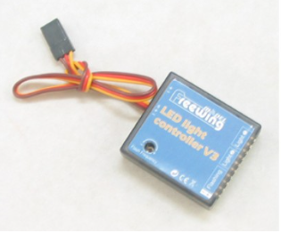

                          • It is the light control module that has the pot. Controls the flash frequency.
                            Originally posted by Evan D View Post
                            I remember those having an adjusting pot on them. I wonder if it was a V1 version. Might have been the accompanying light module back on the old F/A-18E and original Euro...

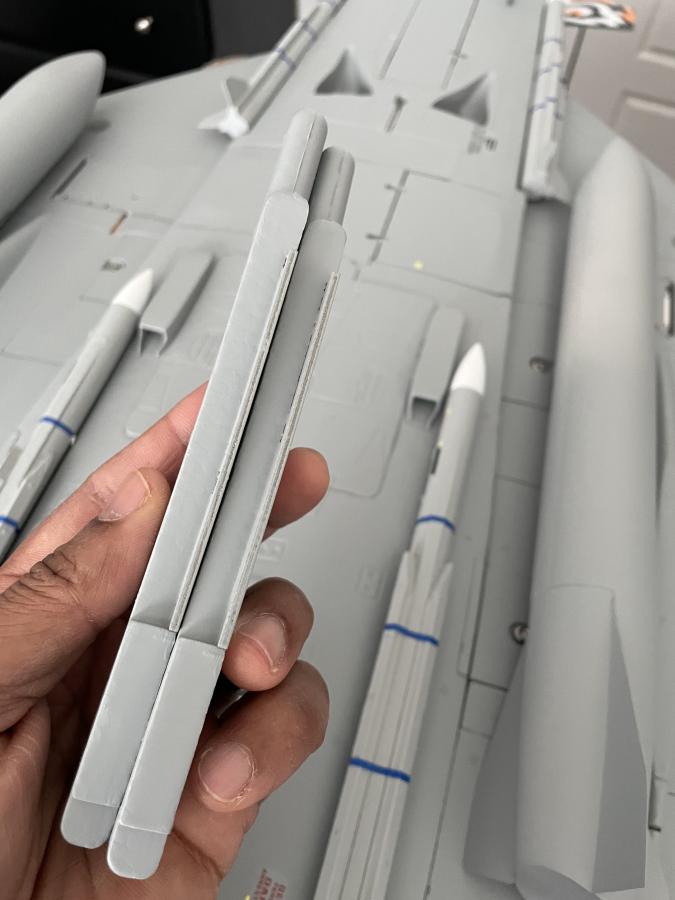

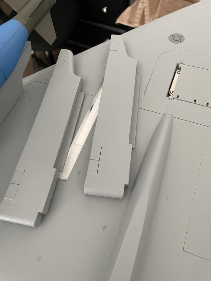

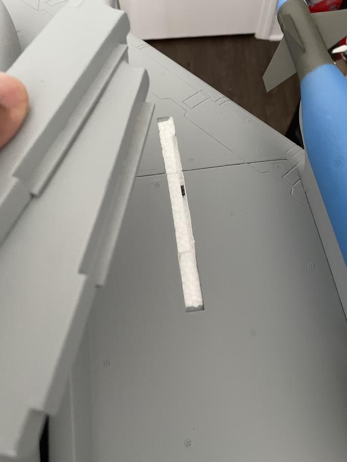

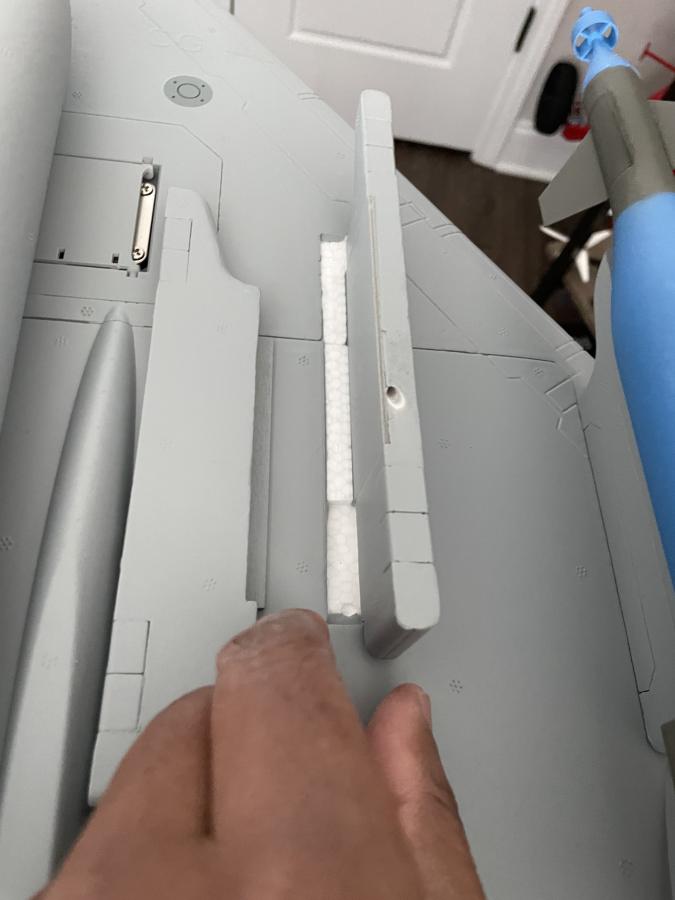

                            • Unfortunately, I got two right side rails for the drop tanks. It will be a few weeks before Motion gets any left wing rails in stock. If anyone out there got my left wing and I got your right wing, let’s do a swap.
                              • Interesting how close in size they are.
ID:	374262Click image for larger version
