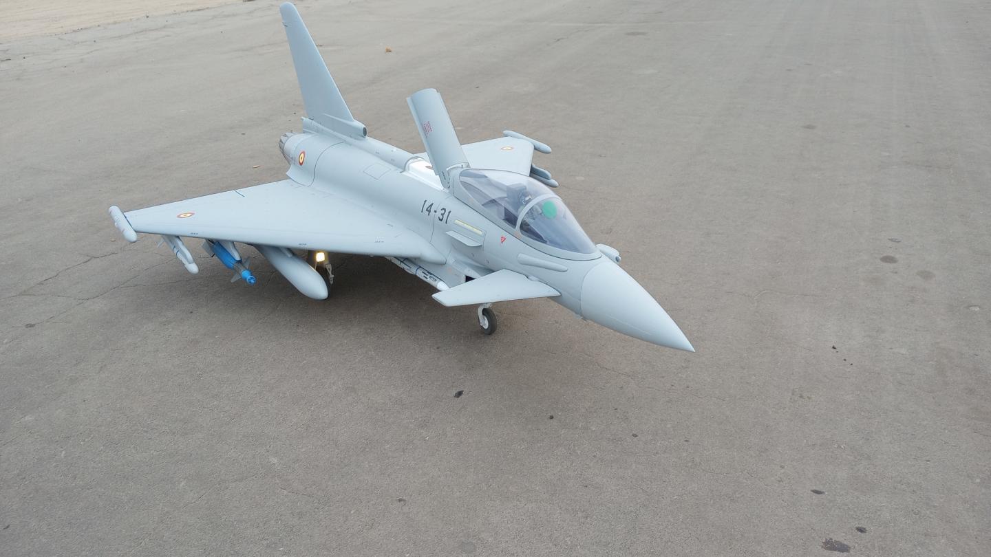

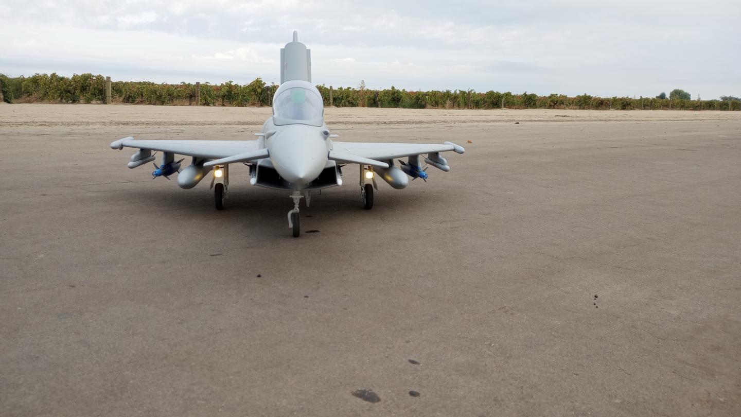

                                        Finally got me one, have 11 flights on it now, still messing with the weight in the tail and CG adjustments, flies great is all I can say and looks awesome with the ordinance which I do fly with, I just don't like flying empty.....
                                        Waiting on Callie for my Italian graphic kit coming soon I hope.
