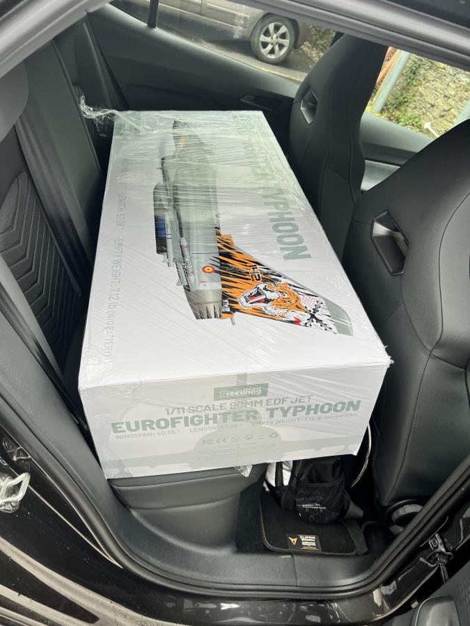

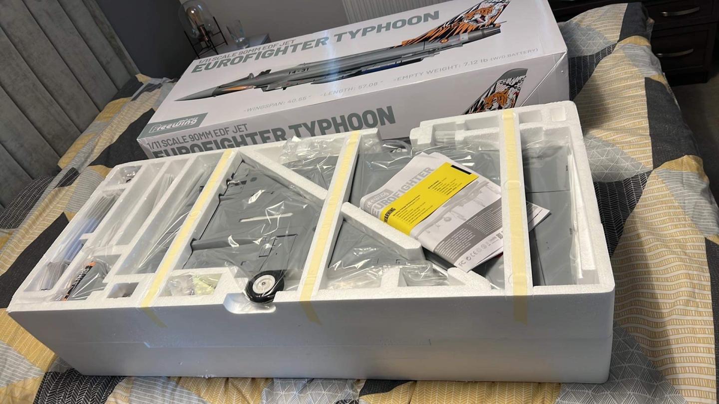

    Something exciting arrived into the UK today

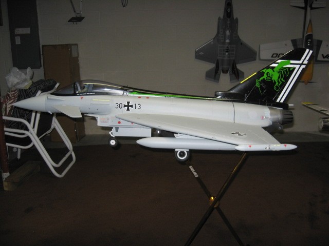

                        Here`s my scheme Guys. Callie grafics.

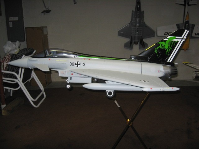

                          Here`s my scheme Guys. Callie grafics WHOOPS.

                            Looks good. Have you flown it yet?

                              Not yet Evan ,it`s to darn windy here in MI for us old guys!

                                      Gary I used Duplicote filler/primer gray on the decals, almost a perfect match. No I idid not sand any thing. I did us some automotive pre paint cleaner . The black is Rustolium Satin Black. As far as apply the decals I pretty much just take my time and don`t press down hard untill I am sure they are where I want them. Of course on this A/C scheme there are no hard curves to deal with!
                                      Hope that helps Drifty
