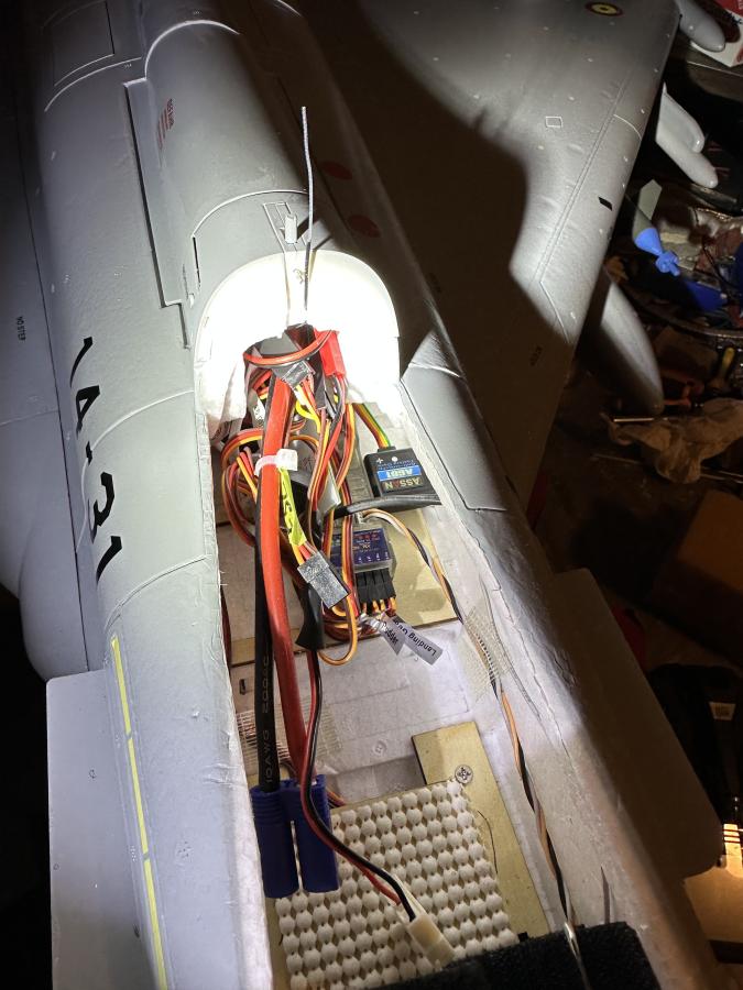

      Hi has anyone installed the Assan steering gyro in this model there seems to be plenty of room in front of the cunard servos... wiring it may be a challenge
        • 5401
        #563
        I have. Next to the mixing board.

          #564
          Great Evan I don't see your receiver in the pic, but that aside I see the two rudder outlets on the mixing board so I can tie into the steering servo but where did you connect the nose gear servo?
            • 5401
            #565
            The receiver is stuffed a couple inches behind the mixing board. I have a separate channel for steering so I can adjust center and throw independently. The nose gear servo plugs into the steering gyro output marked steering out or something like that. I do remember I needed a short extension on one of the leads, I'm not sure but think it was the one to the receiver slot. I have a 12ch receiver, using 10 of them, in it to have the canards on their own channels and the extra one for steering. In case anyone also wonders I have a satellite under the battery tray and you can see the two antennae from it coming out at the front of the battery tray.

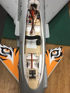

              #566

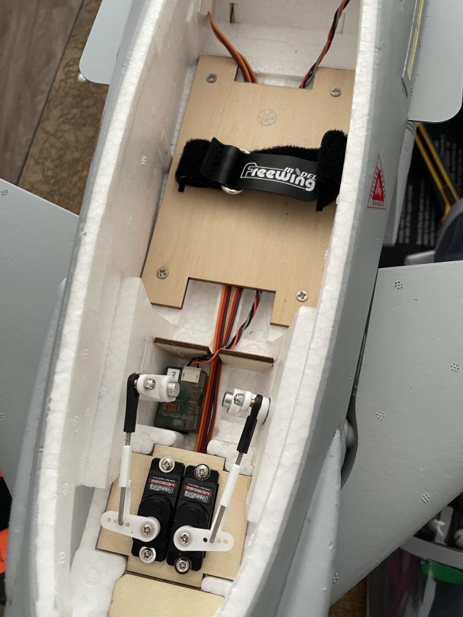

                #567
                I got the 8s model and it’s nose heavy. I’m using SMC’s 5300 mah, LiHv packs for max power. They fit perfectly with room to spare. However I had to add the provided weight and 60g of additional weight to give it the ideal CG slightly aft of the recommended.
                I cleanly cut off a covering panel. I then drilled a hole large enough to hold the weight. I added foam tac to the last stack of weight and then sealed it all up. Looks so good that you’ll never know it was ever modified.

                    #569
                    That sounds about right and exactly what I did. Also using the same batteries you're using. With only 43g of weight, I'm balancing about 10mm aft of the marks. How far aft is yours?
                    I'm about 15mm behind the CG with the battery against the wall. I now have a bit of wiggle room to move the batteries up to hit the recommended CG, or back for a bit more high alpha. I actually added one more weight than what shown in the pic for a total of 60g in addition to the provided weight. Since I had extra room, I added the weight. In this case it's better to have the weight and adjust the battery later than to want the weight and wish I added before buttoning it all up.

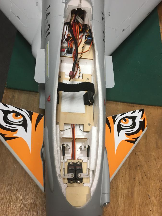

                      • 5401
                      #570
                      I bored out the stinger from the inside before gluing it on and put 42g (two slugs) in it.
                      Balanced about an inch behind the marks it’s just a little nervous in flight, no gyro, blustery day and cross wind here today. All flights done clean, no stores. I think 35-40mm will be the sweet spot for those that like a rearward balance and 30 for the mere mortals. 4 minutes on a 6S 5200. It for sure is not like the old EF.
                      The rates in the manual are probably a great starting point and where a lot of pilots should be happy. As Jon has noted a few times the landing gear take forever to go up and down. Up isn't that much of an issue but down is. I'll separate the retracts and doors on my radio.

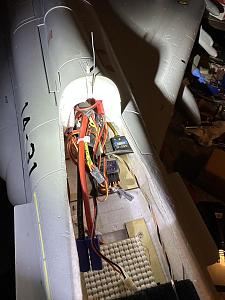

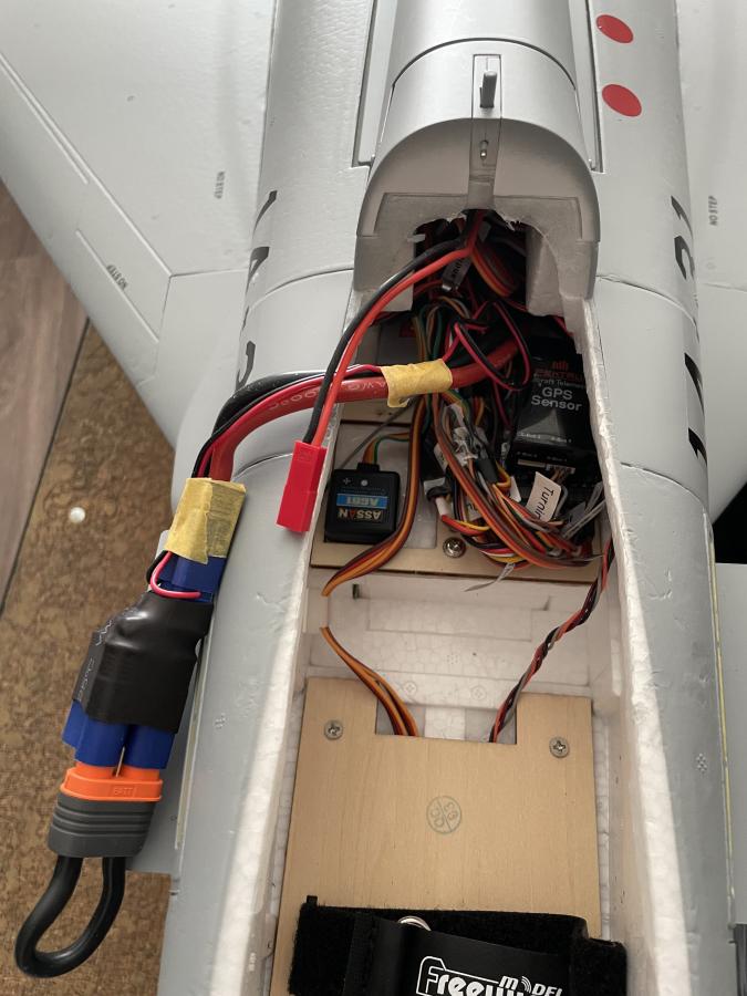

                                    #577
                                    Getting closer to being done with this setup.
                                    Satellite receiver in the nose, control board under the air brake, steering gyro to the left of the receiver, voltmeter spliced with EC5, burner power lead, and gps on top of the receiver.
                                    There is really not much room for activities in this 90mm, which makes the Spektrum receiver (AR10360T) my go-to yet again since the gyro and telemetry is all in one box.

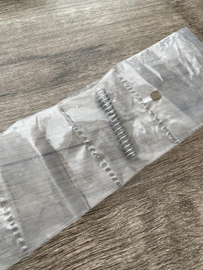

                                      I understand the weight included from the manufacturer, but does anyone know what the added spring is for?
                                        • 8814
                                        #579
                                        Apparently, it's for the nose strut - a different spring rate.
