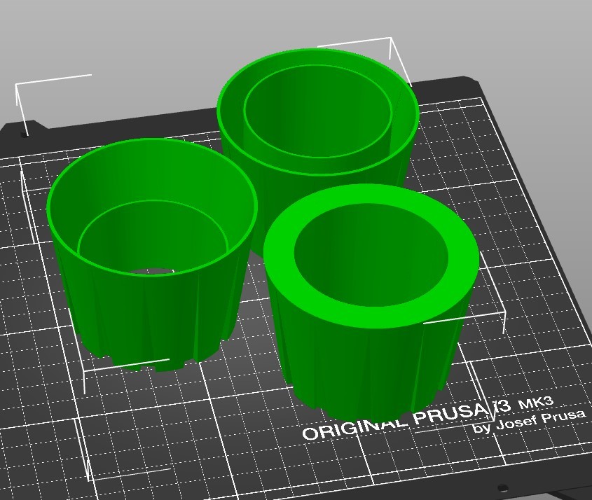

Just in case someone can't wait. 55mm exhaust diameter. Three different versions:
1. Simple Replacement
2. Lengthened thrust tube. The hollow can be filled with additional ballast. "Foam bearer" on fuselage needs to be removed.
3. Solid version."Foam bearer" on fuselage needs to be removed.
https://cults3d.com/en/3d-model/vari...hter-v3-nozzle

You're welcome. Check these out, I'm glad to make changes when needed!

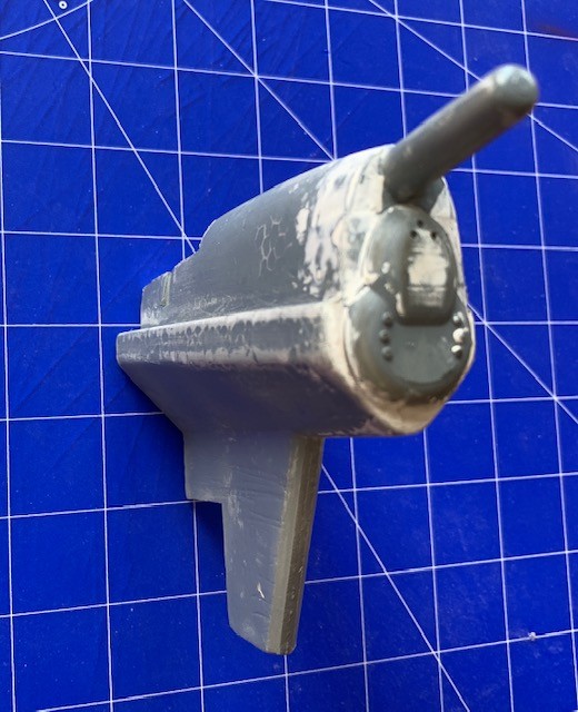

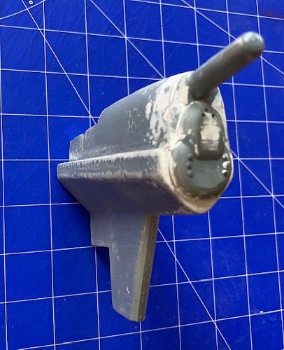

Here's another thought regarding tail weight. It's possible to add ballast into that tail body between the nozzles. I've already designed a slightly nicer looking replacement for the "drag chute hatch". I will make the entire rear-looking face as a 3DP part, so it would be easy to remove foam inside, add ballast and close it again with that part.
