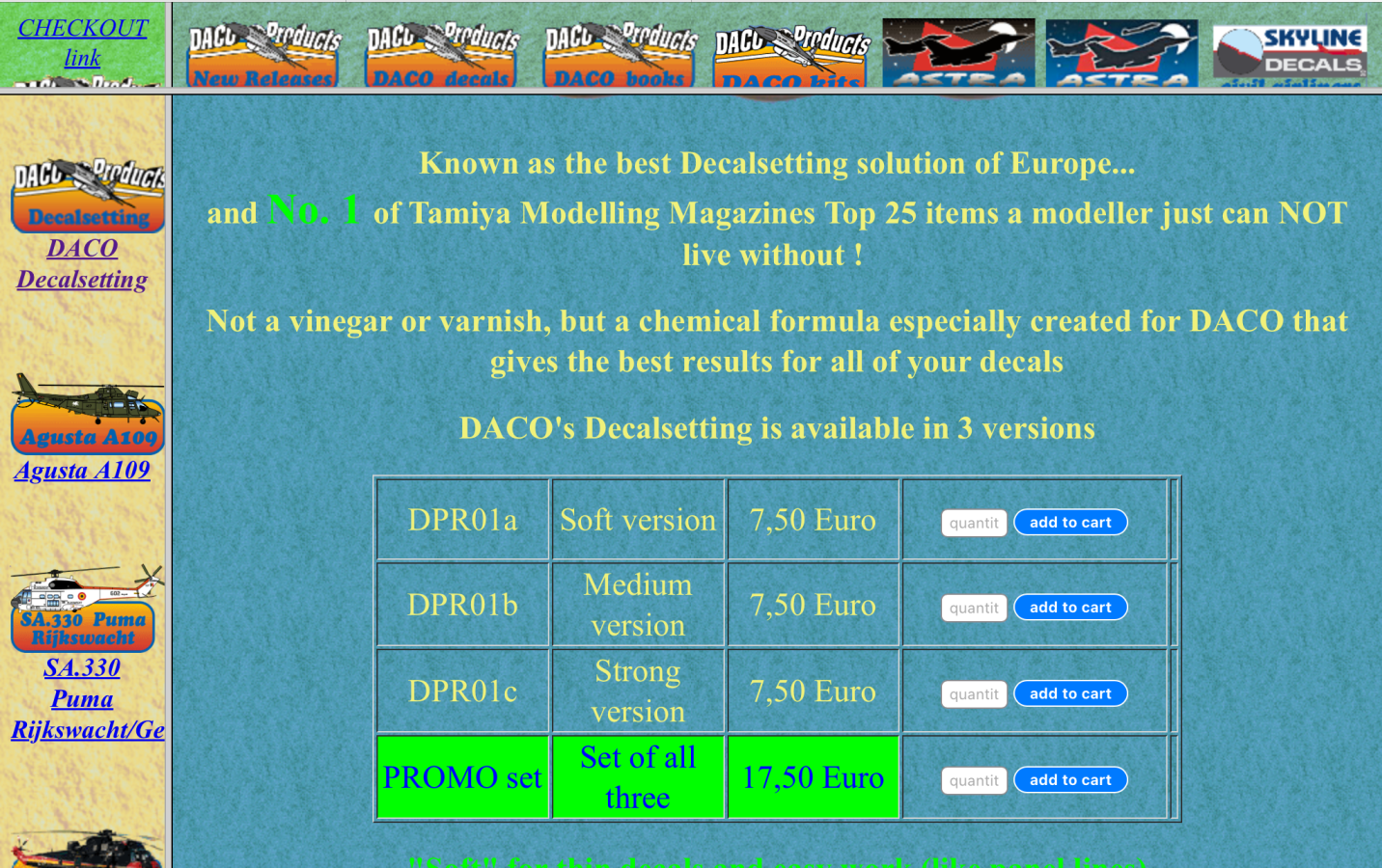

                  Best buy some setting solution.... Any recommendations

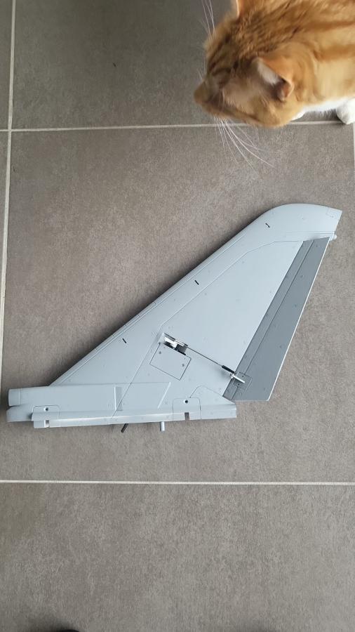

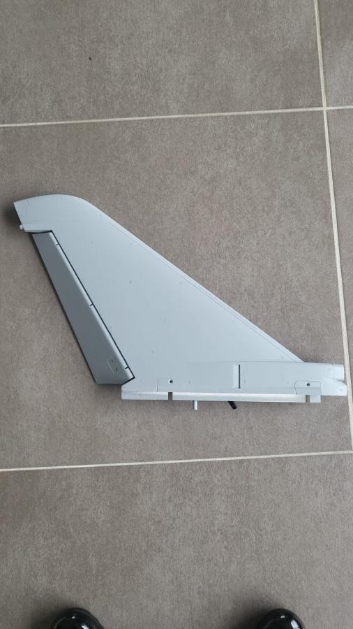

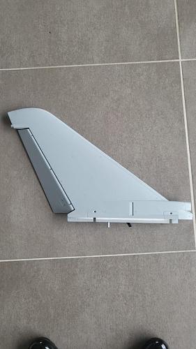

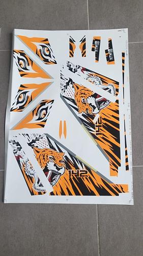

                    Guys, my Eurofighter was delivered an hour ago. Luckily no pre-applied tiger decals on the tail! Click image for larger version

                      What about the decals on the fuselage that are the continuation of the tiger stripes?

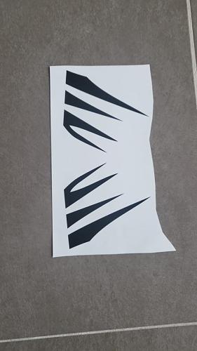

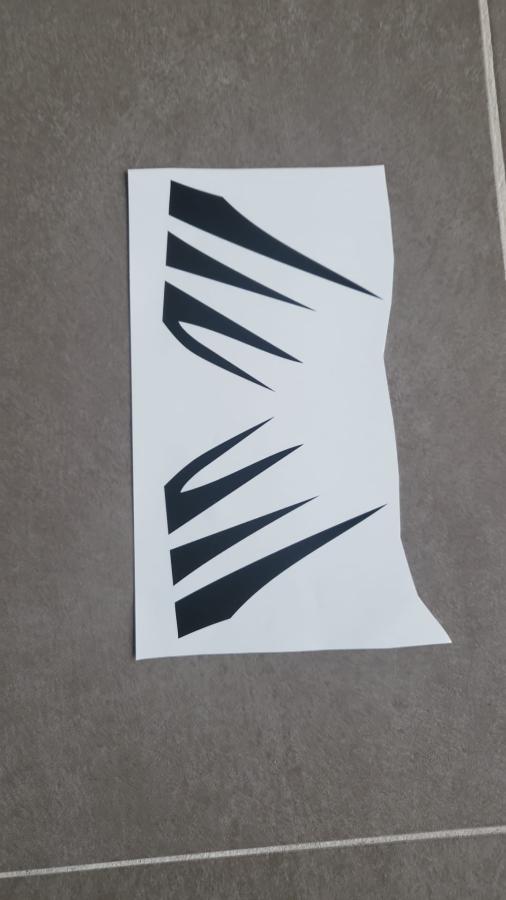

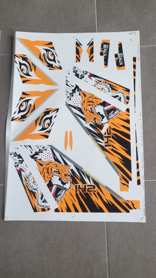

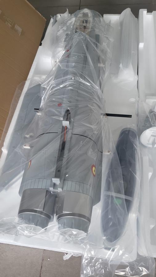

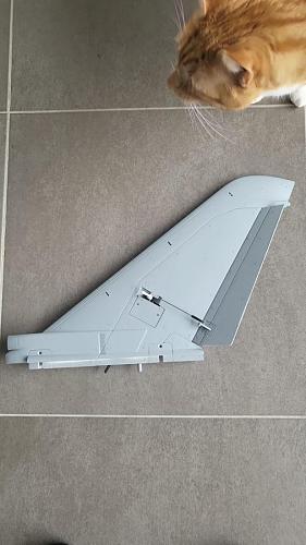

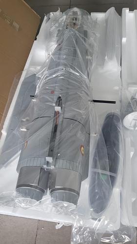

                            Some more pics Click image for larger version

                              I wonder can the Spanish roundels be removed? would make life a lot easier to convert to an RAF model
                                • 5401
                                #375
                                Much easier to paint over them.
                                • BenOzzy94
                                  ground magnet extraordinaire
                                  • Jul 2020
                                  • 98
                                  • Kerry, Ireland
                                  #376
                                  not when you live so remotely that there is no one to mix paint for you, and you have no painting gear at all.
                                  I'm also very picky and wouldn't want to see blend marks so would have to repaint the whole model.... if I can remove 2 circles from the plane with either warm water and dish soap or sticky tape or something, It would be a lot easier than buying a compressor and gun, paints to mix, masking the model and repainting the entire thing
                                    • 5401
                                    #377
                                    I'm 99% sure it will be impossible to remove then with water or some similar way without ruining the surface paint.

                                      It‘s not used for applying the decals. Use your preferred technique here. Once the decal is on the surface and the top surface is dry, apply the DSS (using a soft brush) and let it work. It‘s going to soften the decal, so it will ‚sink‘ into panel lines and with some care it can be wrapped around ‚difficult‘ corners.. Don’t touch the decal during that time!
                                      The FW decals are usually quite thick, so use a ‚strong‘ type.
