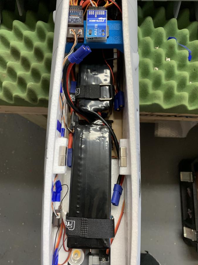

          What brand of battery are you using? I have Turnigy Heavy Duty 5000's and I can't close the canopy at the front. I have to use my Gens Ace and Admiral 5000s.
          I’m running hobby star 6200 50c batteries. I turn them on their side so the short side is facing up. I can’t remember if i trimmed any foam from the canopy but I don’t think I did. If I did it was just a very small amount. I don’t have any problems getting the canopy fully closed.
          I did have to move the control board back to the rear holes and use dirty dees receiver tray so i could push the batts back far enough back to get the correct cg.
            Thanks. My board is hanging loose at the far back among the wiring. They all seem to hold each other quite firm.

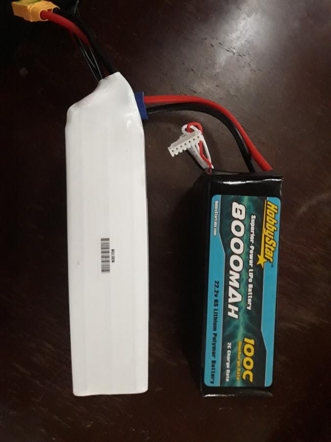

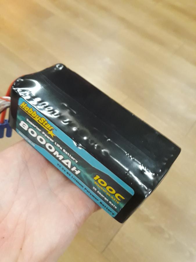

                      I really love the hobbystar batteries, they are much lighter than most of my other batteries. I'm flying an 8000mah 6s 100c battery in my Venom right now, and if they ever come back in stock, I'll be purchasing another so that I can fly the pair in my 80mm A-10. If not then I'll probably just put two pairs of 4200mah 6s 40c's in the 80mm A-10. The 8000mah in the venom gets me 6 minutes of flight time landing with 3.8volts per cell. I am currently flying my 80mm F-5E, with a pair of 4200mah 6s 40c's and loving the 6 minutes I'm getting out of her! Just look at the size difference between CHNL 6000mah 6s 70c, and the Hobbystar 8000mah 6s 100c, and the Hobbystar is lighter with 2000mah more!

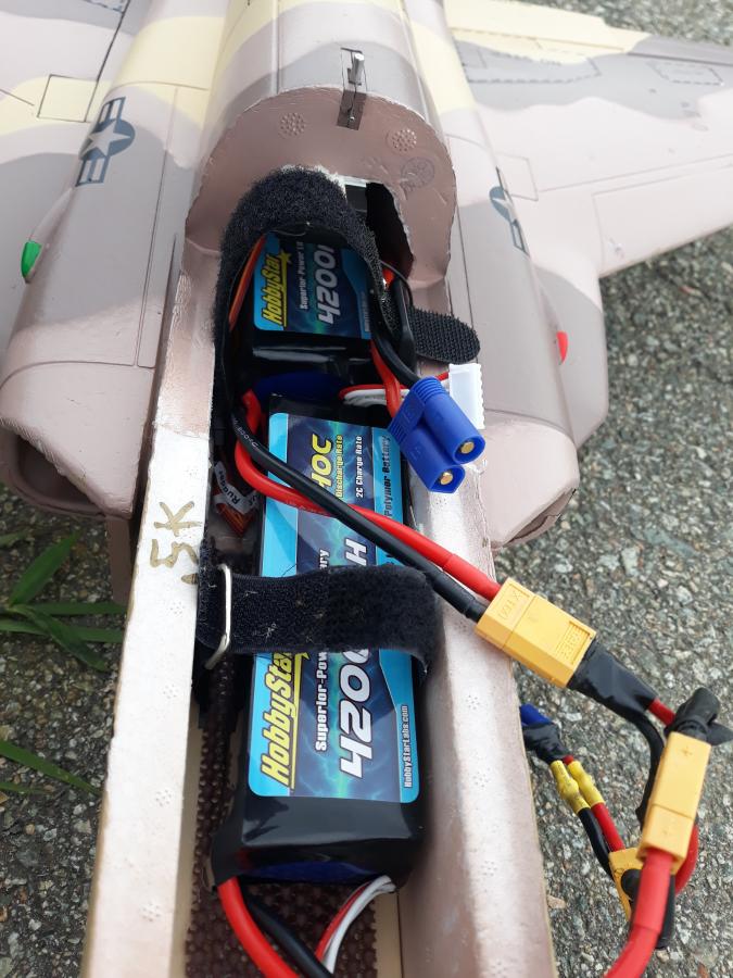

                          Why not go bigger mah for the A-10?
                          I was looking at the F-5e today. Is your 12s? since you say pair of 6s.
                          Bigger than putting either 2 x 8000mah in the A-10, or 4 x 4200mah in the A-10? From my experience with the A-10 weight is no big deal, as long as you can CG it and don't run out of space, I'd load my puppy up with as much mah capacity as I could! Bigger than 8400mah you say,... what do you have in mind?
                          My F-5E Is running two 6s 4200mah 40c batteriesin parallel. 6s power, with a total of 8400mah on board.

                                Sorry I missed the part of you buying another 8000 mah and was questioning why run the smaller 4200.
                                woukd you mind sending me a picture of your battery load out for the F-5e? Been eye balling it
                                Thisguy65, PM and pic sent, let me know if you'd like any more. CG is 7mm behind what the book calls for.
