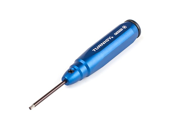

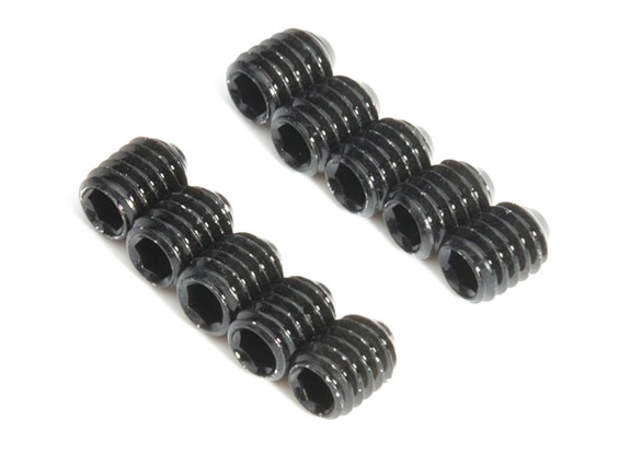

      Thanks for the pointer OV10! I thought I was going crazy with the loose fit, but your explanation makes sense now. this is my second FW bird with bad grub screw fitment, and the second time my allen keys have slipped and rounded it just enough to require an extractor tool. I'll try out the soldering iron trick before I use the extractor on this one.
      I got a lifetime supply of different sized grub screws from HK awhile back, as well as their Turnigy drivers, and the quality and fit is very good (and I'm not big on a lot of HK stuff). No more slipping allen wrenches! :Cool:
      The Turnigy V2 range of drivers: comfortable, high quality, precision tools at a price that can't be beaten.
              https://hobbyking.com/en_us/turnigy-...mm-x-60mm.html
              https://hobbyking.com/en_us/metal-gr...10pcs-set.html
              Tom
              This is a great fix Tom...thanks! So M4 = 2.5mm? Rob

                  As Janmb says- not necessarily. I 'd just order a variety of sizes of grub screws and keys or drivers (if you need them) and you'll be set for any scenario down the road. Replacing the stock (cheese-like) grub screws that come in these (and many other) retracts makes things a whole lot easier.

                        Thanks guys! I've had a lot of strut changes with my FW Stinger 90 and in the process went through several stripped set screws...particularly the little one that fixes the pin to the retract. This helps and I will get after market screws to replace them all! Rob
