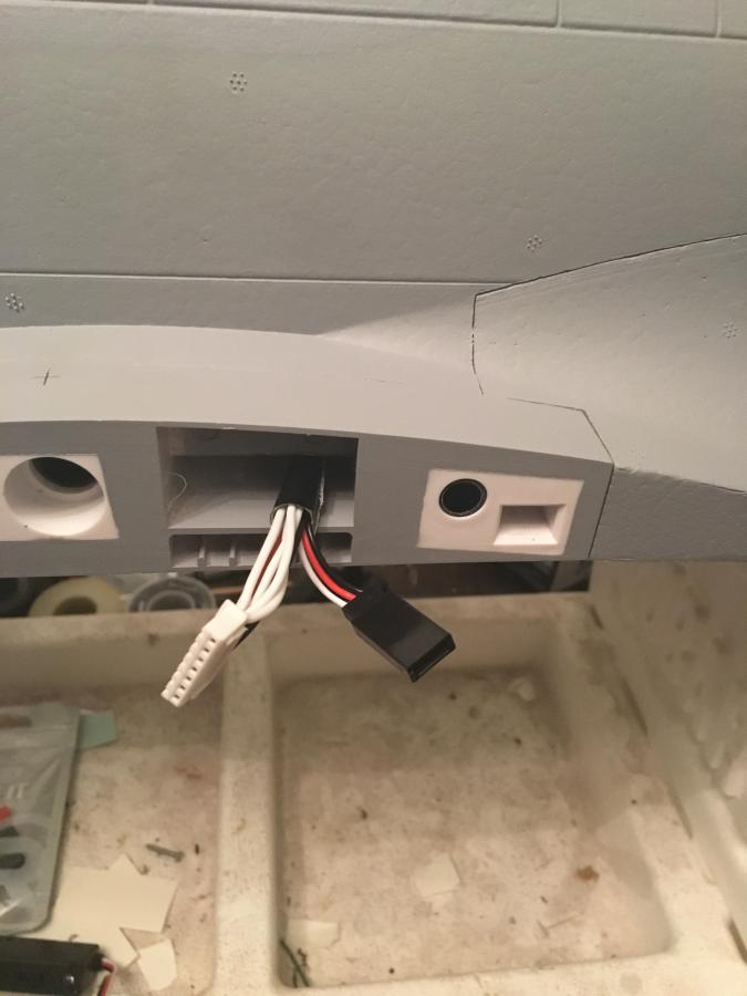

                                          On my aileron-glitching A-10, I did some circuit simplification for the ailerons. I disconnected the aileron servos from the wing-interface connector. Wye'd the aileron servos together, bypassing the integrated circuit board, and connected them directly into the AILE port on the RX. In the front yard, I ran my throttle up to about 50% and cycled the ailerons for a couple minutes, and saw no evidence of glitching servos. Yea! Looks like I don't have to rip an aileron servo out of a brand new wing. :-)
                                          So, now I have two connectors per wing, instead of one, but I am good with that and avoiding a bunch of potential bad-solder connections.
                                          Click image for larger version  Name:	439EDBD1-3F91-44B8-A34B-8B426D9686CF.jpeg Views:	1 Size:	44.9 KB ID:	124585
