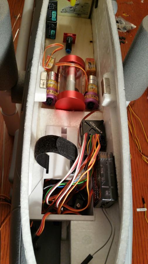

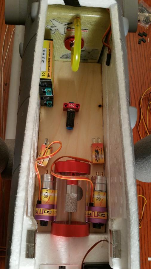

                        Pardon the French, but HELL YEAH.
                        In the meantime.... lol

                          Very cool, but a lot of work!!!! It should be great!

                            Wow, quite a clean project there. Cound not help but notice the cortex. I just started flying air plane flight stabilizers that work very well this winter in a EF Turbo bushmaster. Amazing how these electric gizmos work so well together now. I can’t control the wing rock of my A10 but know a decent flight controller will help.
                            Have you flown the A10 with and without flight stabilization? Electric or turbine version.

                              Starting to take shape Jan... great job on the tank install, was wondering how you would go with that. Looks heaps of room still for your powerbox etc. Gotta say I'm really looking forward to vid of it flying.

                                I'm wondering about the c.g. Without the batteries to balance and the turbines probably being heavier......Hope that works out O.K.

                                      Hardway: Thanks :-)
                                      John2kx: Yes, I have flown mine both with and without a gyro. Installed it primarily for nose wheel, but cleans up flight in bumpy conditions too. About 20 flights without, another 145 with. Only electric this far (on this model)
                                      Shirty: Thanks, me too :-)
                                      downwindleg: CG is a bit of a challenge for turbine A-10s in general, for the exact reason you mentioned. The important thing is to keep turbines light and as far forward as possible (why I use thrust tubes rather than aft mounted turbines), and move all the other fixed payload as far forward as possible (in my case the air trap, pumps and batteries). My turbines weigh less than the fans + escs. CG will be fine, with auw about the same, probably a little lighter.
