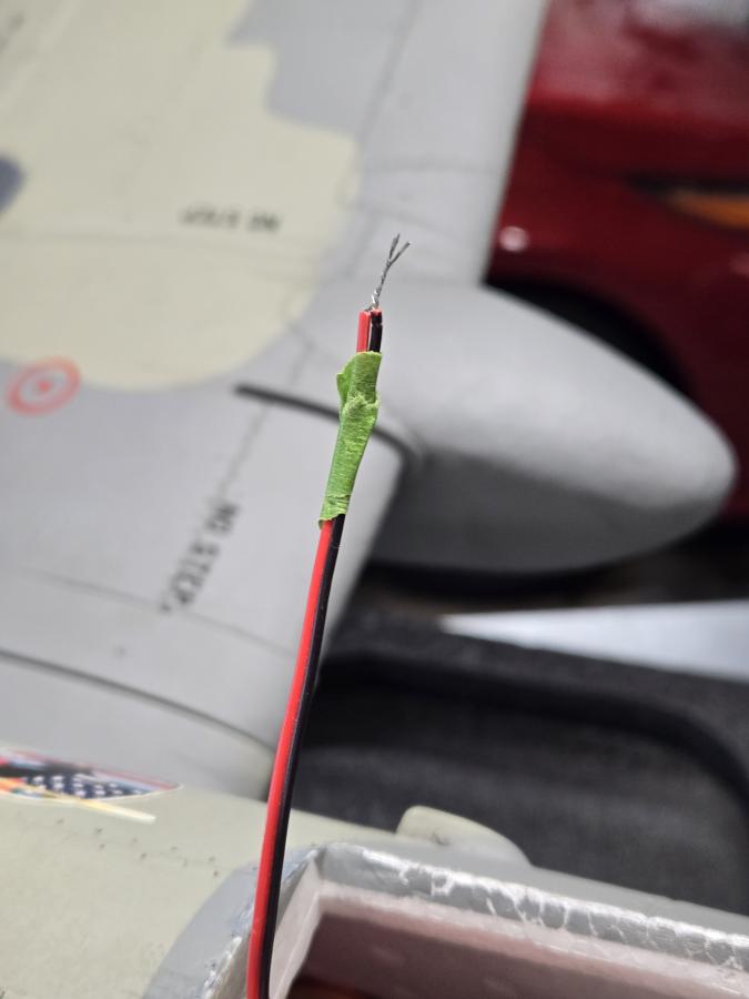

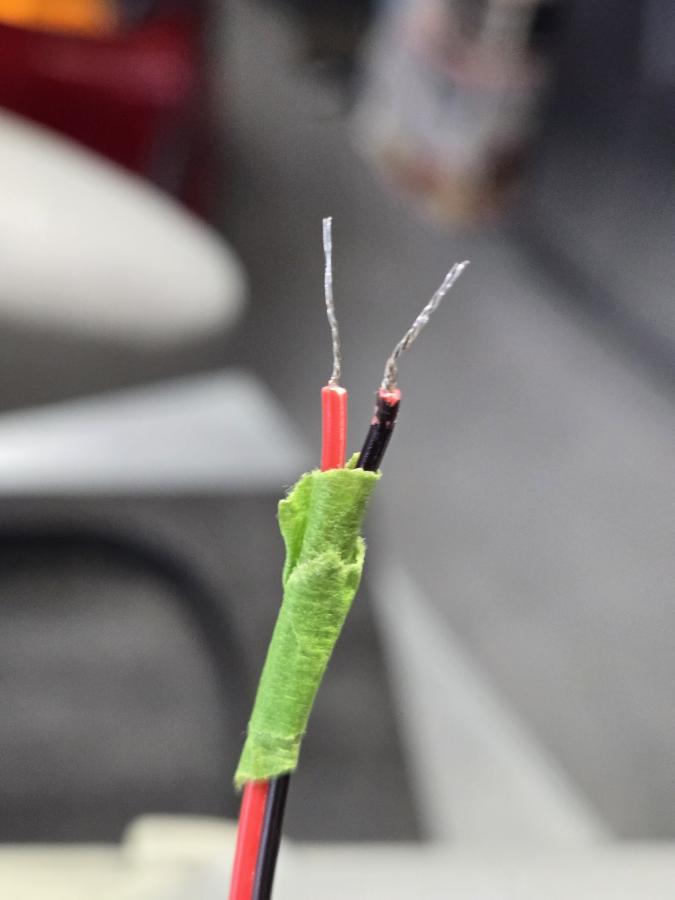

      Hopefully, this is where I should be to ask the following question/s related to a V1, A-10 Thunderbolt II, twin 80mm. Said A-10 was recently purchased from the original owner. At the time of the purchase said A-10 had not been in the air for 1.5 yrs. While going over the A-10 several items have been inspected/repaired. During this process a single, two wire bundle (red/Black) was discovered which seemed to have no function (see attachments).
      The wire bundle goes into the fuselage from the battery area and doesn't seem to exit at any point along or outside it. Strobe and wing tip lights all work and are connected to the main wing control boards and the main control board. There is no power at the exposed wires of the bundle.
      Wondering if the fuselage strobe lights (white/tail and dorsal) are supposed to work separately from separate power leads or off the same power lead from the control board? Currently they are working together off a single power lead originating from the control board. The user manual doesn't help much.

        Can you follow that twin wire further back into the fuse to figure out where it ends up? If it's not a light, it may have been intended for powering a UBEC. Does the RX power up when you plug the flight batteries in?

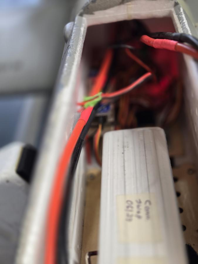

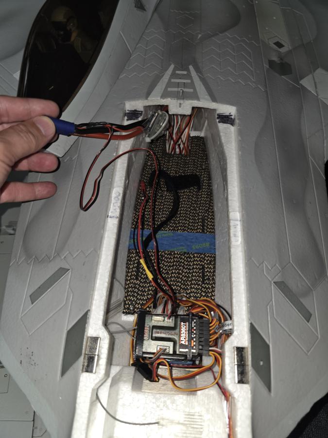

          No, it does not appear to be an old UBEC bundle. The UBEC the plane was originally sold with is spliced into one of the main power leads (lipo motor wires to right motor). The RX is receiving its power from the UBEC as originally designed and it does power up when a lipo is brought online. Everything is working (flight controls / landing gear / etc.). All the lights on the plane also function. Thought maybe the bundle was originally a power lead to one of the two white strobe lights.
          I have followed the wire bundle from the battery area back behind the main control board to the cavity/area where the power leads to the motors break out. Tugging on the bundle moderately produces resistance. I have not tried to pull the bundle free. Thought maybe I might be doing too much harm.
          Do you know if each of the strobes were wired separately in the V1? Don't think they were, as the control board does not show any more connection points.

                A good guess, however, reverse thrust is generally a single yellow wire. In this case, there would be 2 single yellow wires that can be Y'd together. A red/black twinned wire is generally to supply power to something, usually an LED light or something like a JP retract system. But then again, the previous owner may have used a red/black wire to try to simply things for 2 reversing ESCs as those wires were twisted together in the 1st/2nd photos.

                    Yes, RCACI8TOR I have removed the nacelles (repaired / improved the motor wiring). The red/black wire bundle does not appear in this unit or even at/on the exposed area where the nacelles were. A closer inspection from the battery compartment seems to show the bundle disappearing into the area where the two wing wiring bundles enter the battery compartment and subsequently attached to their respective boards.
                    This plane has no reverse thrust ESCs.
                    As indicated earlier all the systems on the plane are functioning properly. Given that they are, I'm going to leave everything as is for now (just because). If all goes well and I don't turn the plane into popcorn on the maiden, I'll jerk the wire bundle.

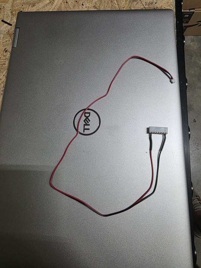

                      The only other thing I can think of if it hasn't been mentioned is the battery voltage monitor lead that comes with Spektrum receivers. I use them on all of my EDFs as a low voltage warning in leu of my timer. Looking more closely to the picture you provided, the wires appear similar to what I install on my planes. Just a thought. Click image for larger version

                          I absolutely agree with RCAVI8T0R , the previous owner must have been using a Spektrum Telemetry RX. I use that wire on all my aircraft as he does, although I splice the open wire leads directly to one of the battery cables going to the ESC and the other end is a JST-HX female plug that plugs directly into the "Voltage" male plug on Spektrum RX Telemetry receivers. That gives me total voltage, so for 8S I fly down to 29 Volts, and for 6S down to 21.9 Volts (knowing that the voltage readings are below what the battery will be at rest with 3.7 volts per cell, or 22.2 V for 6S and 29.6 for 8S).
                          Mr. A V 8 Tor just hooks the balance plug to his pack and is only reading 2 cells, so his warnings probably come at 7.2-7.4. (Or do those 2 wires connected that way read total voltage 🤔) But then he has to plug in the balance plug each time he installs a new battery. On the other hand, mine is always hooked up so no additional work required. Additionally, I use the balance plug on my batteries to power my Afterburners with a similar rewired female balance plug with just two wires (only across 2 cells) connected, giving 2 S power going to my Afterburner controller, for both 8S and 6S. Tomato Tomahto. 🤣

                            Hugh, I built the voltage plug to "swap" over to multiple 6S planes instead of splicing into or de-soldering the ESC battery plug on my planes. I am able to read the total voltage of my packs since I am using the negative lead and the 6th cell lead of the balance plug. For the planes that I cannot access the receiver easily, I do hardwire the voltage lead into the ESC battery wire. I use an additional 2S 450mah pack to power my afterburners for the planes that have them installed. I did have a sound card installed in my A-10 for just the "brrrttt" sound which is powered by a 3S 1500 pack. I keep the flight batteries for just the ESC/motors. I had a bad experience with my F-14 using one of the packs to power additional add-ons and learned really quick it does not fly very well with just one motor 😁

                              #11654
