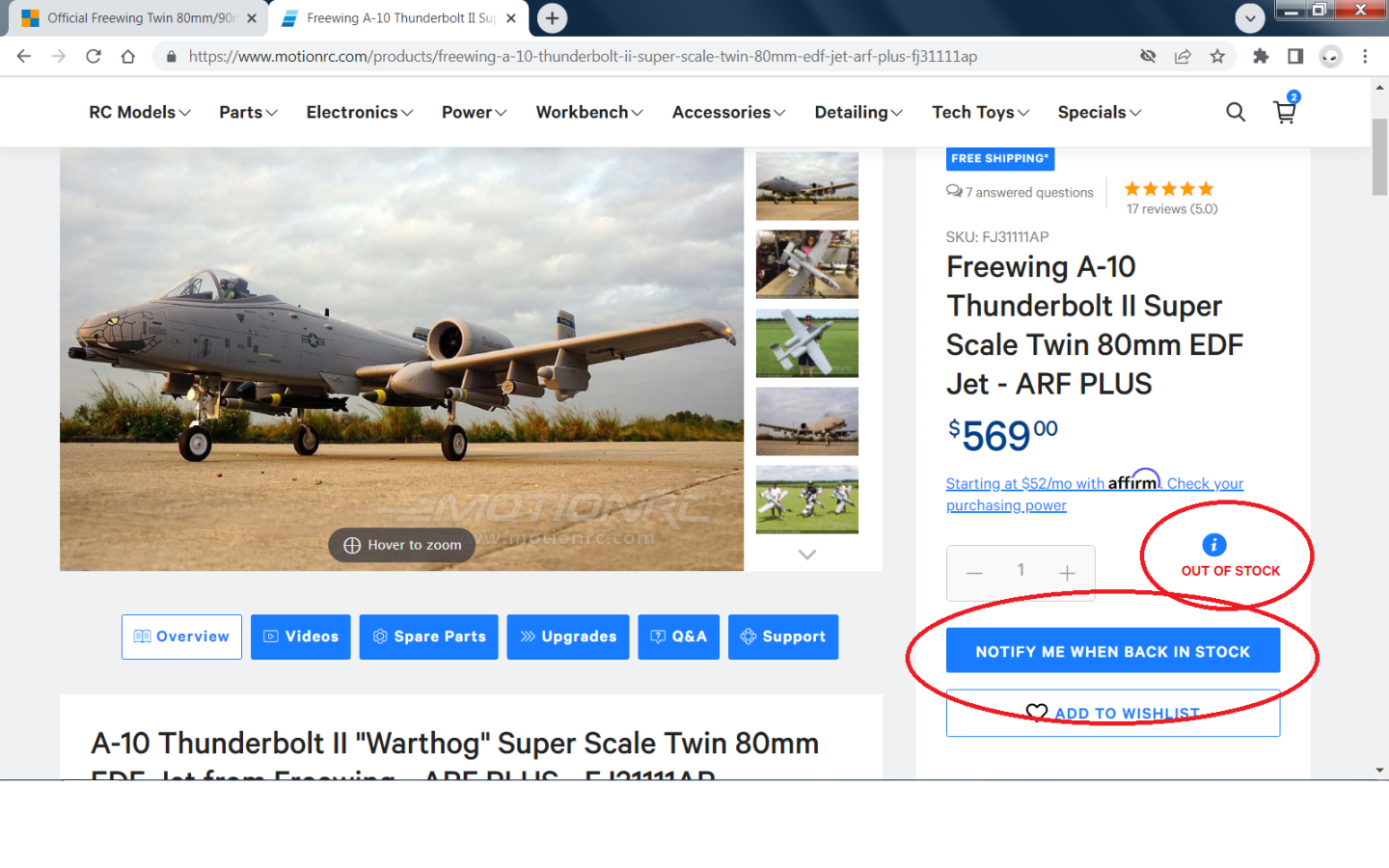

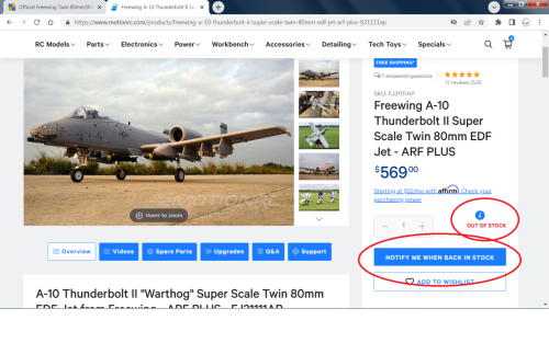

                                        • 4875
                                        #11579
                                        stitch
                                        Out of stock means out of stock.
                                        Notify me when back in stock is your clue.
                                        Best, LB
