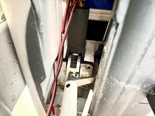

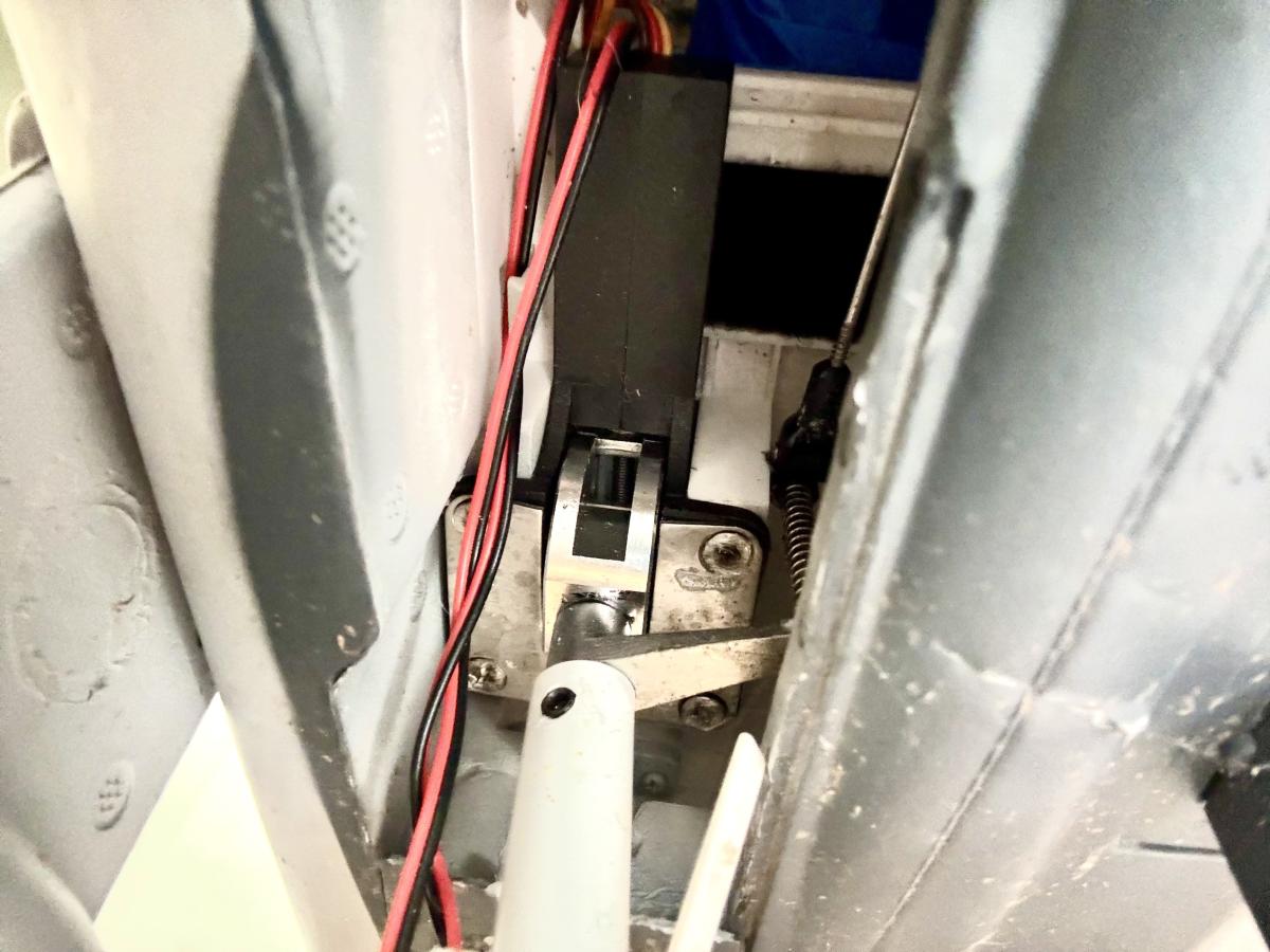

                                    #11637
                                    Needed to change the the bent rod after a firm nose bounce. I notice there is quite a gap between the top of the strut and the retract body. I must not have noticed it because where the grub screw has marked the axle is in the same place but the whole nose leg now rests on the gear grub screw ! If I try to push the strut further onto the new pin, the rear sliding strut then will not attatch to the nosewheel.
                                    Perhaps i never noticed it but is that gap on anyones A10?
                                    Thanks
                                    • GliderGuy
                                      • 1416
                                      #11638
                                      Click image for larger version  Name:	IMG_0780.jpg Views:	0 Size:	106.8 KB ID:	449803
                                      Thanks
                                      You seem to be missing the steering arm that goes in that space. See my photo above and link below.
                                      Buy Freewing Nose Gear Steering Arm N527 online at Motion RC. Order online with fast delivery.
                                      She’s not gonna steer without the arm being present and connected to the nose steering servo.
                                      -GG
                                      • 400driver
                                        • 59
                                        #11639
