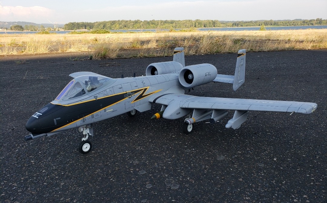

            My A-10 painted, this is a sweet freaken jet. Highly recommended :)
              #9626
              Nice paint job! And I agree, this is by far my favorite EDF ever, with the F-22 a close second.

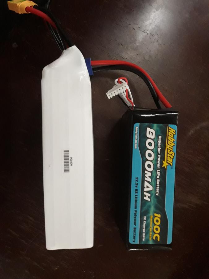

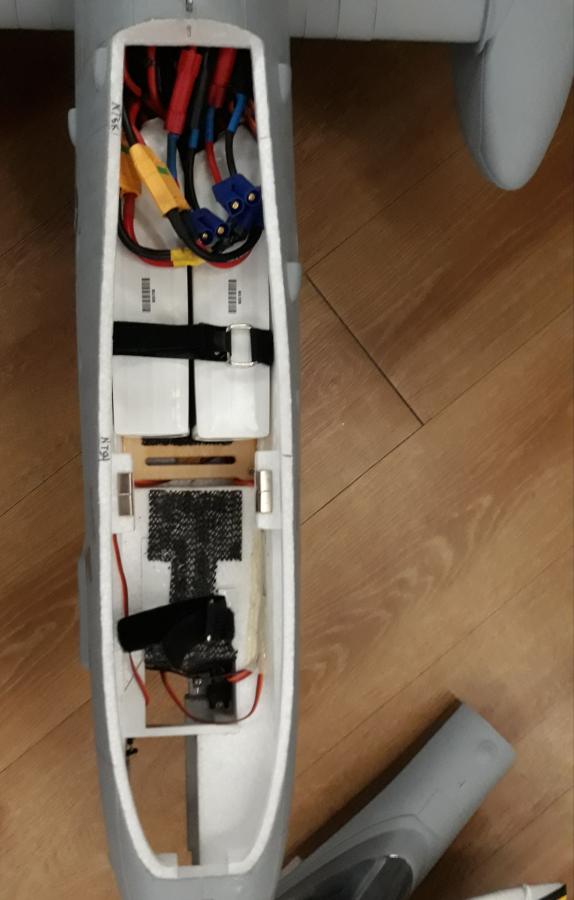

                  I’m finally a new owner of one. Good to hear how loved this plane is. I always wanted it but always ended up with other jets.
                  The struts are on the upgraded parts list. Many people dislike the stock suspension. Mainly because it’s like landing on a trampoline. I bought the trailing link nose gear. Hopefully I won’t regret it...
                  I have looked through this thread and the other, for the A-10 and F-14, but it’s not mentioned a lot... I have 2x HobbyStar 8000mah lipos. Has anyone run both ESCs off the same, single lipo in parallel? Like the twin 70mm SU-35? I know that the main connection is going to be super hot, but I know it’s possible. Flying time won’t be the best, but the lipos weight around 1100g. So it would be like running 2x 4000’s...
                  thoughts would be appreciated....

                                I haven't tried running both motors off one lipo, but I also have 2 of the hobbystar 8000mah 6s batteries and I fly them together in this bird. She doesn't seem to mind the wait at all, still has plenty of vertical, and to be honest, with the extra weight I get the sweetest landings. I run those and 2 CNHL 6000mah 70c 6c batteries, the CNHL's are bricks, larger and heavier than the hobbystar's. I assume that I see very little degradation in flight performance partially due to where I place them in the fuselage.

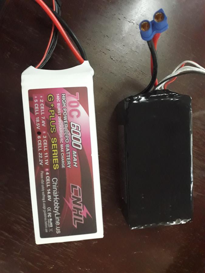

                                  YES!! I knew I would see them around! I have 2x (2S) and 2x (4S) actually. I kinda bought them on a whim. Everyone was raving about the weight savings and performance, but no one had the 8000's that I've seen. I bought them mainly to use with a 8S JetFan setup in the F-22, But bought a combination to use them in my other EDFs as 6S.
                                  How do they perform overall? I mean, obviously they aren't 100c, but I kinda took a chance on them. Also, What's the flight time with both? I bet the plane would be a lot of fun for a short flight running a single lipo paralleled to act as the lightest twin 4000mah setup ever. I fly off a golf course fairway which is surprisingly bumpier than you would expect. Cant complain though... its a one minute golf cart ride away. I just set the nose of my planes ( usually nosecone off) on my left foot and hold them out the side of the golf cart until I get to the best area.
                                  I will video the maiden. Could be entertaining...

                                    Well if they aren't a 100c rated you can't tell by the performance. I've only got a few cycles on the second 8000mah 6s. I bought the first one to fly it in my 90mm Venom and I can easily get 6 minute flight times in it with 40% battery capacity left. I had to wait a few months until they were back in stock to pick up a second, so I've only got a few flights on my A-10, based on the Venom trend I've been using 6 minutes, I land with 37 to 45% capacity left. There is no lack of power delivery, and I'm extremely happy with the battery's capacity verses weight. It's a 140 dollar battery but if it gives me 200 plus cycles I'd be very happy with it, love it so far.

                                      I was messing around a bit about the C rating... I bought them too haha. I bought the two, 2S 7.4v packs as the hardcase versions. Prior to their release without the casing. Then I removed the casings and used my own shrink wrap. You can’t even tell they’re not the air versions. They’ve been cycled about 5 times on the charger, I can’t wait to get them in the air.
