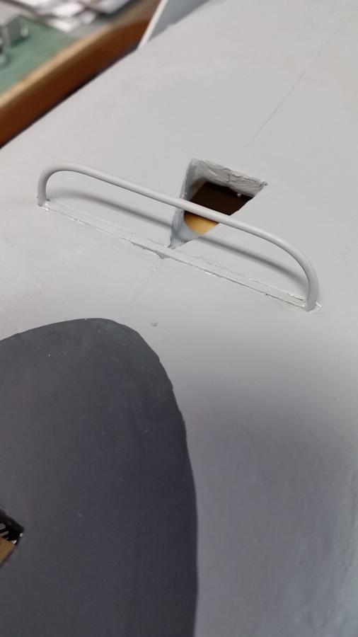

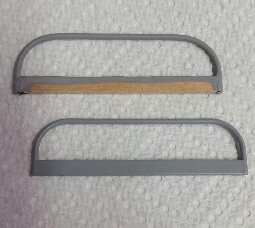

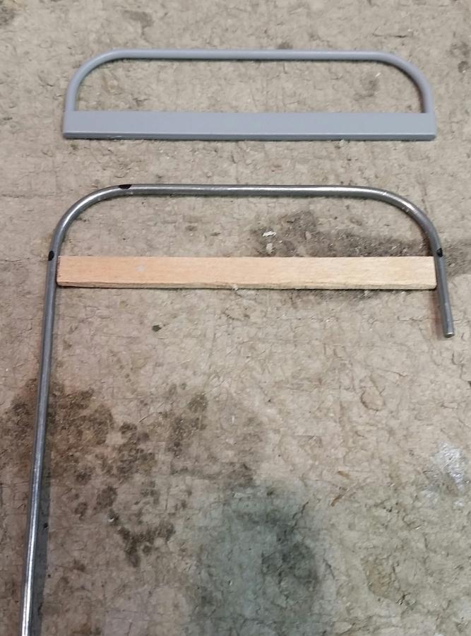

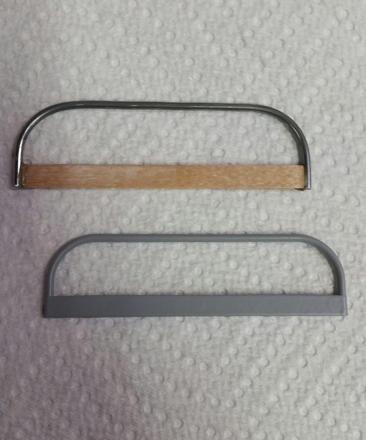

                                        Boy, not much being posted here lately. I guess its building season.... or "fixin' season"....
                                        Hey, I know that I'm not the only one who has had this problem - the little plastic antenna on the bottom (under the cockpit area) breaks right off if you look at it too hard.
                                        So I was looking at that thing and I said to myself, I can bend a metal wire into that shape and make my own.
                                        So I bent a piece of wire (it was a 2-56 rod) and epoxied it to a piece of popsicle stick. Cut off the ends with a Dremel...
                                        Then I painted it... and installed it. Here are the pics with it posing next to the replacement part that I paid for. This took me about 20 minutes. (listen to this guy brag!) No I won't make you one.:tired_face:

                                          Nice fix there Mudduck! Happened to mine the first transport. Definitely going to go this route.
