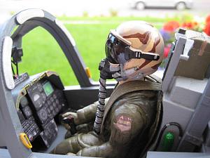

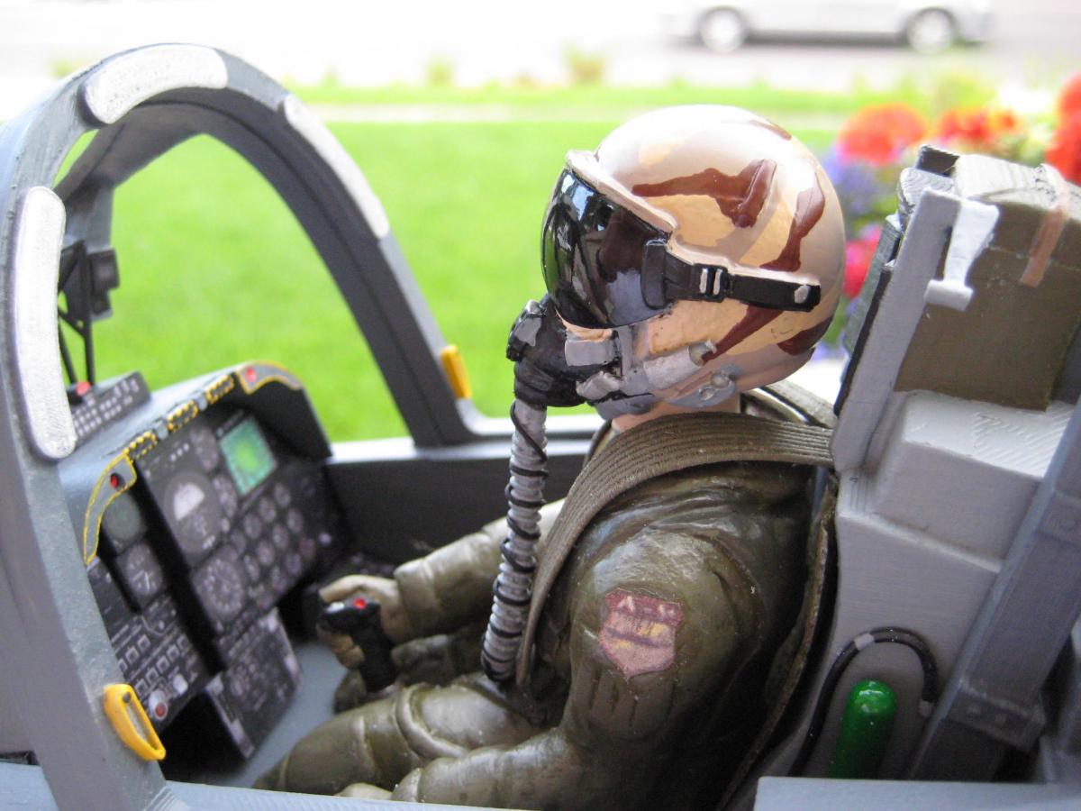

              WH, if you're writing about the JHH Pilots, I hear ya. I've washed those in soapy water and even solvent and whatever it is, acrylics don't stick well and enamels rub off. I now spray a black automotive primer from Krylon (Home Depot) and then use acrylic and/or enamel paints. Best, LB

                Elbee is right, for resins like these, use proper primer after a thorough cleaning (soapy water and toothbrush). I rinse and scrub the figure in water water afterward to ensure all the mold release is completely removed from every nook and cranny. Enamel primers are best.

                  Thank you both! I thought I was losing it. I even tried wiping it down with lacquer thinner, after soap and water didn't work. I tried wiping with acrylic airbrush thinner. No go.

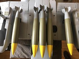

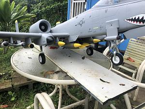

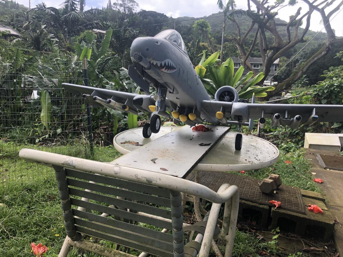

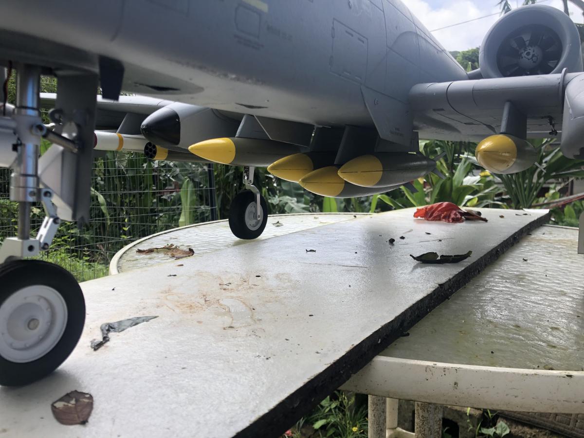

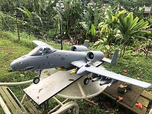

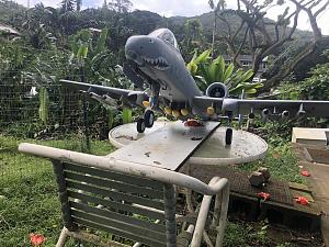

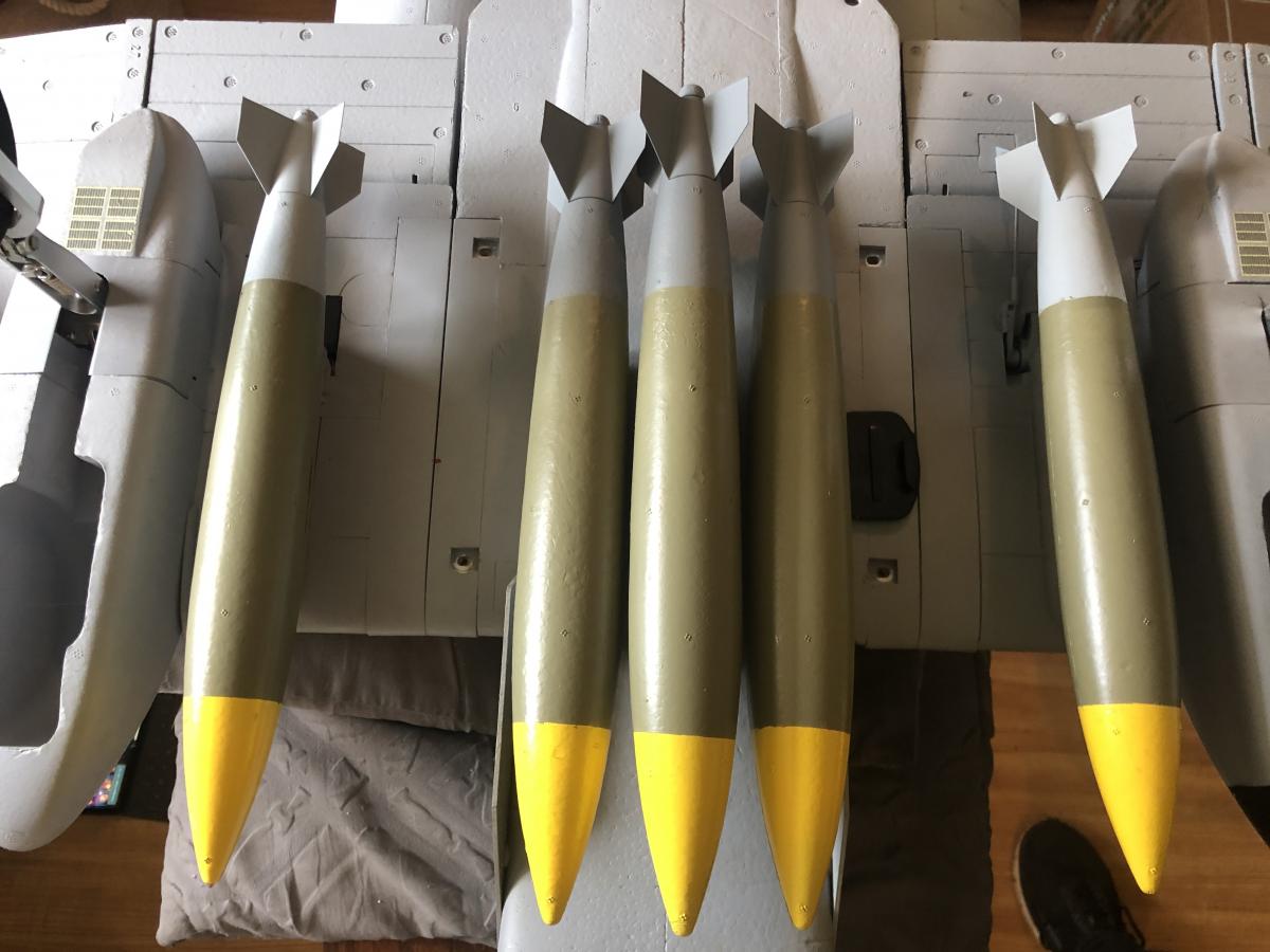

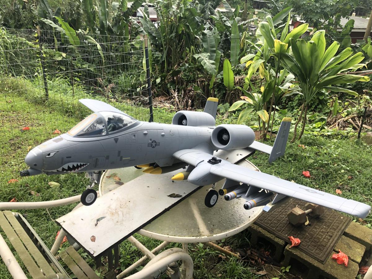

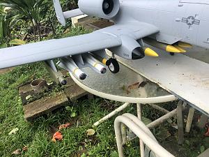

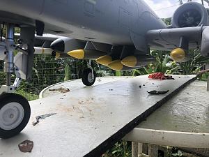

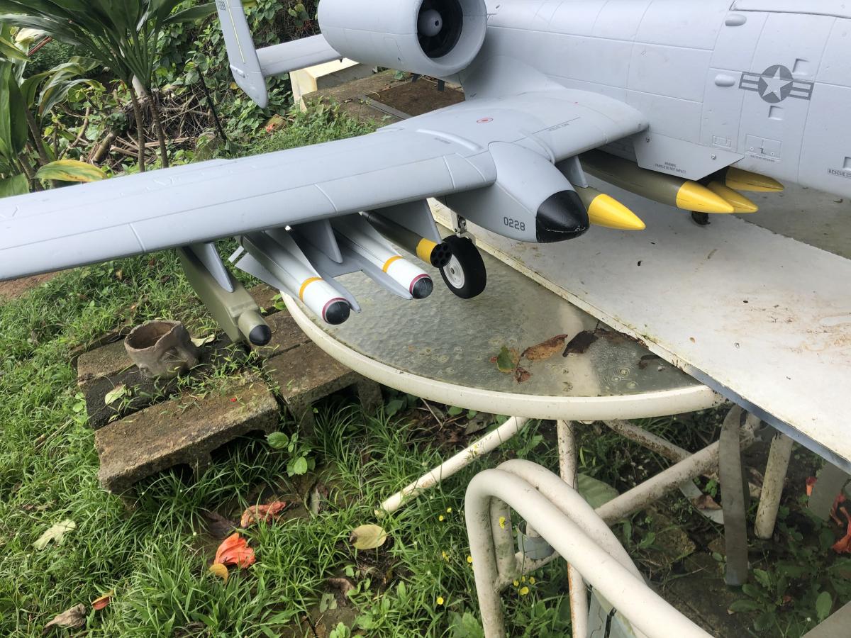

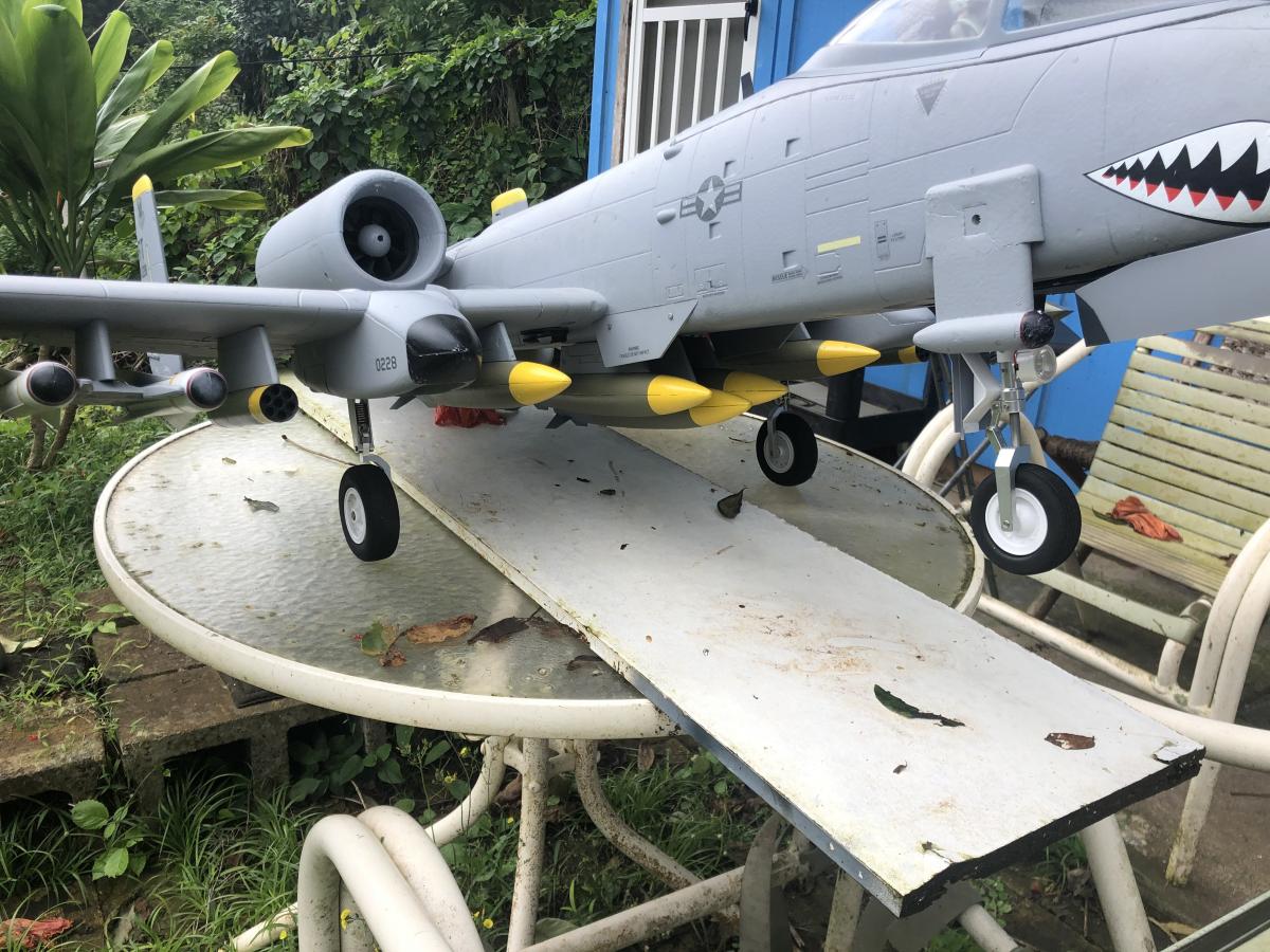

ID:	245520 Thank you very much to gravity-tester! Was able to change up my ords little bit🤙🏽

                      I cleaned up the bad paint, and found some plastic primer. It went great!! Almost done with detail painting. Thanks to you both for your help. John

                          Glad you could put them to good use, Casey. That is one mean looking Hog! Now you just need a few rounds of 30mm combat mix and you're ready for battle.

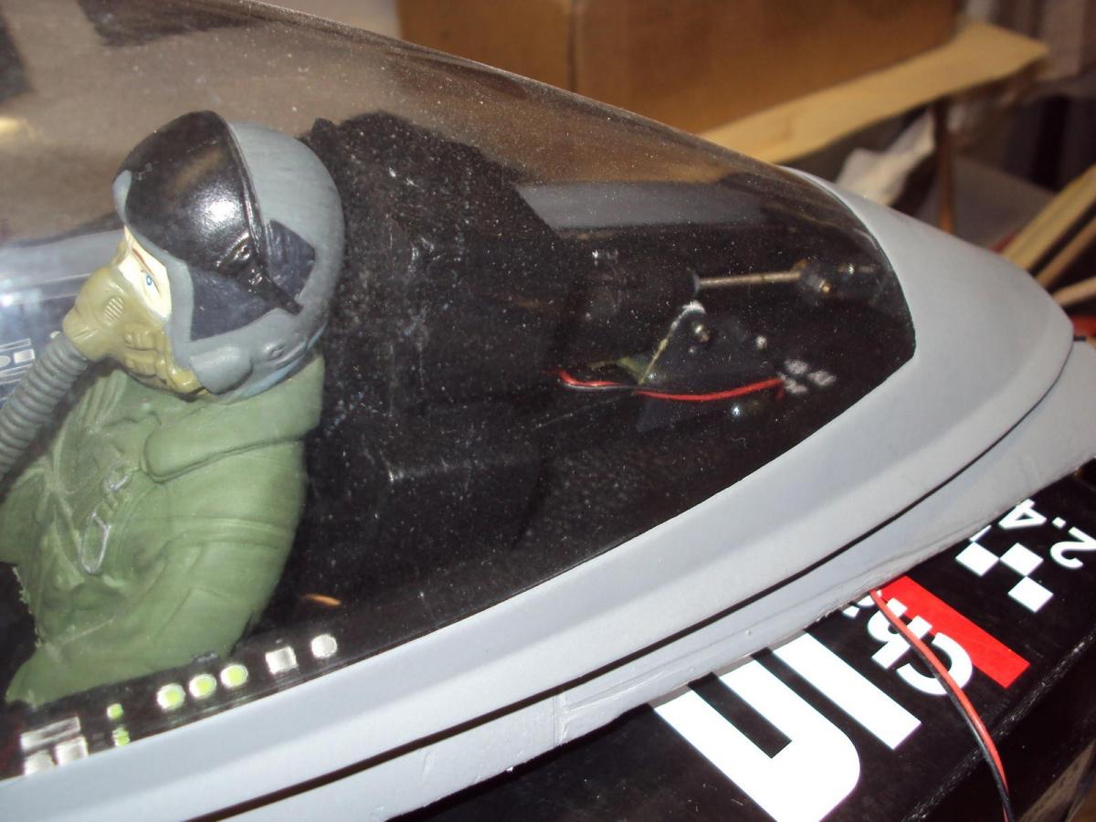

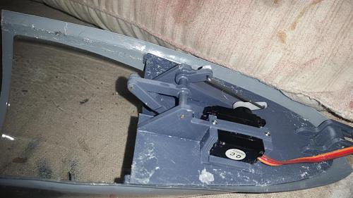

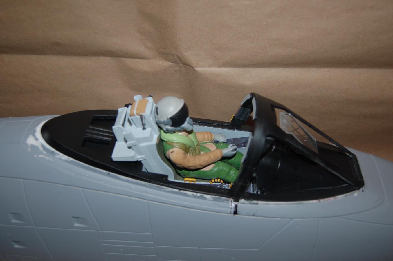

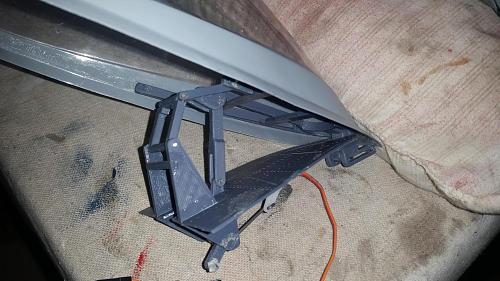

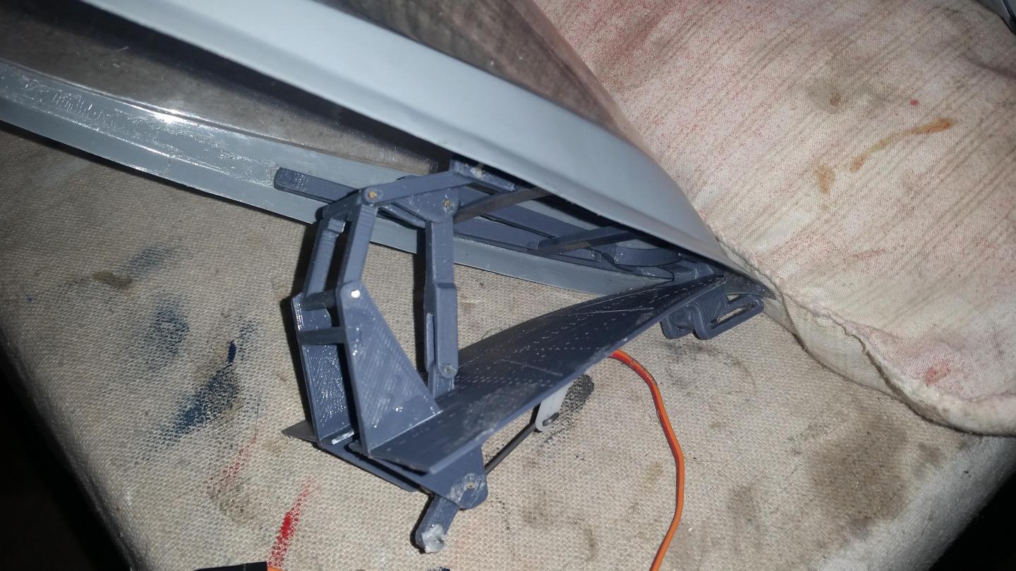

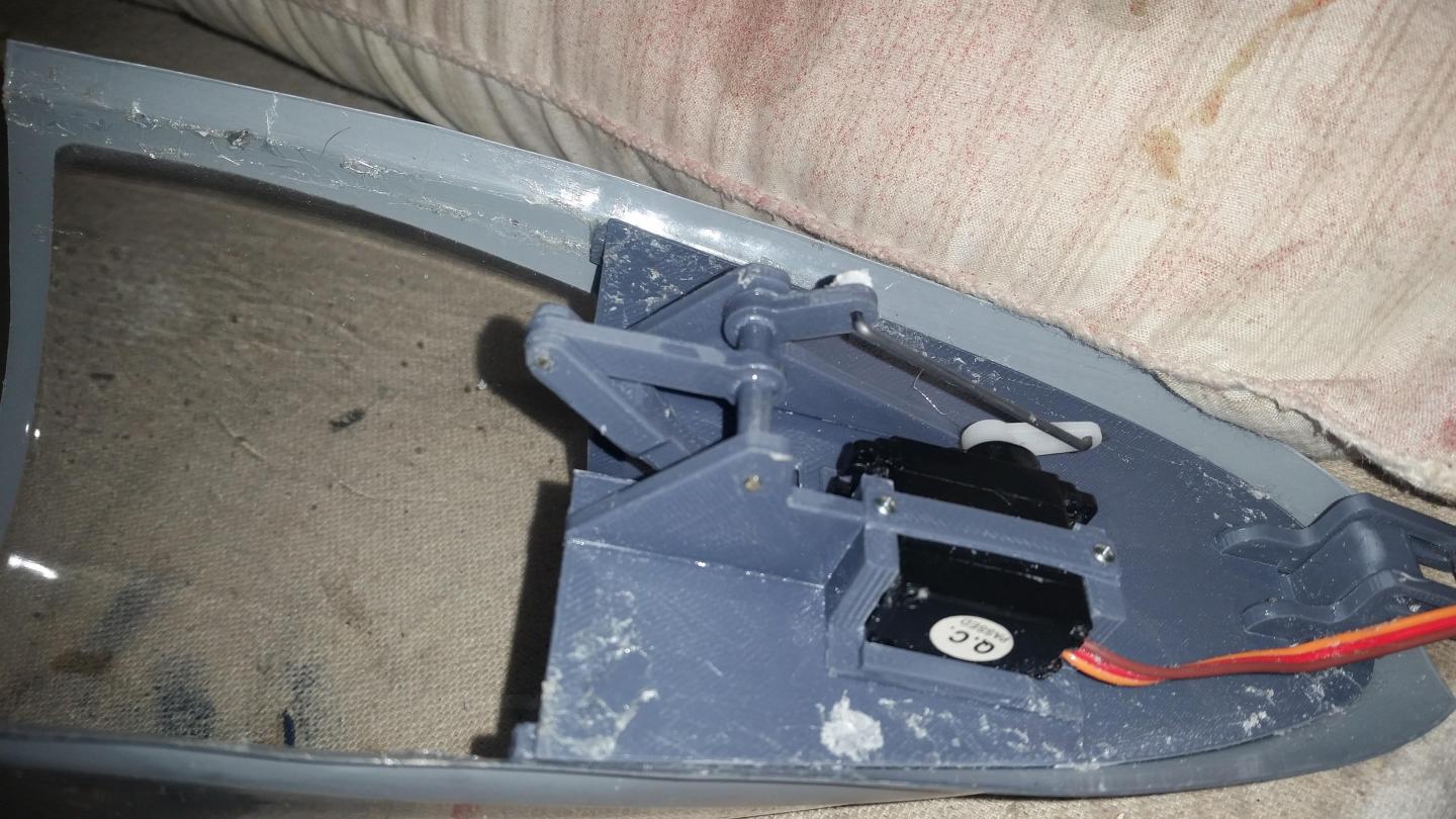

                              Can anyone recall when the attached pic of a Canopy operating mechanism was posted? Additionally, can this item be purchased? I appreciate any info on this interesting subject Click image for larger version

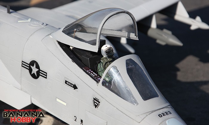

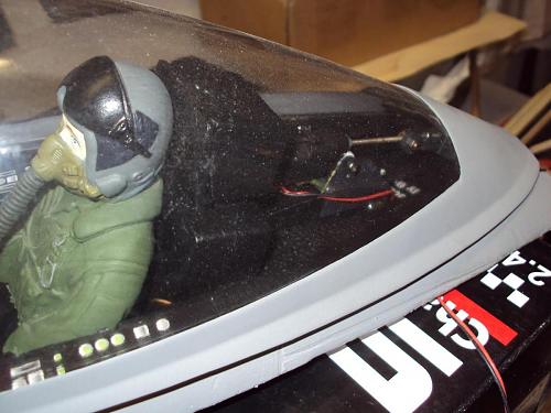

                                I can't remember exactly when, where and by whom that canopy opening mechanism was posted, but I had the LX A-10 that had this feature in the stock plane. Banana hobby sells that A-10 under their brand "BlitzRCWorks". Here is a picture of that canopy open:
                                Banana also sells the mechanism: https://www.bananahobby.com/canopy-o...1576-prd1.html
                                You may be able to adapt it to this A-10. The other option is to invent your own based on what you've seen.

                                  WM, the only person I recall that had a video of an operating canopy was RCjetdude and Pogo. I believe those were both scratch-built. It would be very early in this thread say Fall of 2017. Hope this helps. Best, LB

                                    The operating canopy looks professionally built. Very simple unit, and easily adaptable. Looks like a job for DD.

                                      I think that mechanism shown is from the LX A-10 and I considered using it but decided adapting it would be as much work as making a more scale scratch built version. I scaled up parts from a Tamiya plastic model I have and fortunately it pretty much worked out the first time. Getting the geometry right with things like this is always challenging and of course "the devil is in the details". I wish I had .stl files to share for the parts but everything is made from wood, plastic etc. so...
                                      Here's the video first posted in 2017 showing the canopy gong up and down, up and down, up and......

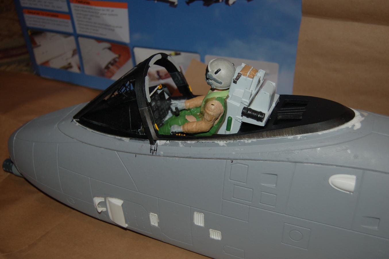

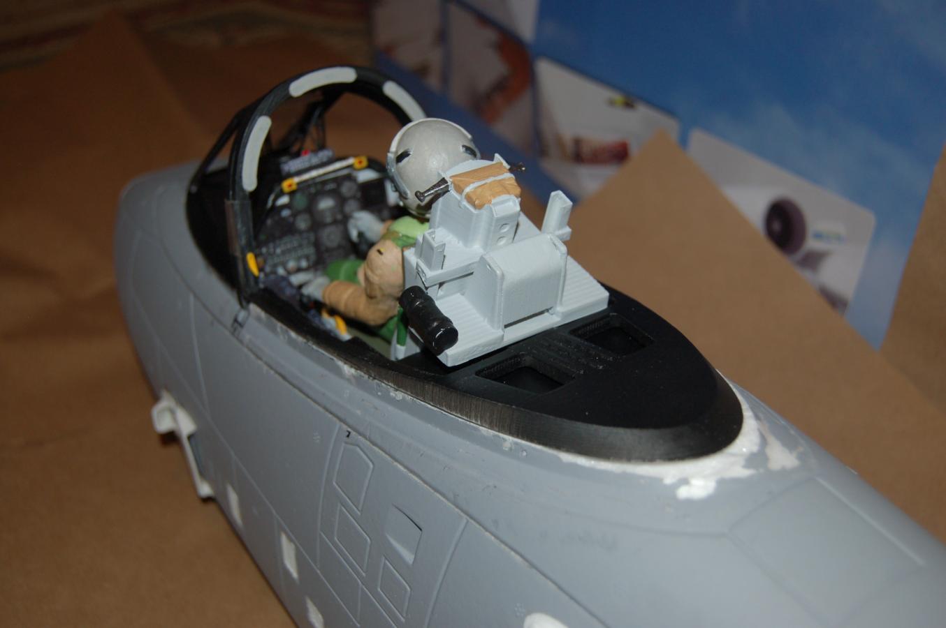

                                        The LX used a jack screw and was junk. Been there done that.
                                        Mike.

                                          Me, too. After looking at it out of the package, I labeled it and tossed it into my parts box, never to be seen again (until I threw out the box). It was, however, the only "manufactured" mechanism of its sort at the time.
