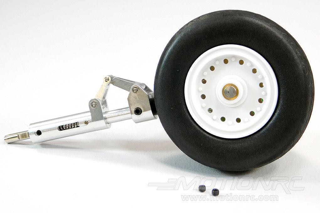

                    #10029
                    Looking for info on the main strut upgrade version. What is the length from top of strut to the axle??
