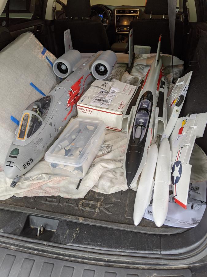

                      Well I went on a little field trip today and picked up a couple of nice used jets! I have some spektrum 30c 5000mAh batteries that I bought for my carbon t-28, but I'm assuming those will not work for this big fat warthog? How about the 2 pack of HRB 50c 5000's on Amazon for 150, would those be good?

                        Congrats! Those jets look amazing.
                        Many of us fly the Hog on 5000mah 6S LiPo's. Test their fitment and test CG with them before purchasing some different LiPo's.

                          Thanks! I was mostly worried the spektrum 30c's wouldn't be able to handle the hog's amp draw.

                            For a 5000mah 6S 30C, that Spektrum LiPo are VERY light (specs. list it as 655g) batteries, and are as light as some 4000mah 6S LiPo's (for example, the Admiral 6S 4000mah Pro is close to that weight). As great as that sounds, sometimes (not always) that means they may not potentially be as effective at holding sufficient voltage under load as a more robust battery would. I would take the 30C rating with a grain of salt, so to speak, as you can often count on it being much less than labeled. So, it is possible they may experience a bit higher temps., less power, etc. during flight. However, the A-10 has been flown on 4000mah 6S LiPo's many times before on the stock power system, and the system does not draw what I would consider to be high current. With that said, your Spektrum LiPo's may be adequate for this airframe if they are healthy. Test the LiPo's pre-flight, as well as keep the maiden flight mellow and then check the batteries post-flight to see if they are too warm to the touch, check cell voltage and balance, etc. The rather extreme summer outside temperatures aren't exactly going to help either, ha-ha.
                            Just for examples sake, and more of a worst case scanerio, what if the battery had a true 15-20C (we have no idea what it really has, so this is purely an example, and maybe Spektrum does have a true labeled rating) discharge capability, then a 5000mah battery would potentially have a 75C-100A continuous discharge capability. The stock power system (for each side) isn't terribly far from that current on the low end. Obviously, it is beneficial to have adequate headroom regarding battery discharge capability instead of the bare minimum, especially when used with EDF jets. You may find it worth it to see if those specific LiPo's are up to the task when used with the A-10.
                            According to the test that was performed by a member on the RCg forum, he tested the Spektrum 6S 5000mah 100C LiPo at true 29C continuous discharge rating. Now, the Spektrum 100C version of that LiPo weighs roughly 725g supposedly, so the 30C version weighs almost 75g less than that, which I why I said it is unlikely that it will have "True" 30C discharge rating.
