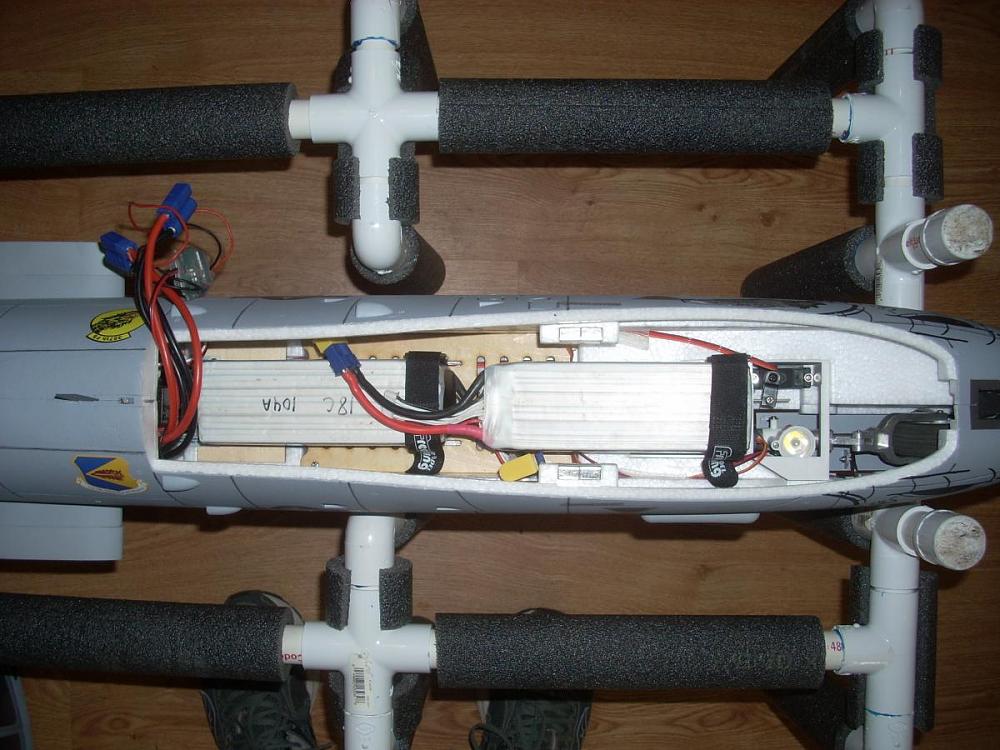

                                  These are RoaringTop 5800's. Canopy fits just fine with them in. The RT's are slightly slimmer and longer than most other similar size packs. I'll even toss 6250's in there occasionally and they fit fine too.
