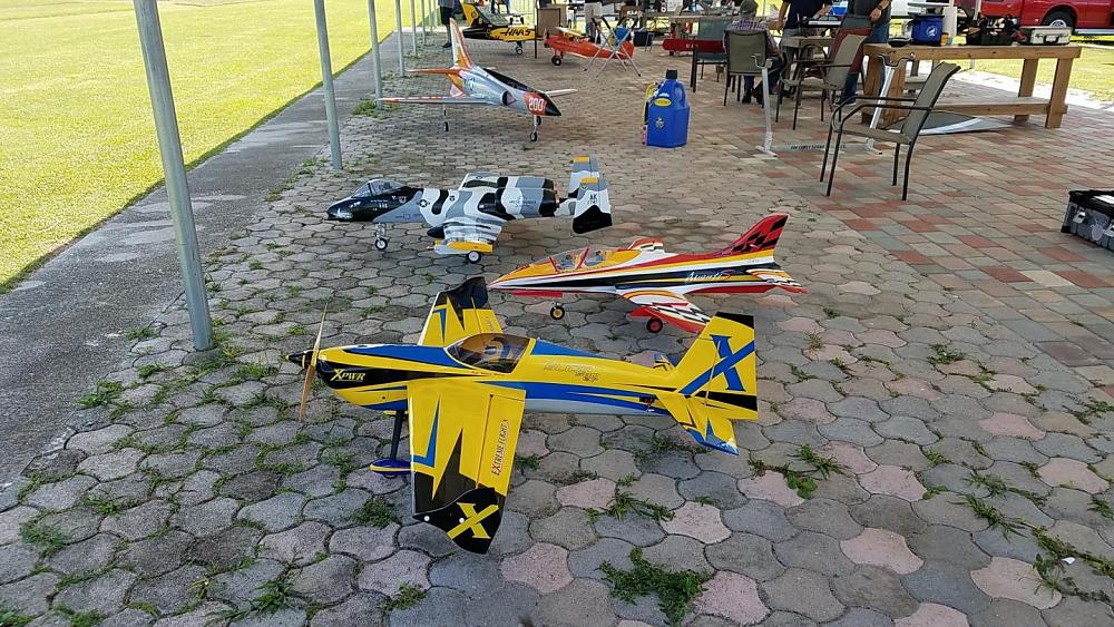

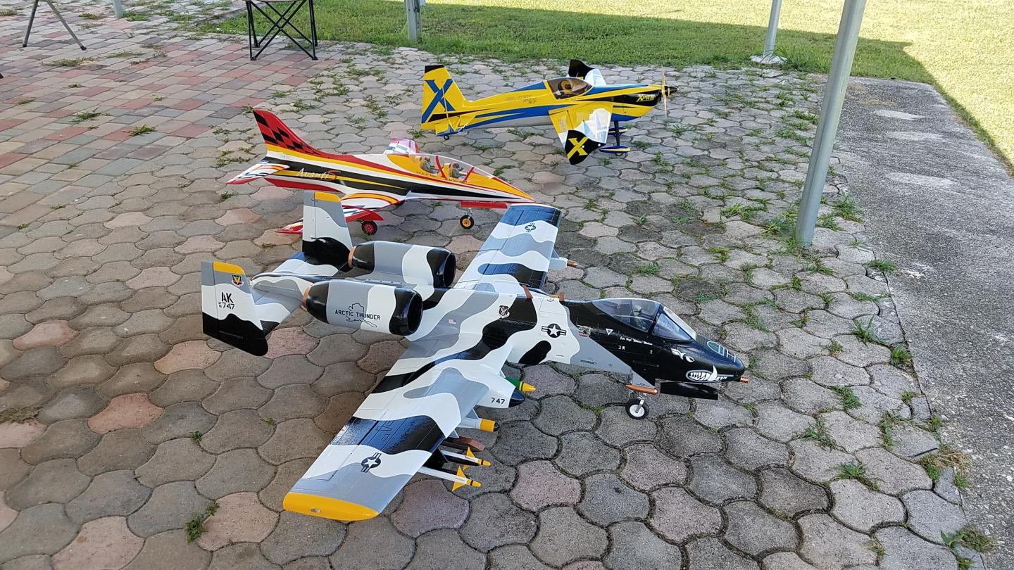

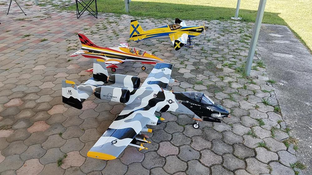

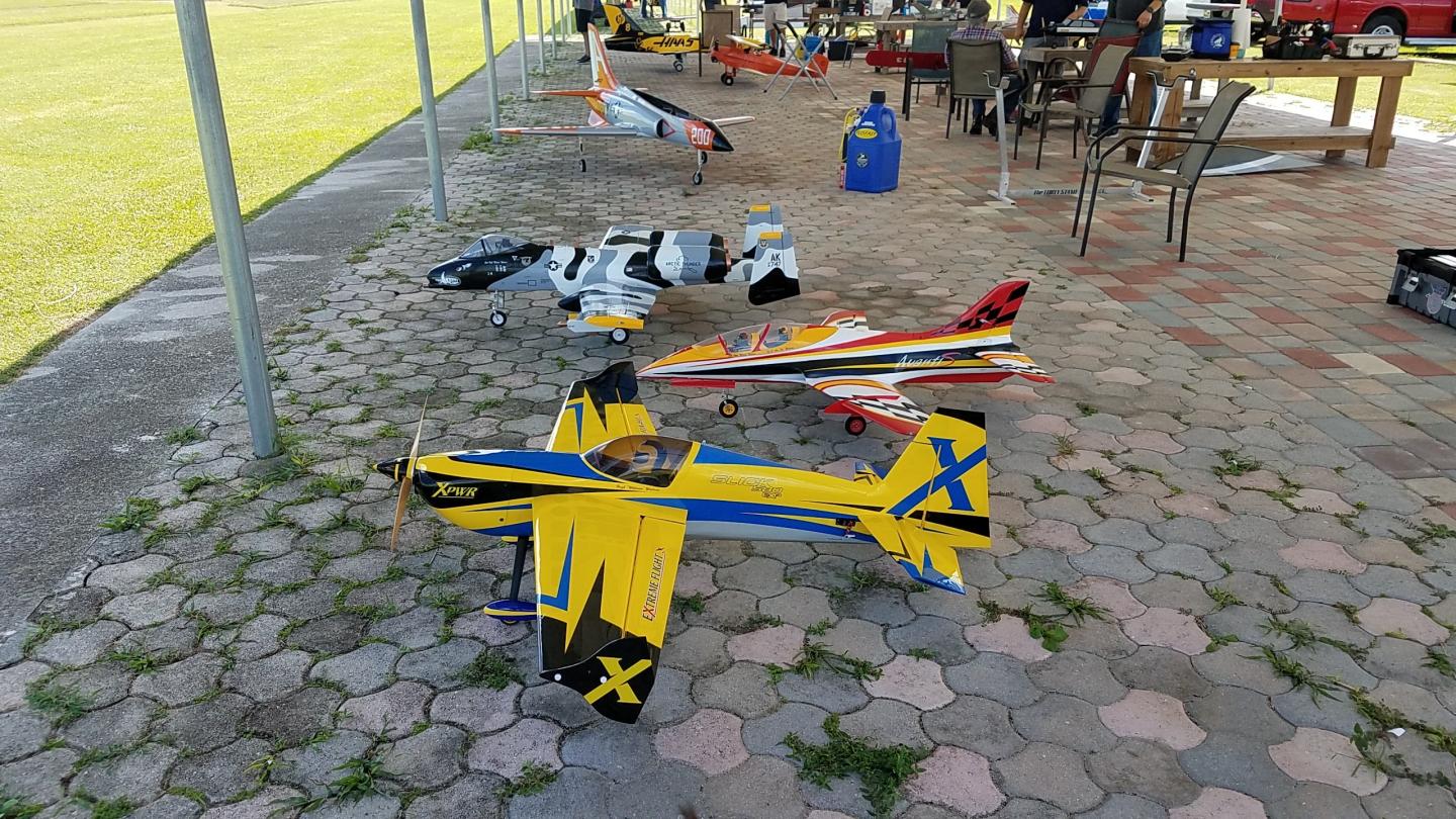

              #10586
              Already posted in What did you Fly, but was able to get out today and put another 5 flights on the A-10 along with the same number on the Avanti and one of my Extreme Flight Planes. I know it's maybe too soon to say this, but the A-10 has got to be, IMO, one of the easiest EDF's to fly, actually just as easy as my Avanti, which I consider a "trainer EDF". I guess it's size just makes it incredibly stable but it's got plenty of power. Flight time has been 5 minutes on 2 RT 6250's and I'm still coming in with 40% battery left. I may get it to 6 minutes, and it's not just cruising around at half throttle. Plenty of vertical with several Cuban 8's, Spit S's and a couple of knife edges at full throttle, so I'm just completely thrilled with this airframe. So far, landing has been definitely the easiest of all my EDF's, it's slow flight ability is scary! This is now my "1st flight of the day" EDF to give me confidence on the others. The pucker factor is down to 1 (only because I would hate to have to re-paint another in the event of a mishap). My Avanti used to be that 1st jet, but now it's on the back burner because the A-10 just looks so much better doing almost all the same things!! So far I've found that the CG works well in the 90-92mm range, which makes landing just very simple. And I think it could even be a couple mm further back, so we'll see. Can't believe I waited 4 years to get one!

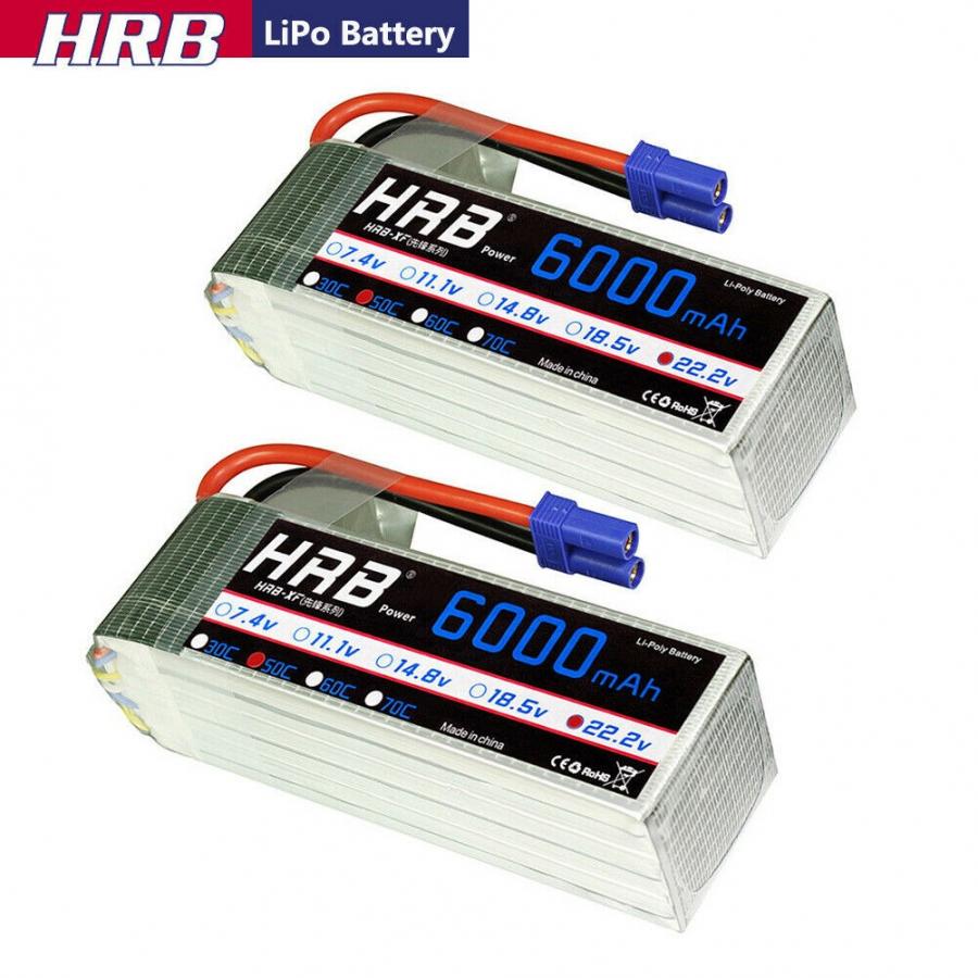

                        #10591
                        HRB 6000 ma.
