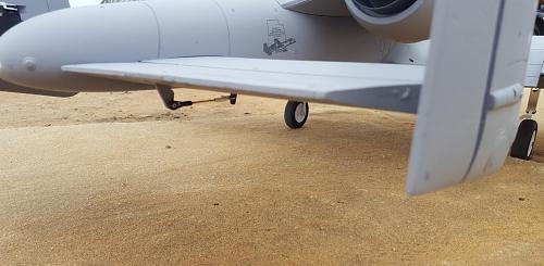

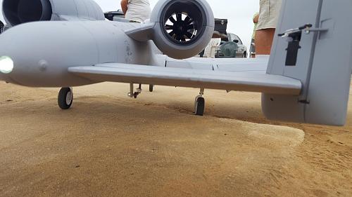

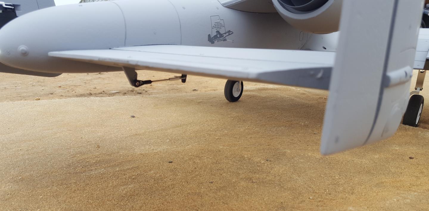

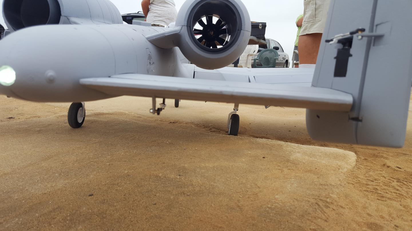

                Just finished assembly of my A-10 and waiting till spring for the maiden. I do have a few questions:
                1 - Elevator: do I need to do anything to adjust or set the angle or is the factory setting good and just set my rates from there?
                2 - Are the high/low factory rates good to start with?
                3 - Where are people getting the decals for the ordnance (not the stripes but the text nomenclature)?
                4 - the manual shows the CG way out on the wings, can I measure closer to the fuse?
                Thanks and any other tips prior to maiden please feel free to share :)

                  1 - Set up by the book (about 5mm of "up" for neutral).
                  2 - Factory rates are good, adjust to your liking after maiden.
                  3 - The ordnance decals are available from me. I still have some sets available, $5 per set. PM me and I'll give you the ordering info.
                  4 - Yes, you can measure near the fuse. The book CG of 78mm is nose heavy. Most of us have it between 85-90mm.

                      In case it helps, attached are a couple photos of balanced elevator, and I think the CG on this model is about 85mm. Also, I would recommend starting with lower throws than in the manual. A lot of Freewing/Flightline models have what I would consider high throws (at least for a maiden flight) in the manual. You can always go up if you find it too tame, but if you find it too erratic it might be your last flight.
