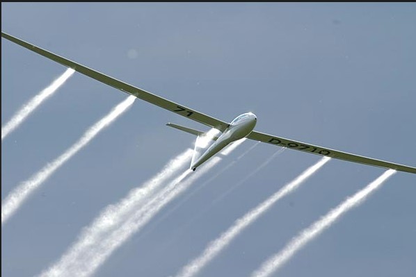

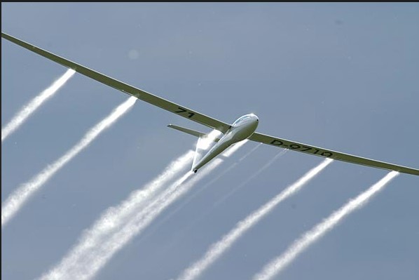

                                          Interesting note:
                                          Some full scale sailplanes have a tremendously wide weight range. Going from a take-off weight of 600 pounds to over 1300 pounds (or more) with added water ballast (to improve the glide ratio at a given high speed). But, the pilots must accept a lot of the above AND they dump the water before landing to avoid breaking the landing gear. See photo below...dumping water prior to landing. Yes, the added weight does have an impact on the climb rate in thermals, but the added boost to the glide ratio at a given high speed overcomes this slight decrease in climb rate when the thermals are strong.
                                          Example: L/D (glide ratio) at 100 mph at 600 pounds might be 35/1. L/D at 100 mph at 1300 pounds might be 50/1...a huge difference with wing loading going from 6.5 lbs/square foot no water to over 10 pounds/square foot with water ballast.
                                          Learn more about how weight impacts glide performance (one such article...there are many!)
