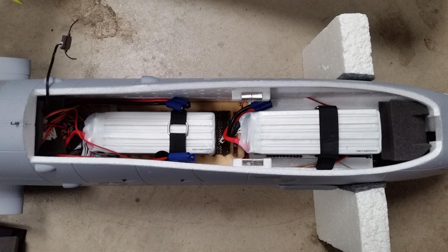

                            Hey Bazza, sorry to hear of this incident. Something was definitely wrong, I can't imagine how tail-heavy it must have been to behave like that. Where did you measure 90mm from?
                            Should be about 3.5 inches back from the LE of the wing where it meets the fuselage.
                            We need more info - I would like to know where you put your batteries. Did they look like this picture?
                            Or did you have them both in the back tray?
                              Click image for larger version Name:	20171008_144033.jpg Views:	0 Size:	112.5 KB ID:	334036

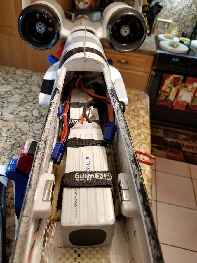

                              Damn Marc, that looks way more nose heavy compared to mine. I must be a good 120 mm further aft on the battery placement than you are. In fact I had to remove the circuit board screwed in to back end of the battery tray and stick it on the port fuselage wall just to get the batteries all the way back in. This photo has the RT 6250's each weighing 795 gr although now I'm exclusively using the SMC 6200's each weighing 814 gr pushed back even more and it definitely is not tail heavy for me. I do have the 3D printed "Dirty Dee" cockpit and a 1/10 scale JHH full body pilot in the cockpit adding a bit more weight to the nose, but I'm still around 92-95 mm on my balance point. Flies smooth as silk for me, with the gyro on or off. That front battery only has 1/8 of it on the elevated front battery tray so I had to add a platform holding the remaining 7/8's level where it steps down so it could lie flat.
                              Click image for larger version  Name:	20210328_184930.jpg Views:	0 Size:	98.2 KB ID:	334052

                                #11015
                                Damn Marc, that looks way more nose heavy compared to mine. I must be a good 120 mm further aft on the battery placement than you are....
                                Yes I know, that pic I posted was the initial setup I had two years ago, per the manual, before we learned. Now I have my batteries sitting very similar to the way yours looks. But from Bazza's description of what happened it made me wonder if he had anything in the front compartment.... because it sounded like his plane was extremely nose heavy. I'm curious where he placed his batteries.
