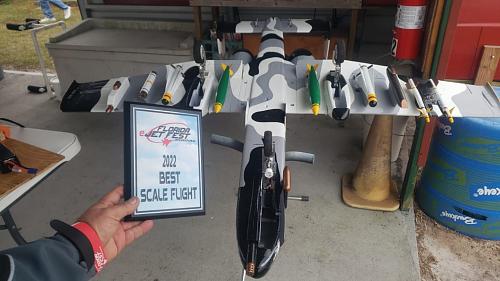

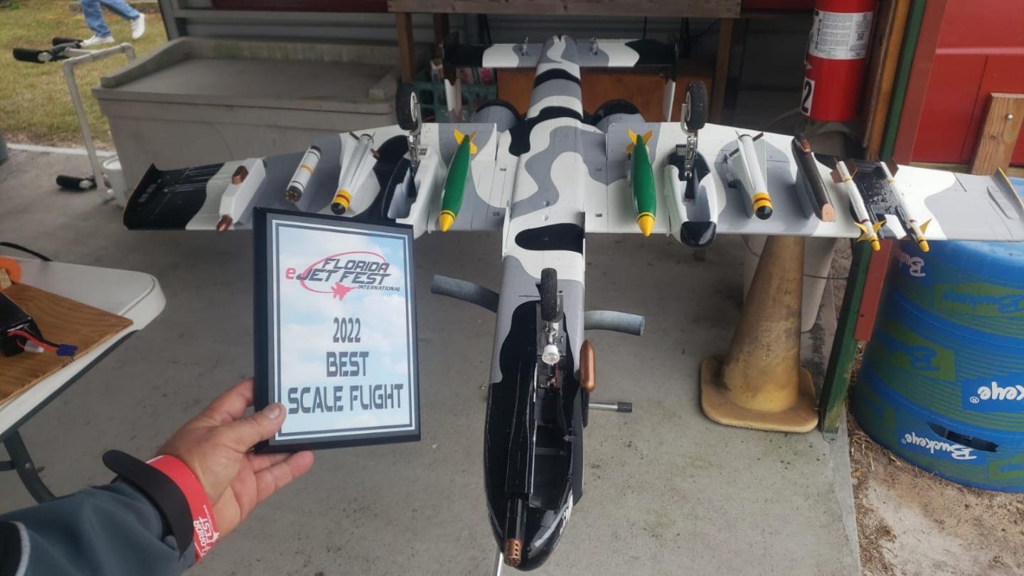

                      I agree with xviper and Evan D. I upgraded my A-10 with the same 80mm inrunners that I took out of my Mig 29 as I upgraded that with the FMS 80mm 12 blade 2100Kv motors, which added about 25% more thrust to the Mig. The Mig fans in the A-10 added about 20% more thrust than the stock A-10 outrunners and I agree, the vertical is so much better and the inrunners are certainly more efficient. I did notice a shorter take-off distance at least on grass. Regarding the batteries, definitely go to the SMC's either the 5300's or the 6200's which is what I use. Those will give you probably about 15% more thrust at take-off over the hugely over rated Spectrum batteries. I fly my A-10 on the 6200's for a minimum of 5 minutes and if I fly it nice and scale like, up to 7-8 minutes. I do have in-flight pack voltage telemetry so although my timer is set at 6:00, I usually begin my landing sequence when it tells me I'm approaching 21.7 volts.
                      Regarding the 90mm upgrade, a friend did that to his but obviously it depends on the fan you put in. He used the FMS fans and I have to say it's a rocket ship. Takes off on grass in almost half the distance and there is no end to the vertical. It's actually way too fast for my liking (as I watch the decals peel off), just doesn't really look like an A-10. I've tried to fly mine with him, and with the upgraded fans it's sort of close, but I whole heartedly agree that the 90mm upgrade is definitely over kill, but the Mig fans in it are sweet!! Probably the easiest and most fun EDF I have to fly. An excellent pilot flew mine at the Lakeland E-Jet Fest this year and won "Best Scale Flight" with it, something I could never do!
