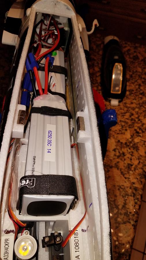

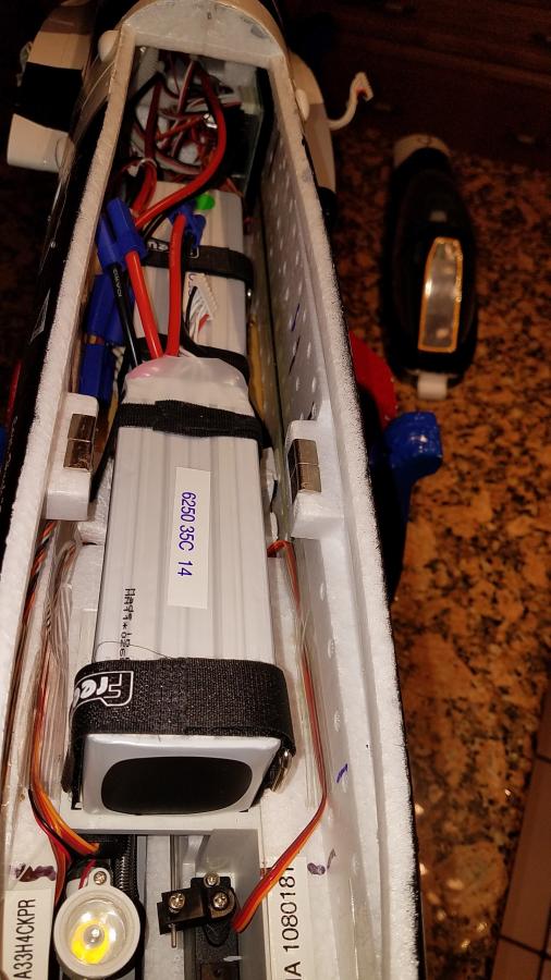

                Thanks for the info! I flew it on two roaring top 5,000 mah packs, one on the lower tray and one on the upper. They were pretty close to the edge of each tray to get the CG around 90mm.

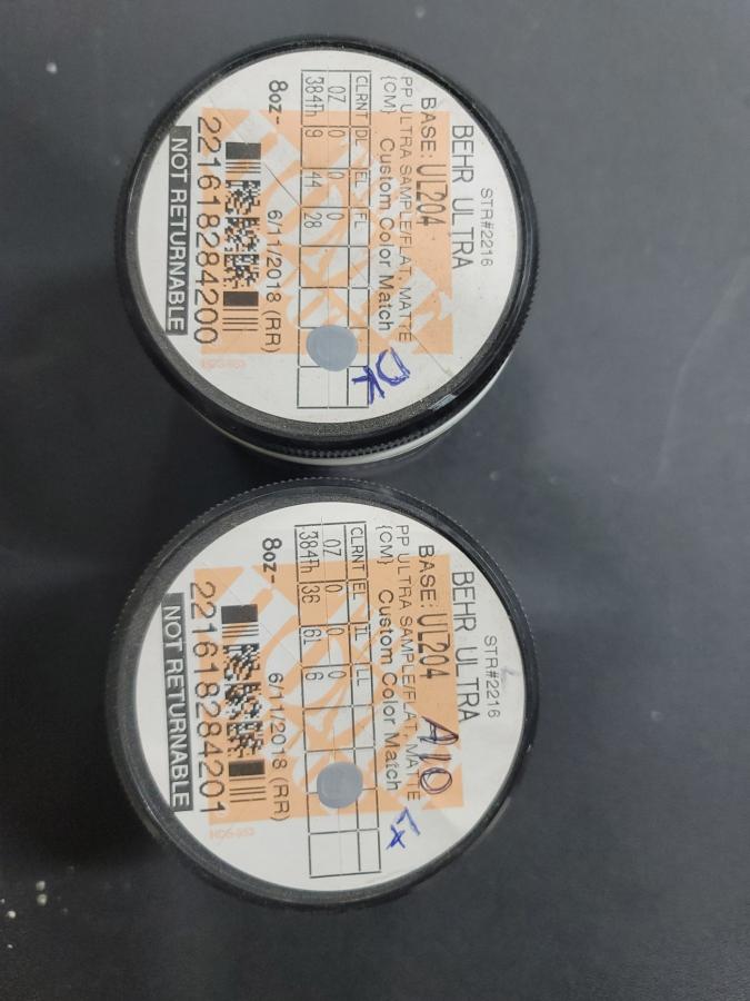

                        This is what I got from my local Home Depot. Matches pretty good.

                          Hi all, many thanks for the answers. I got in touch with motion RC here Europe and they confirmed freewing is not sharing the paint code at this stage. The advise was to find an hardware store that can scan a part an produce color accordingly. I’ll give a try to Revell 076 Matt to start with. Cheers. Manu

                                          I have recently purchased the Freewing A10 80mm and currently have 2 x Admiral 6000mAh batteries installed in tandem in the nose compartment under the canopy. From a particular video posted by Motion Rc, The A10 has been flown in the same configuration and it was stated that they maintained the same CG (78mm from leading edge as the manual recommends).
                                          My question is: was any weight added to the tail in order to compensate for the nose heavy situation as from what I calculated it needs approximately 130 grams on the tail to balance the aircraft at the recommended CG point. Or putting an adjustment of UP elevator (as recommended in the manual) is enough to compensate the nose heavy situation.
                                          Thanks
