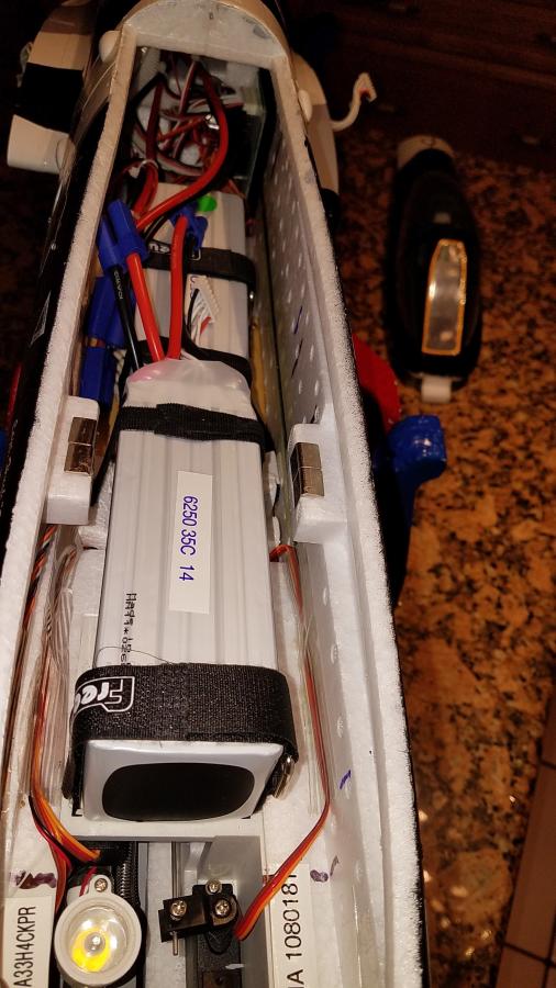

        Hi All, Just finishing mine up, hope to maiden it soon. I will be using 5000 mah packs. Wondering if the plane balances okay with each pack on the trays ? I thought I had read (somewhere) that some people were relocating the Circuit Module to get it to balance ???
        Thanks. Bob

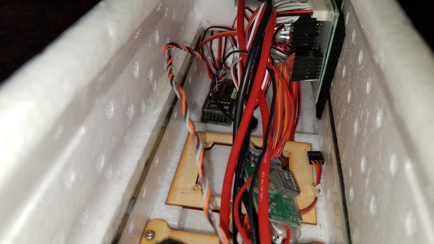

          I had to shove the board on mine as far back against the rear bulkhead so that the batteries would both fit back there.
            Thanks xviper, Did you put both batteries back there .... and not use the forward tray above the nose gear for one of the batteries ?
              #10886
              Balsa Bob I moved the board rearward. I'm using the Admiral 5000mah packs, one on each shelf. Some, that are using heavier packs, had to stack them on the rear shelf in order to get the desired CG.

                Hey Bob, place the batteries so you can balance somewhere around 90mm. The manual calls for the CG at 78mm, but IMO (and I think most others) that's way too nose heavy, making landings somewhat difficult and potentially having the nose wheel touch first and cause the "Dreaded Bucking Bronco". I found that it flies exceptional, for me anyway, around 93mm back (and that's still no where near being tail heavy, in fact, just barely nose heavy). I'm using 2 RT 6250 mah batteries (get over 5 minutes of flight time) weighing 794 gr, so just like xviper, I removed the circuit board from the back of the rear tray and stuck it on the side fuselage on the port side. The front battery is about 1/3rd hanging over the end of the front battery tray.
                Click image for larger version  Name:	20200926_152819.jpg Views:	0 Size:	76.7 KB ID:	315393Click image for larger version  Name:	20200821_162454.jpg Views:	0 Size:	105.3 KB ID:	315394

                  Yes, both batteries are back there, actually touching each other.
